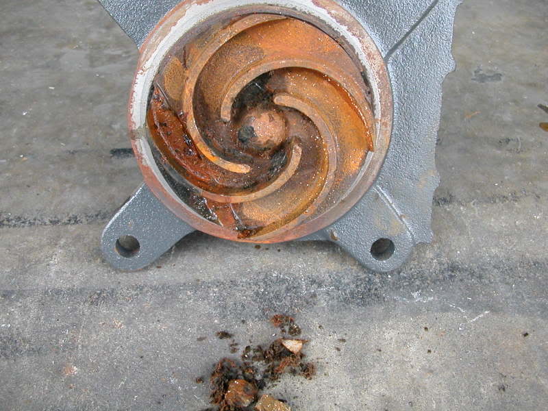

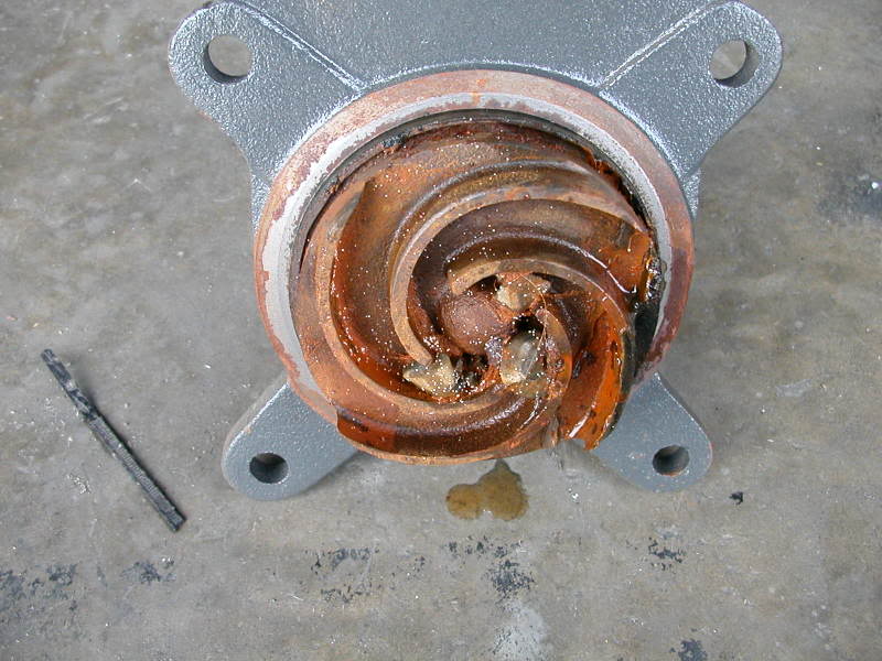

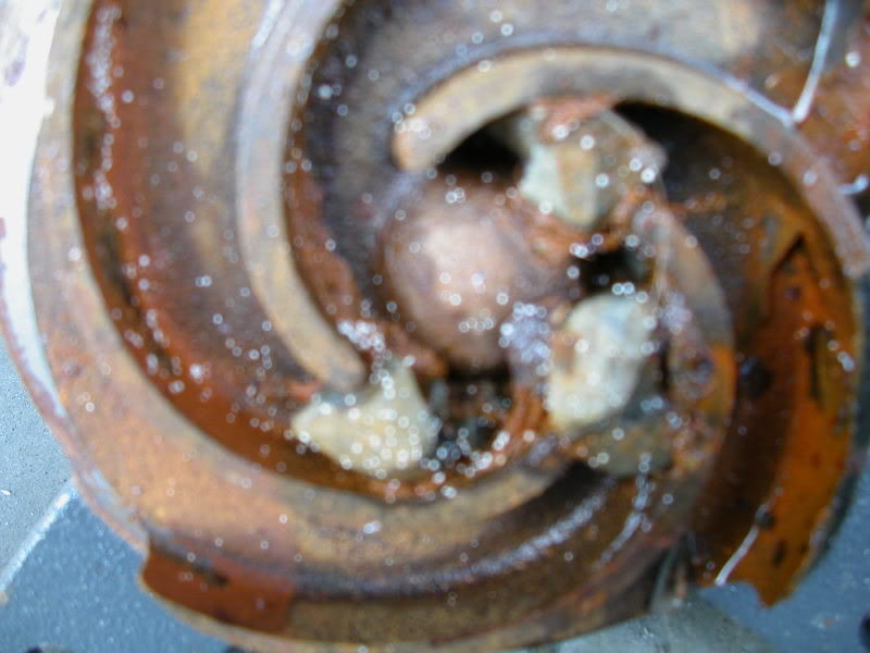

The one thing that the CP systems don't handle well is trash over 3/8" diameter through the pump. Anything that size or larger that gets through will get stuck. (Well, actually, "stringy" debris does, too, because it can wrap around the impeller.) When that happens, the pump has to be disassembled and cleaned out. The impeller has 4 "vanes", which look a lot like a pinwheel kids play with. The 4 vanes result in 4 channels. And if 1 of them gets debris stuck in it, the pump is functioning at 75% capacity, which is marginal. But the good news is that these pumps are virtually indestructible. The impeller is cast iron... not rubber.
I have a picture I took of one that the customer "swore" he always used the filter on. When we took the pump apart, we found 3 small granite pebbles, stopping up 3 of the channels between the vanes, meaning that it was working at 25% capacity. We took the pebbles out, reassembled the pump and all was well. (It turned out that that customer would pull the filter off while the system was still running, then lay the hose on the ground and walk around to the front of the system and turn it off. Somewhere along the way, the system had sucked in those pepples when no filter was connected) I'd post the picture here, but there's no provision for that, without it already being elsewhere on the Internet.
So... "Yes.", filtration is essential. If the filter is not used, the pump will stop up and have to be cleaned out. If the filter has a hole or split in it, the same thing can happen.

Done... I E-mailed you 3 of them.

Thanks, Scott...
They're shown "backwards", in terms of the order they "happen" in... The first one shows the blockage. The second shows a closeup and the third one shows the impeller cleaned out, ready for reinstall...
