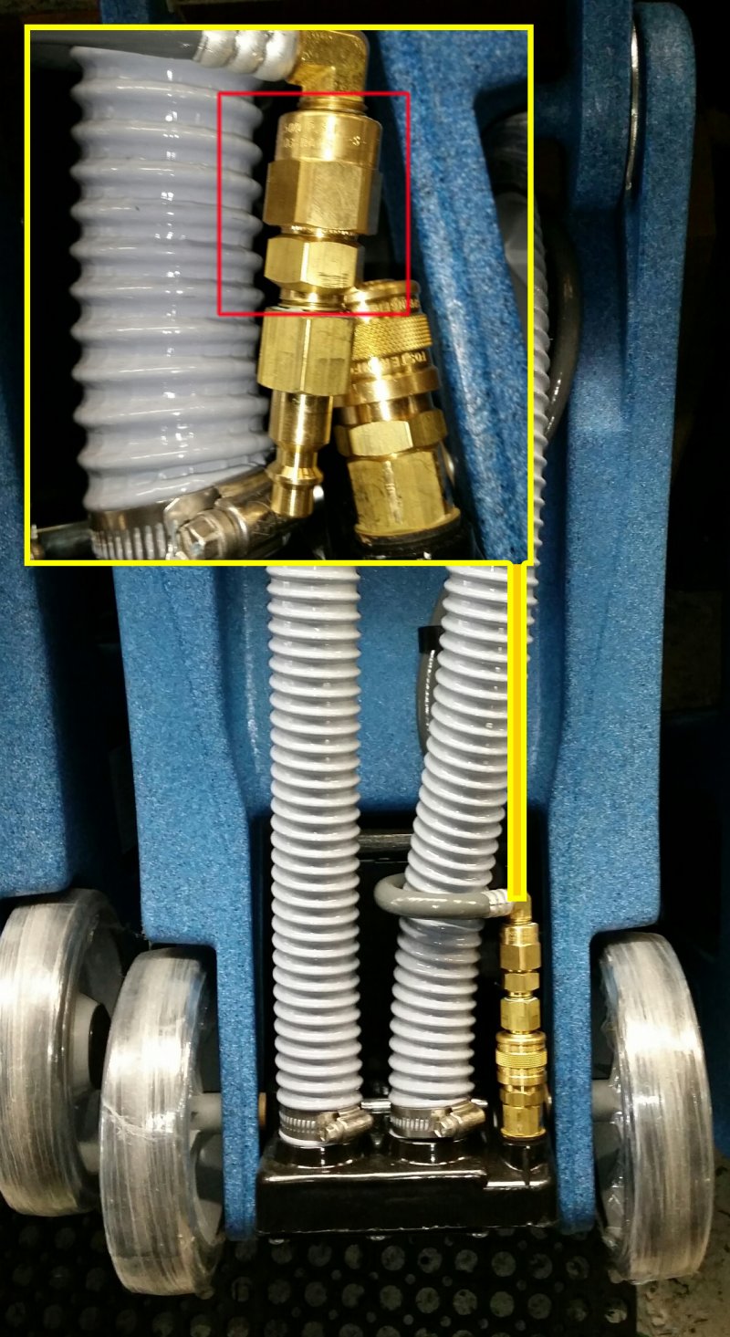

The check valve is new

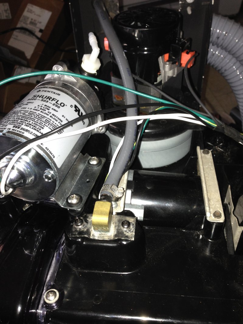

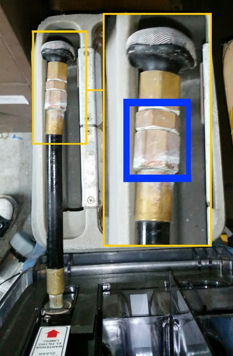

This is not new on mine
I don't have the valve in the blue box, has to be here, everything else seems fine

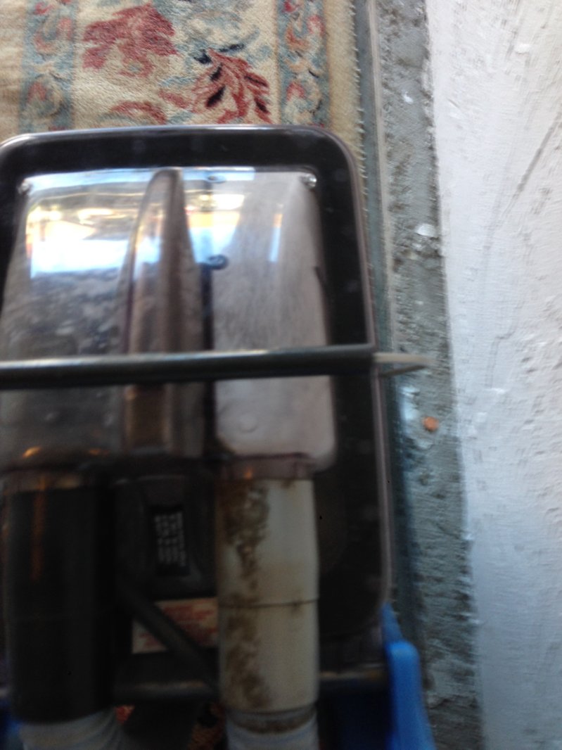

It's great suction, it lifted the carpet off the floor, the dome is not showing the waste water at much volume to another unit I have it's a new pump, I'm sure it's the feed hoses, there crap 1997.
