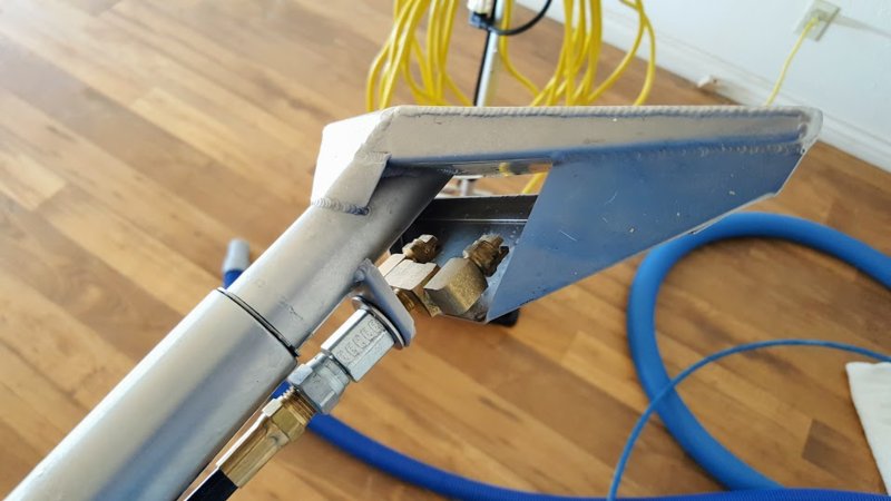

This is a Ti version made with two jets because they like me.
I used a 15" 2-1.5 tapered vac hose.
I hardly ever see stairs out here in Ranch land but I'm finally getting a hang of this thing.. I likes it!
Jimmy, youz a MORON.
No way do you need a 2" tube on this thing, It screams louder than than a stuck Marty.
Want better dry times?, do a third dry stroke.
View attachment 20020 View attachment 20021

in the video...the spacers I took out....I RECCOMEND KEEPING THEM IN.
Seemed to do better and better spray yet....
And the loose head is fine in this case I would say...easier to flip....
(and I honestly like the 1.5 inch on a stair tool as well.... :) )

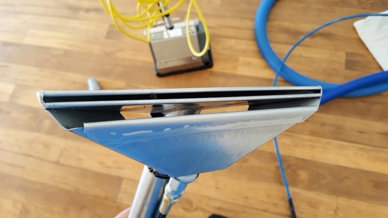

I like the splash guard Tom, it also helps keep the slot at the correct level.
The hose is an inch too short though.
I wonder if that was why I hated the swivel
