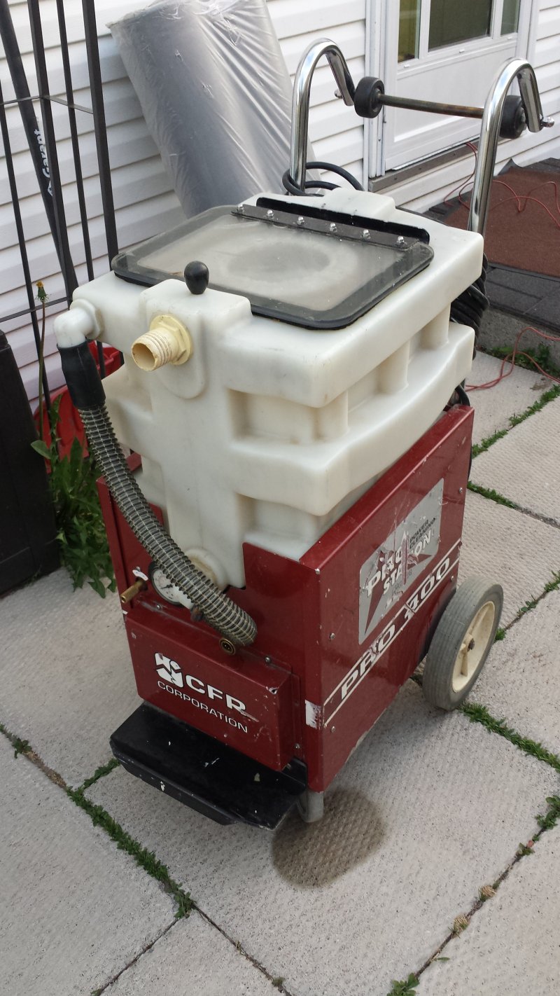

Hey everyone. I came across a CFR Pro 400 for a fairly low price. It has about 416 hours on it. It came with the wand, hose, upholstery tool.

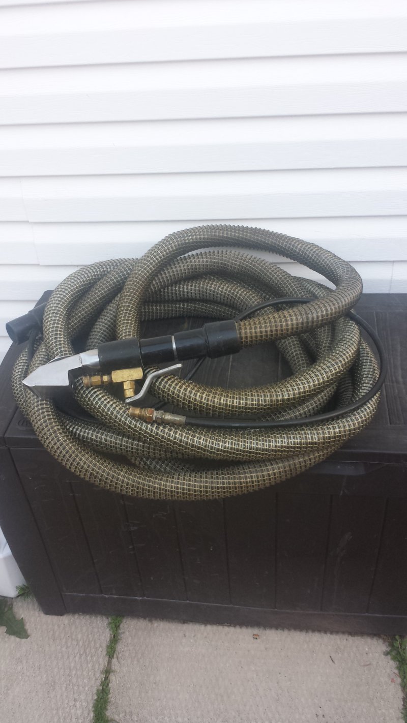

I did a quick test and it seemed to work. However Im guessing the nozzle for the hand tool was plugged as nothing much sprayed out.

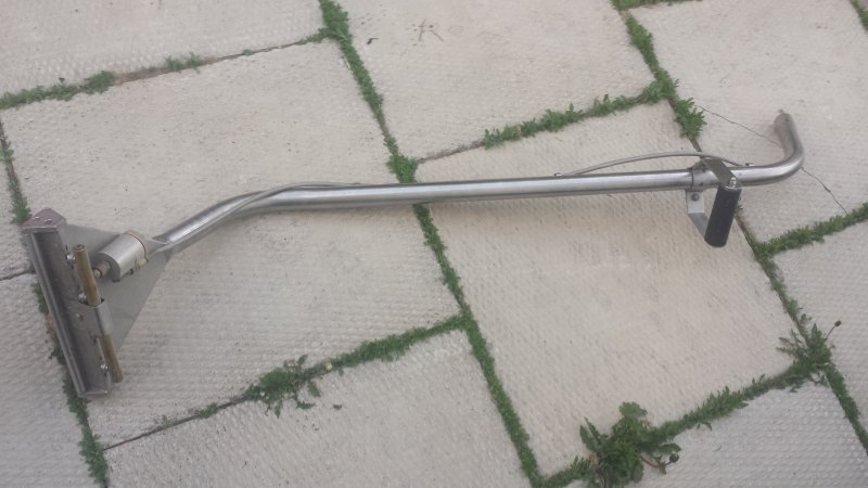

I will be testing the wand later today.

I hooked up the CFR Pro 400 to test it on the living-room center carpet... The wand sprays beautifully and the whole machine and operation seemed to work fantastically! It was a lot faster to use than a Bissel Big Green was on the same carpet. I'm very impressed with this machine, and expect to keep it maintained and running well.
I called the manufacturer before the purchase, and requested prices on the suggested replacement parts... All are available except the vacuum motor brushes, which are suggested being replaced every 700 hours. Whole motors were available for about $190 though. If I find the specifications of the brushes, I'd only imagine that somewhere, the same or similar brushes would be available?
Worst case scenario, I modify the unit to accept one of the newer CFR vacuum motors... And then maybe add a water heater.
I took a few pictures. I'm very much considering repainting the aluminum side panels to give the machine a fresh look again, and reduce some of the anachronistic look if I were to use it professionally.
I removed the spray nozzle from the hand tool, which connected to a 1/4" quick connect, that the spray nozzle thread into. I'm assuming this is a standard spray nozzle? I must have put it down somewhere and haven't located it as of this posting. It seems like the newer CFR machines tout solution "atomizing" for faster recovery, which I'm not sure if that was a feature of this older model. The wand does seem to spray a pretty fine mist though. Also, these CFR's feature a solution "recovery" setup, that filters the solution and can be reused up to 7 times or so, which seems pretty unique. I'm so far very content with this purchase.

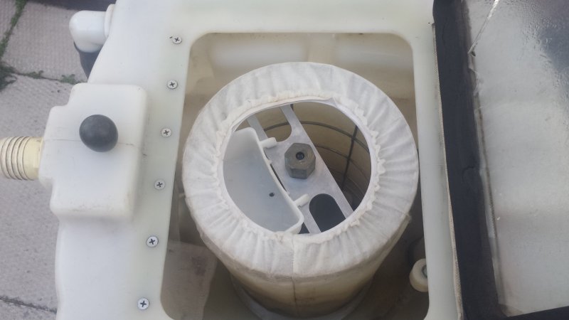

keeping extra filters on hand is key with those machines. I used to clean upholstery with one.
Thanks for the advice Danny. I think I see what you mean. I tried to clean out the tank and filters afterwards, and it was a fairly slow process (first time cleaning out tank), and not getting some of the used water, or filter debris around the work area was a challenge.
This machine was setup with that disposable light cloth filter as seen in the picture which stained up a bit. Below, there is a very fine stainless steel mesh screen that is held down tightly over a grey donut type of rubber spacer a few inches tall, with the center filter support shaft running through the center. The shaft seems to have a water inlet hole near the bottom side.
There was quite a bit of fine mud-like debris on top of this donut from lack of previous cleaning which made it past the stainless mesh. I'm trying to access the Pump Protection filter, which in the schematics should be just inside or under that grey spacer ring. Do you know if this piece just lifts out, or is the pump protection filter accessed elsewhere? I tried pulling it with some decent force but it doesn't really budge. This design does not seem to be the same as shown in the schematics on the website. I'll try to take some pictures.

I had a chance to use the machine a few more times. It's not that bad to clean out as I first thought. As long as a water hose is available to do a quick interior rinse of the tank, then there shouldn't be any issues. There are quite a few contours inside the main tank, so wiping that down without a hose-rinse makes it tedious... and fiddling with the non-original pre-filter setup (explained below) added extra time.
I decided not to take photos of the filter assembly since it is not the original design. Someone modified it to keep a different center stainless mesh filter in place (which had a broken off edge on one of the sealing surfaces, allowing semi-unfiltered water in. Which is probably a good reason why the hand tool nozzle is plugged. Around the stainless filter, they put a stainless wire cage, with a disposable cloth pre-filter seen in the above photos.
It took awhile for me to find a picture of the interior in the original setup. This is how the right filter, which can be quickly replaced and rinsed looks.
