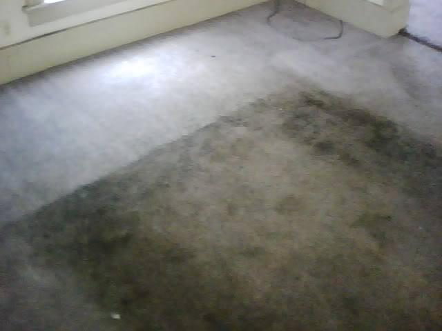

One I did yesterday

Reason I haven't been posting so much, been cleaning foreclosures. No power, no water, just a nuclear spray n/ suck

These ones are all in the hoods of Ak-Rowdy, and they are bad. I may even have to buy one of those STOOPIT turbo-vacs if I end up doing as many of these as I think I will (3-4 a week). I may also put an inverter on my truck to scrub off of, cuz they are paying me well.

I'm gonna pull a Hyde here and tell you if you were to pull that carpet up and wash it in a pit the water would run black for an hour.
After you cleaned it.
That ecological nightmare should be burned.
The browning/wicking will be insane. With or with out a pre vac.

You tell me how the hell to pad when there's no electric and I'll fly out to Cali and be your helper for a week, Fo FREE!

my contact called be this morning and said it looked great, I do want to pre-vac though, even if it is with a stupid turbo.

He said it was a foreclosure. No electric..... They know they are gonna take a beating on the sell price. They also know the new owners will MORE THAN LIKELY replace it. The bank just wants to make as good of an impression as possible without it stinking to hell and back. Nuke it, crank the heat, your favorite emulsifier and slot glide it. If the contact said it looked good you did good.

6 heaping scoops of Powerburst + 2 of oxy booster in my HydroForce, I had a nasty headache the rest of the day.

Point is, I was hired to remove as much soil as possible given the circumstances. I'm not going to tell them to replace when their paying me to clean. So if that makes me a hack, and I don't think it does, then f uck it...
