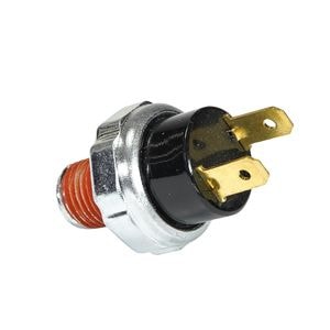

Hi guys I have a problem this thing is leaking pretty heavy and I just noticed it
It looks like it’s missing the cap in the center
I need to complete my day tomorrow but not sure how I’m gonna
The part number shows it’s a prochem part but is there anything I can grab at autozone to fix this and not wait

You can temporarily bypass the switch by removing it and plunging the hole with a 1/8 pipe plug if the machine won't start/stay running that means the switch is normally open and youll have to connect to two wires together. Keep in mind that you are bypassing a safty switch and it should be replaced asap but that should get ya back to work

Yes, you can pick one up at the auto parts store. I bought a couple of them to keep on hand for a spare. Give me about an hour and I'll have a part number available for you to pick up
14,630
This is the updated version I have on my everest
Amazon product
View: https://www.amazon.com/Standard-Motor-Products-PS-135-Pressure/dp/B0011TY9VK/ref=asc_df_B0011TY9VK?mcid=184eb40bc4f53ffba68befef81a89e72&hvocijid=16017042778012889439-B0011TY9VK-&hvexpln=73&tag=hyprod-20&linkCode=df0&hvadid=730434204848&hvpos=&hvnetw=g&hvrand=16017042778012889439&hvpone=&hvptwo=&hvqmt=&hvdev=c&hvdvcmdl=&hvlocint=&hvlocphy=9057435&hvtargid=pla-2281435178338&psc=1
And the version you have pictured is the old version. the part number on it is 78826 7psi 2030 mex1
14,630
The plastic headed one you have crapped the same way on mine as well because the plastic weakened due to the heat over time

Thanks for all the help I got the new part and it looks totally different
I’m trying to figure out best way to remove the old one
No way to grab it except in the back and it’s hard to access all of it

If you can't get a wrench in a 1/2" crowsfoot or a plumber's wrench should work

Ya I got it out and now trying to get the new one to thread my local store said that nothing fits the threads correctly and not to do it wrong or ill ruin the whole engine
14,630
I doubt you will. The threads on the oil switch will get messed up before the block does. It's a weaker metal on the switch

I have no idea what you have or what you're doing at this point all oil pressure switch I've seen are national pipe thread (npt) 1/8 or 1/4 most all being 1/8
Dwain Ray
Jul 22, 2020
1,151
1/8 pitch is 27 tpi 1/4 is 18 do you have a pitch guage? If you do measure the pitch of the old then the new if i have that information i can you what to do to properly install
