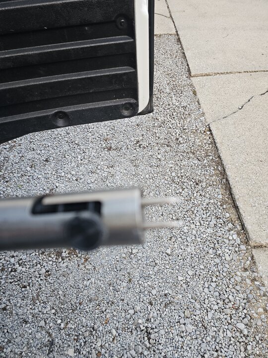

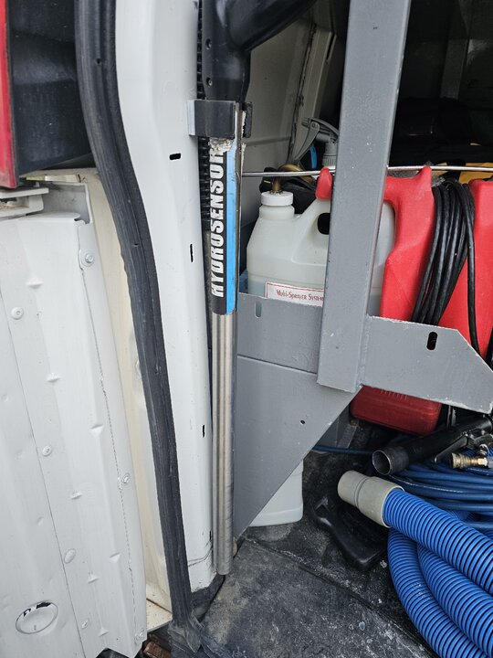

I use a moisture detector. It goes off when I rest it on the top of my shoes from the sweat and salts. Its very sensitive.

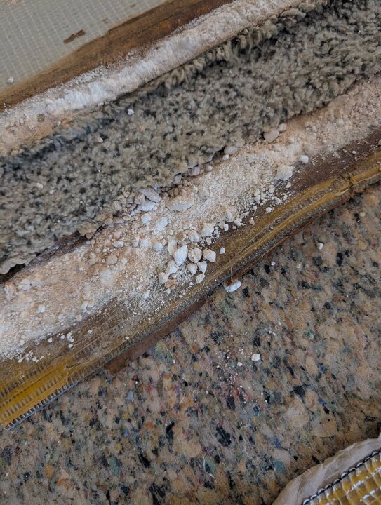

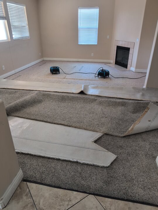

This is actually nylon, no smell, they needed stretching.
All long the seam was lumped up and hard.
I believe they used carpet fresh and a Bissell so much rock hard crystal powder stuck to the carpet and clumped under the seam tape.
Like a chia pet growing.
PXL_20250825_210245728.jpg 9b43cd9d-7c8e-4698-86d6-4f17fb8443fb.jpg PXL_20250826_015129447.jpg
11,420
Ps the pad was damp no smell to undried with fans before I put it back together
