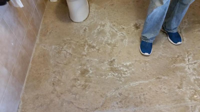

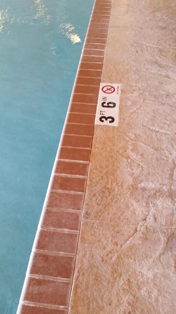

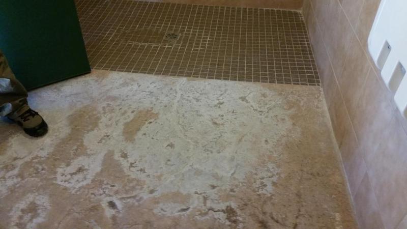

I had a call from a local hotel to check out their pool area (which is a mess) and we can't tell if it was sealed.
If we get it cleaned up, they maybe want to seal it but don't want slippery of course around a pool.
There's is Colored and stamped type concrete.
Gonna do some testing if can get to clean without acidic, but not sure....
Might need some help with this one!
Bad area in shower room .... Lot's of color changes I think from chlorine
Maintenance tested this area with acidic cleaner and took them 4 times to get to this more clear color.....
Can't find a spot that indicates it might have been sealed....but who knows what they did when they built it.
