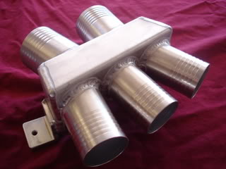

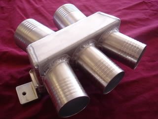

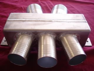

I've made several versions, each one a slight improvement over the last for net airflow.
Here are a couple of versions, the next one will probably be the final, it's a combination of the two you see here, it'll be ready in a few days if the planets remained aligned.

Greenie,
Will the final version be 2.5" all around or can you get one in a combo of 2" in the back and 2.5" in the front?
Cost?

Also does it come in a 2 to 1..... in a 2 inch and if so............ how much

"Greenie, very nice, now how the hell does that thing work"
First off.. the pic is actually showing the manifold from the Backside.
It just brings three 2" hoses off the waste tank to a common "chamber" then goes out to two 2.5" ports, that way you have three hoses sucking on two hoses if you follow me, it totally unleashes the beast, and is particularly wicked in a round tank with three evenly placed ports that have 90º turns inside, it really induces a Vortex in the tank.
Jim: If you just want to use 2" hose, and just run a single 2" tool, I'd probably just stick with the Y off of the Vortex/AT standard ports, the 5 port manifold is really for 2.5" hose use.
If you look close you can see the 3 ports are all 2" and the two are 2.5"
As of now the manifold looks like it will be $125-150, I'm gonna weld up 10 and see how production goes. In the final version all ports will be straight, none of the angles will be kept, looked good on paper, turned out to be a PITA to hook up two big hoses at the same time.
2"sYs are $49
2.5" Ys are $59
Already have 5 "sold".

Jeff,
That Vani-Fold.....Looks like it would work GREAT on my PC 805....It already has the 3
2" ports on the w-tank..... :!:

Greenie,
Could you make one with your standard 3 2" ports entering then (1) 2.5" and (1) 2" exits for those of us who haven't made the switch yet but plan to in the future? If so, then I would need a 2.5" and a 2" plug.
Let me know
Billy
P.S. Awe heck nevermind (I had a brian fart), I could just use a reducer for one side. Let me know when your new one is ready for shipping. My address has changed.
