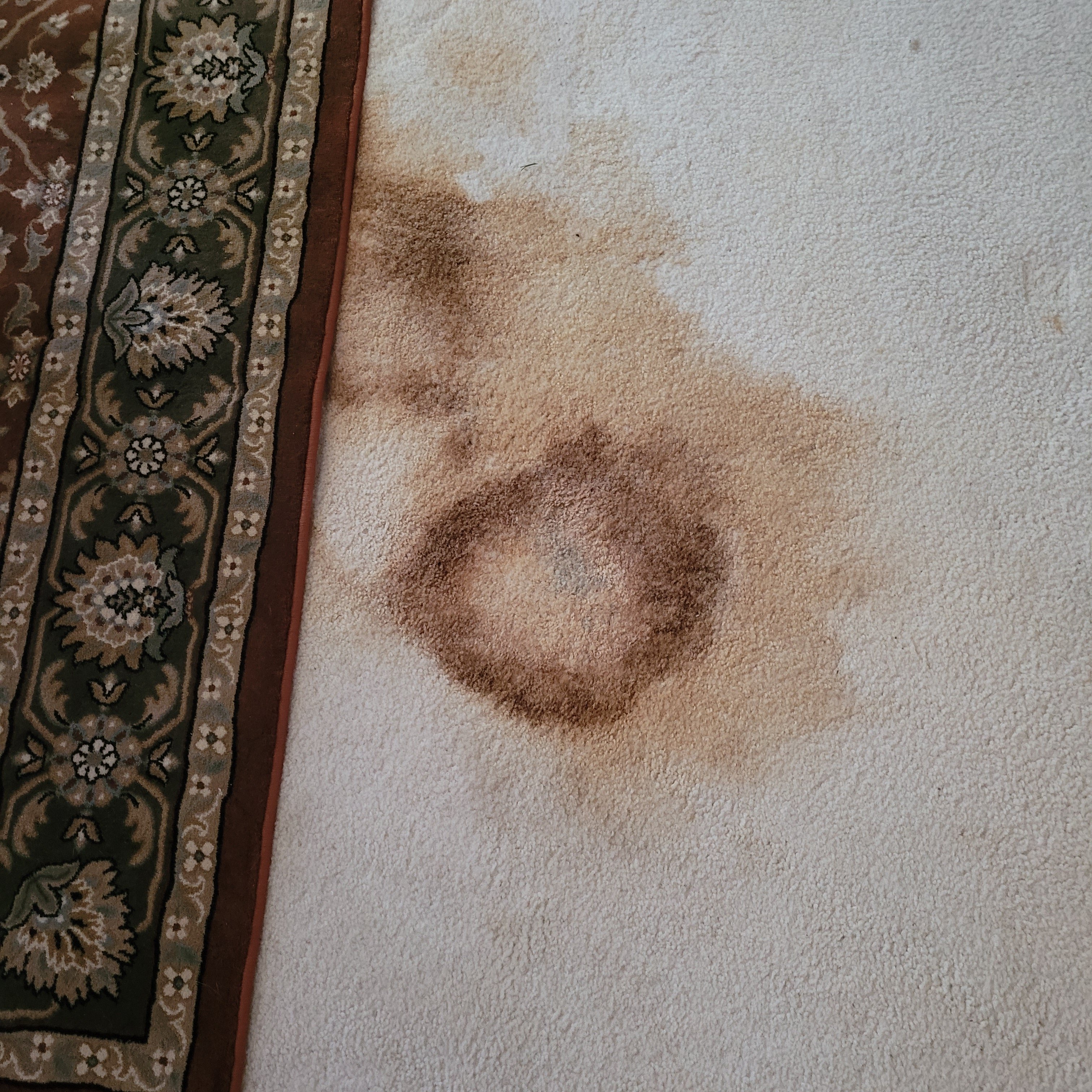

To spark your interest, here's a pic before using the Cat attack. What do you think? Was I able to get some of it off?
11,536
Cat attack is a odor modifier I don't think it works in stains.
Original odor cide does a great job on masking smells so does saiger cide.
But yeah those cats will rise again and continue to smell

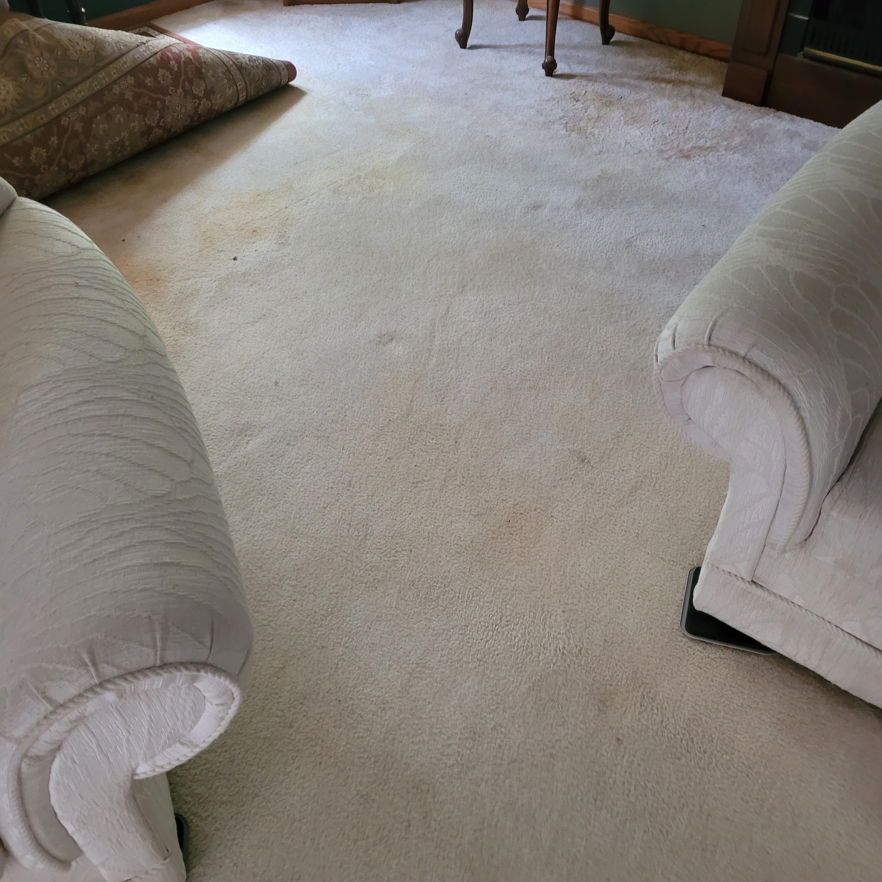

Pissed off or on
Black light didn't show all that

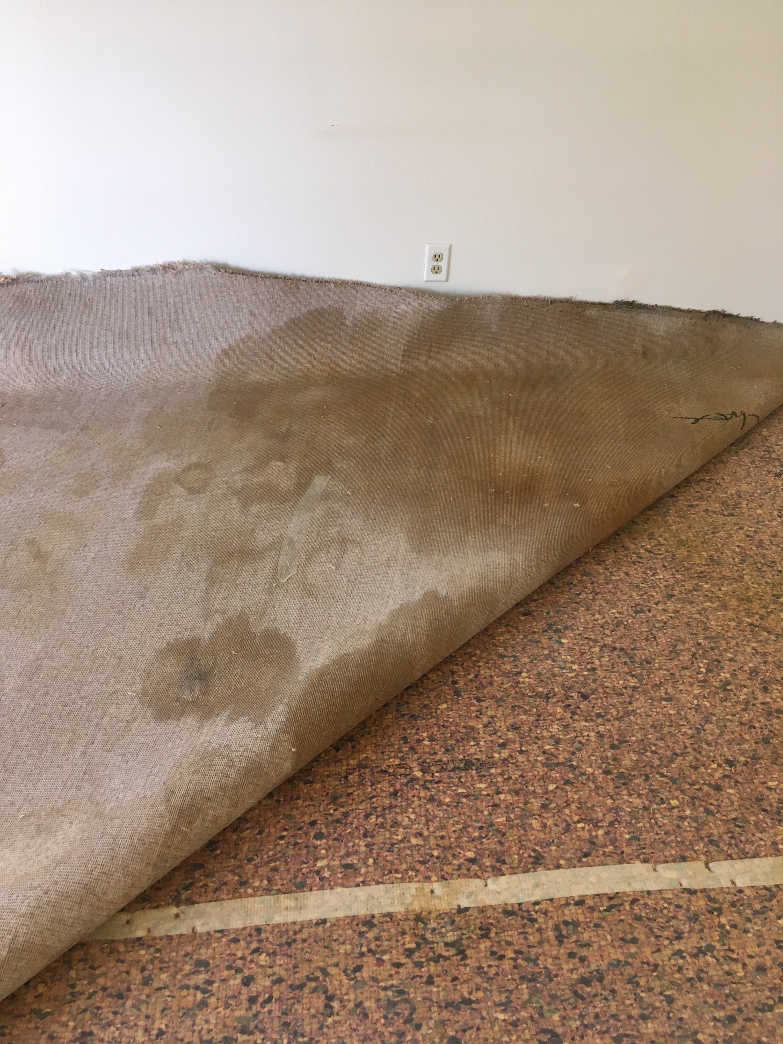

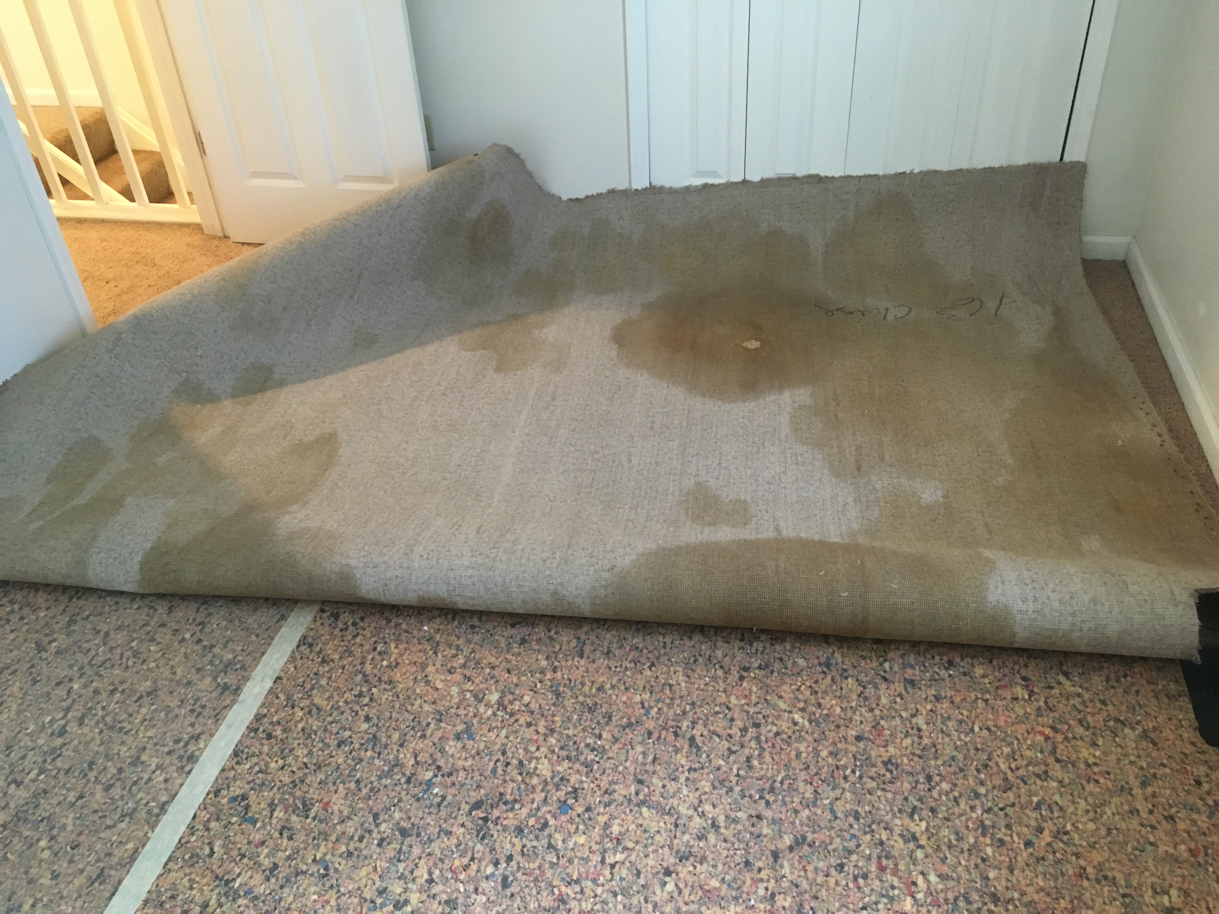

have found that a lot lately.. Because of the less expensive fibers being lately being pushed.
PETs Polys, etc.. not absorbent, so urine goes through the face , slides off of fibers , going directly into the backing. the salts may show up, but not much. but once you pull the carpet up lOOK OUT!
As someone here mentioned, the smell of cat urine is persistent. In this case, the cleaning was long overdue.
