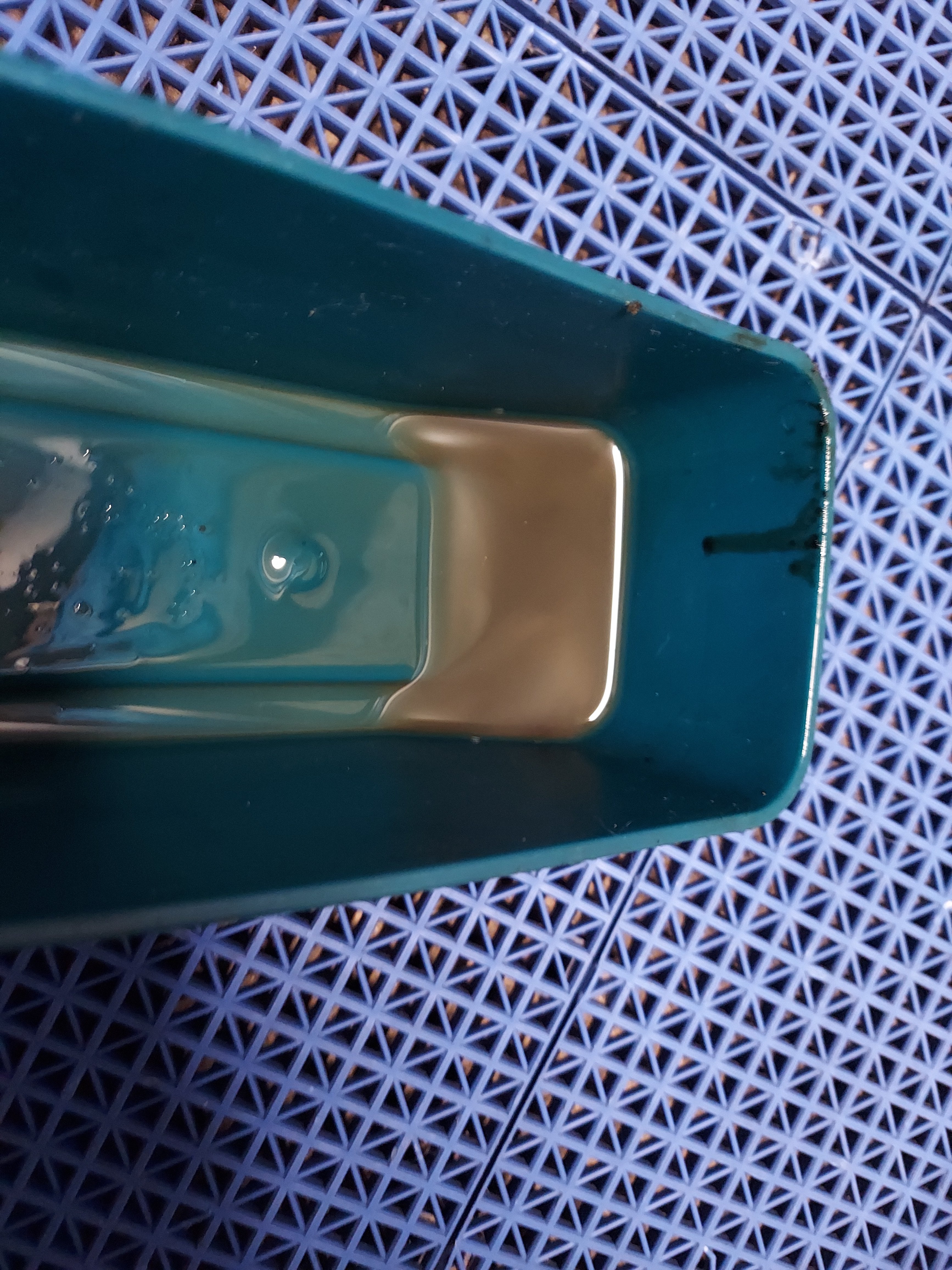

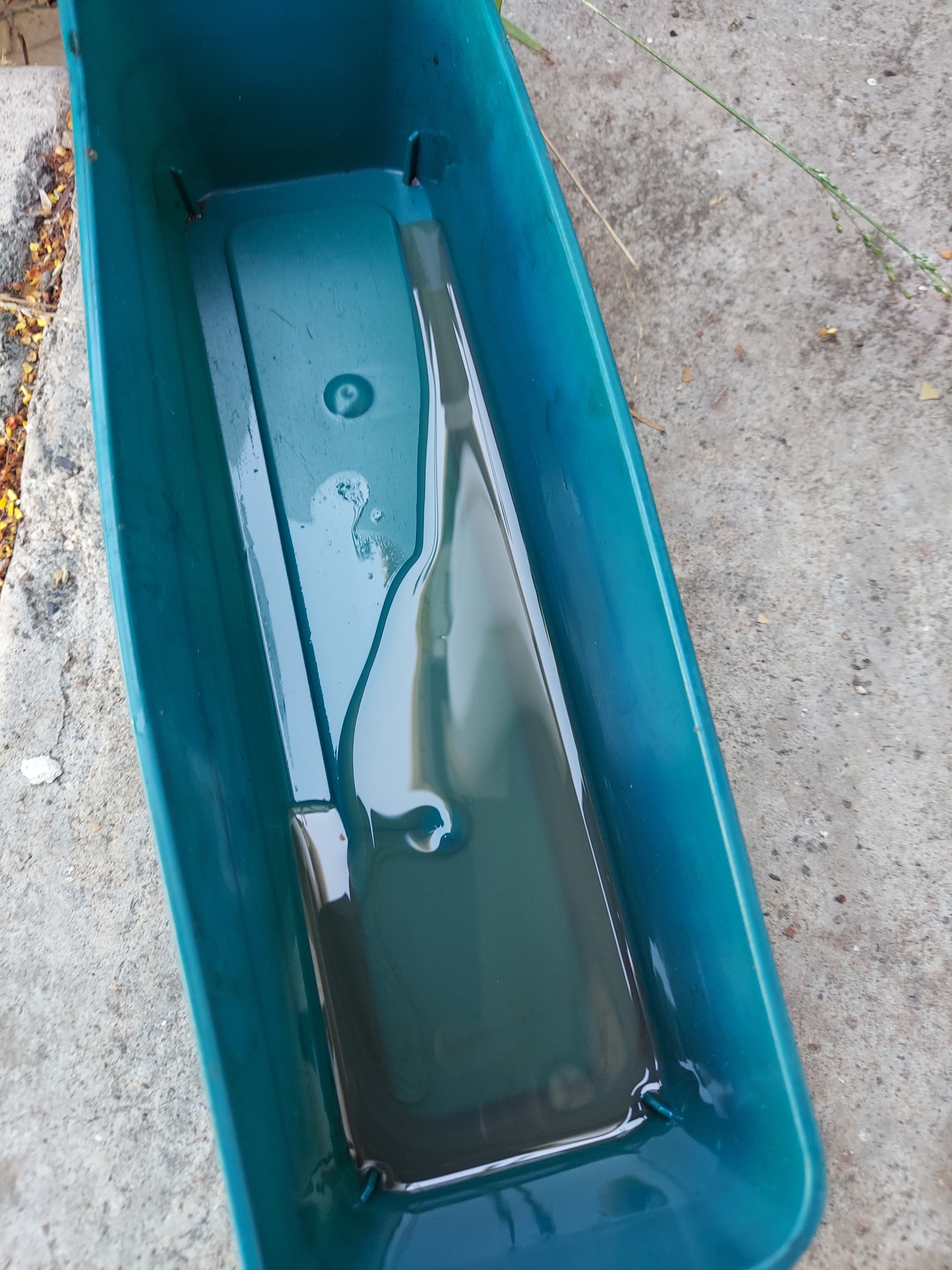

This morning after cooling down the system started up and had pressure with no problem-- but I already had the machine apart so changed the belts and oil anyway.
