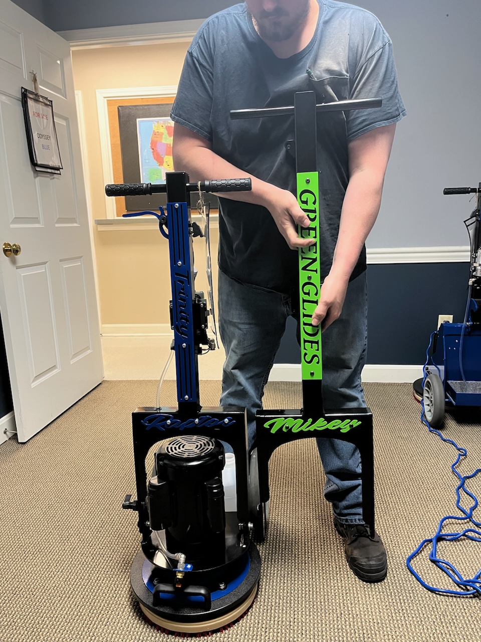

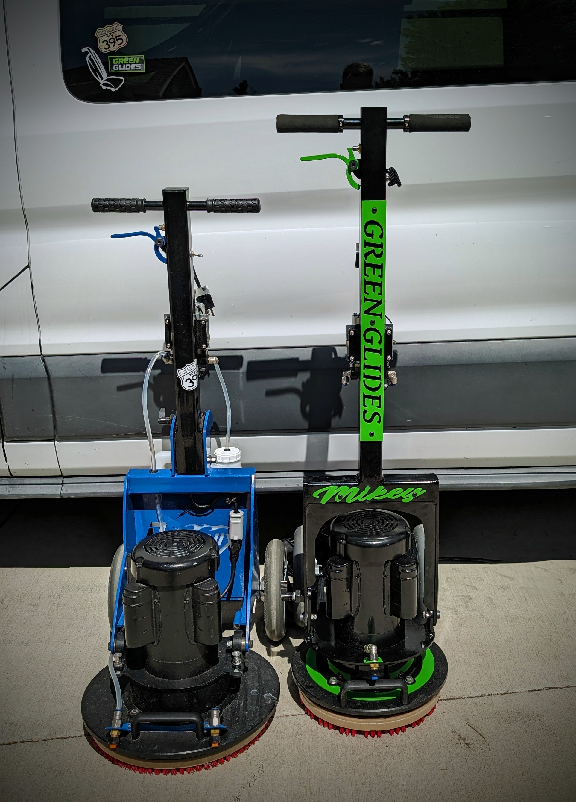

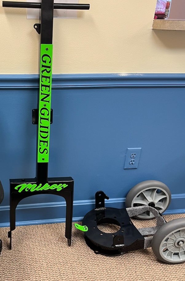

My TOPS Raptor was a wee short for my Shrek sized proportions .
116,030
Larger wheels..
Taller jug holder..
and all mine!
116,030
I've never been a "one size fits all" sort of fella....
The wheels UP design of the Raptor demanded a longer handle in order for me to dance with it....PXL_20240602_221743975~2.jpg
