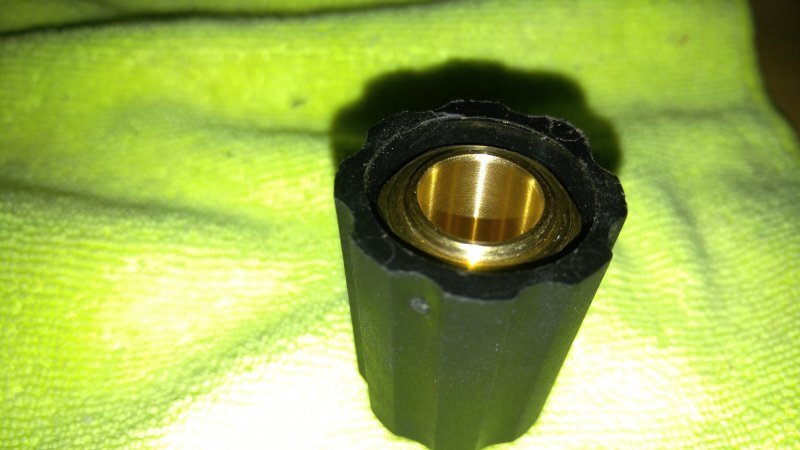

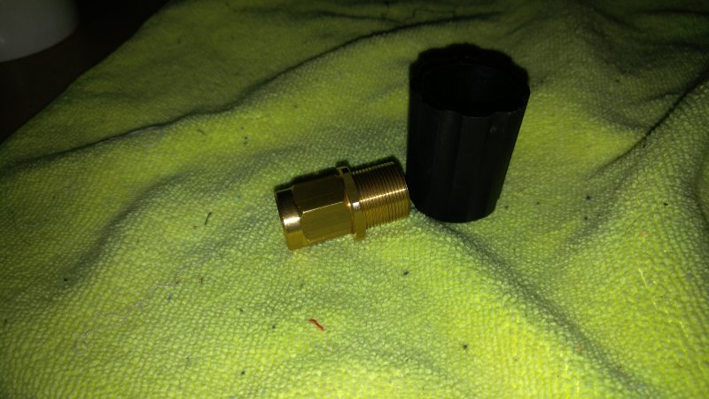

I can lightly press down on the unloader valve with a screwdriver and pressure builds like normal. The Knob has only a few small male threads exposed. Not enough to get a bite. Someone on another forum suggest putting a washer or two above the spring. I tried that as well but there aren't enough threads. Can anyone tell me if the Knob is adjustable from the bottom? The threads spin but won't extend or go back in. Is this what the bottom of the knob is supposed to look like? I bought everything from rotovac and they are offering a replacement. I would rather solve it myself or at least learn from this because I have confidence in the machine. Sending me a new unit transporting the old one seems unnecessary. I'm supposed to call this morning he's going to do a conference call with Pumptec.
