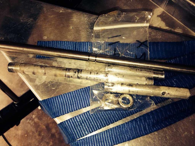

I purchase a slightly used HOSS about 4 months ago, mainly to use on high traffic areas in my rentals. Worked great for this purpose and put a little life back into the carpet. After about 3 weeks I discovered that one of the spray bars had broken off and in taking in off discovered two others that were cracked. Ordered the replacements and it took about 3 weeks for them to arrive. Used the HOSS for another month or so then when loading up for a job the cheap aluminum axle broke into. So I ordered a replacement axle and was told with the new axle I also would have to order new wheels which I did. I received my order yesterday again after a 3 week wait and to my surprise the replacements wheels were not in the box. So I have to call today to find out the status of my wheels and I'm sure I will have to wait another 3 weeks to get them. I was pleasantly surprised that the new axle was made of stainless (so I assume there have been many axles broken that we're made of aluminum) I was disappointed that I had to pay for this replacement when when it was obviously a design flaw.

your situation has nothing to do with the machine or its performance......but with that being said...your not the first one that has had the same exact problem...
It's called lack of commutation between supplier and distributor...........
the axle and wheels should of been replaced at no cost...the distributor should of taken down the serial number and called it in....then they would of checked and made sure that this machine was not updated to the new axle and wheels....and if it was updated to the newer blue style site tube thingy......
if the serial number showed that it was not all up dated then it should of been sent to you at no charge......
Did your distrubitor know this and was just trying to make a buck....or were they not informed...??
as far as the flow bars breaking....don't know...I have pounded both of mine for well over a year with not a single one breaking....
but your not the only one that has had a few break..........
3 weeks is a bit to much...but who knows why...or on what end the delay started..........

Scott Harlib from Sapphire has called and left you a messgae to contact him please do at your earliest convenience. The axle was changed in production on 09/14/11 the sight tube you are referring to was changed on 09/12/11. Both would have qualified for warranty upgrading. I don't understand why either the person you bought the unit from or the distributor hadn't taken care of this. In any event we will as we always do. In the future call the Sapphire people directly at 866-445-3030 or if they don't respond send me a pm so that we can resolve these types of issues directly as I'm certian we could have saved you a ton of frustration.
