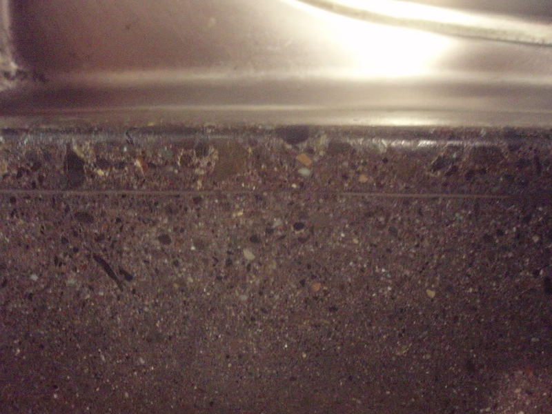

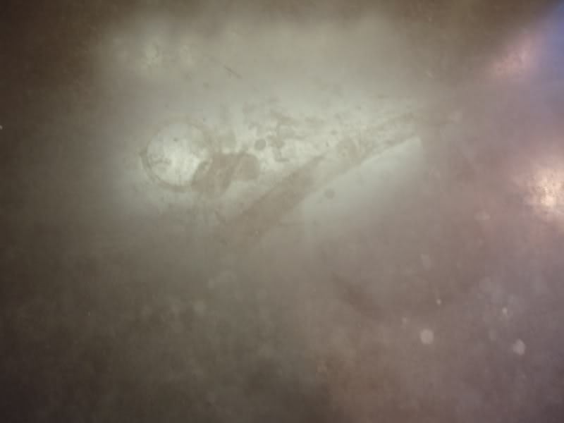

Before (five years old, only penetrative sealers, lots of deep etching but no stains.)

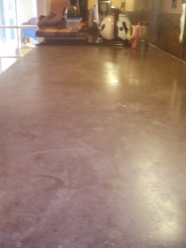

After a round of Monkey Pads (400 -11,000) Didn't get all the etching but looks way better.

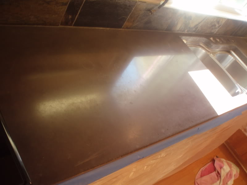

After Enhancing and Monkey Waxing.

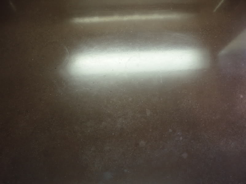

After Padding and Enhancing but before Waxing

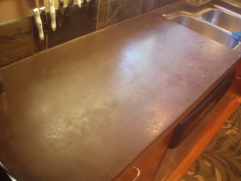

After Waxing..
I'm hoping the Concrete specific pads dig a little deeper.
Have to be careful not to go too deep or you'll expose aggregate.
Etching is a fact with Concrete counters.
Got to learn to embrace the wine glass rings.
