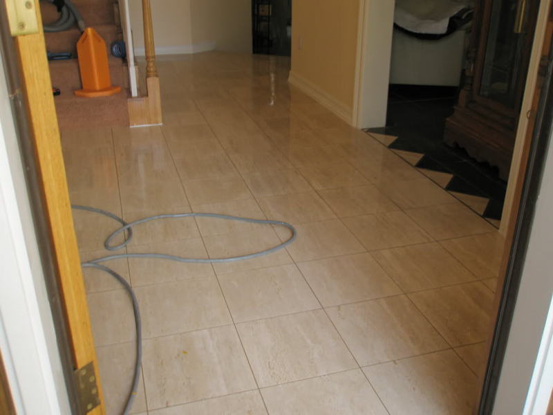

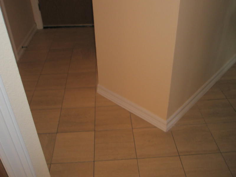

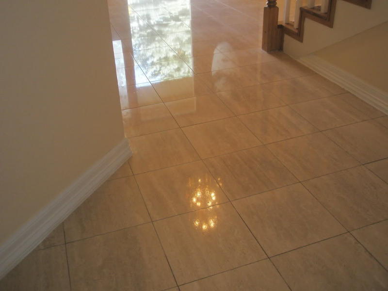

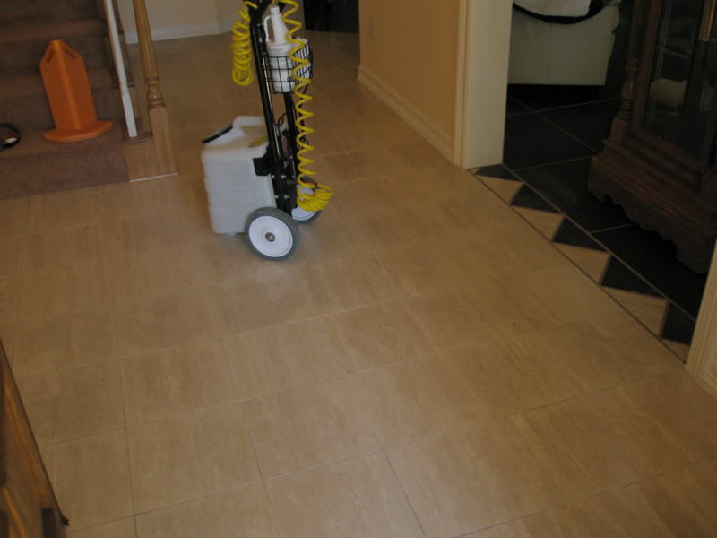

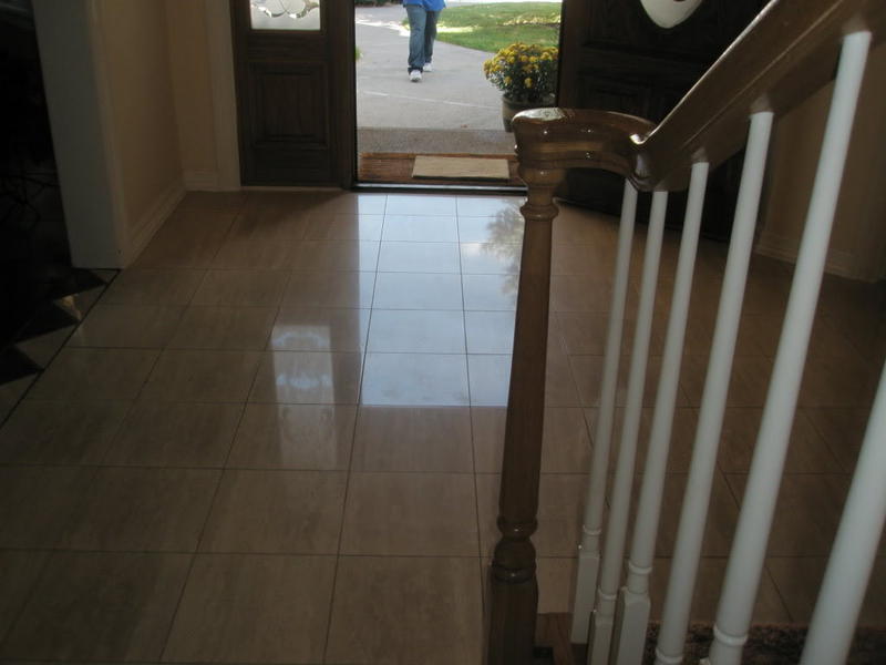

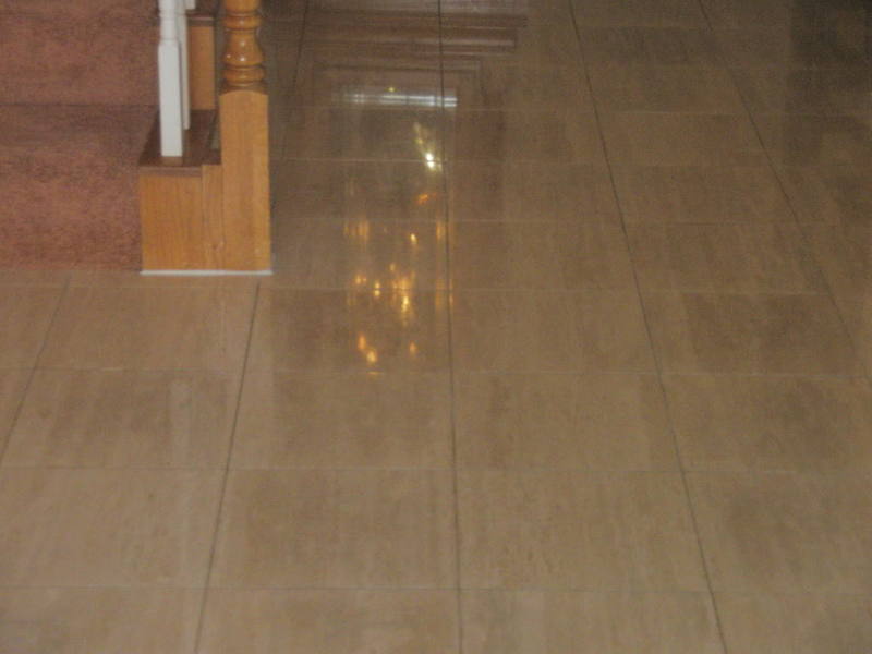

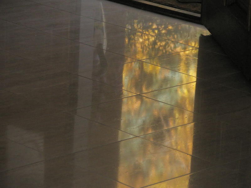

Nov 3, 2008 #1 Ron Lippold RIP Joined Nov 8, 2006 Messages 3,373 Location Albuquerque Name Ron lippold It just keeps getting easier Before after

Nov 3, 2008 #4 TimP Member Joined May 19, 2007 Messages 4,055 Looks like that one was done by a pro before to not have any lipage like that. You did a good job shining it up....however I think that's an ugly floor.

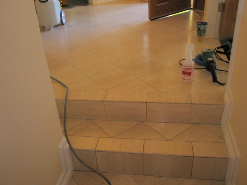

Nov 3, 2008 #5 Ron Lippold RIP Joined Nov 8, 2006 Messages 3,373 Location Albuquerque Name Ron lippold Scott Monkey Pads are used for polishing stone with water only. They come in different grits from 800 -11,000. they are sized from 7in for counter top steps and corners to 17 in for the floors.
Nov 3, 2008 #6 Scott S. Supportive Member Joined Feb 3, 2008 Messages 3,251 Location PA Name Scott used with what machinery?
Nov 3, 2008 #7 Ron Lippold RIP Joined Nov 8, 2006 Messages 3,373 Location Albuquerque Name Ron lippold a weighted 175 floor machine 50 pounds of added weight for the floor and a variable speeds makita for the counter tops and edges and steps.

Nov 3, 2008 #13 P Phoenix Phil Guest Nice work! I see your fine new Mytee sprayer! How's the sprayer working?
Nov 4, 2008 #14 floorguy Supportive Member Joined Nov 7, 2006 Messages 6,948 Location Utah Name Doug Not to down grade the job.... but why are all the before pics not in a lighted area??? Either from above or a door open?? Because all the after pics have lights shining on them...
