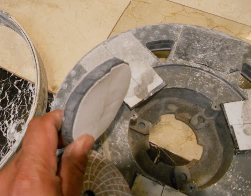

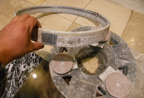

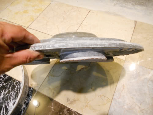

Diamond equivalent to monkey pads for under $100 bucks.
The easiest and most user friendly polish powder is Diaglo. For a maintenance job, say marble was put down about a year ago and now there are some minor scratches and etching you can either get a 800 grit monkey or 3 1800 grit diamonds followed by polishing with diaglo.
You can get the 3 diamonds (4") here:
http://www.regentstoneproducts.com/item ... EGENTRESIN
Get the flex foams (or make your own) too so it helps go over lippage and makes it easier to handle.
http://www.regentstoneproducts.com/item ... e=FLEXFOAM
Diaglo about $25.00
Diamonds Price $15 x 3 = $45.00
Foam risers about $25.00 or make your own for about $10.00
Horse hair pad about $6 bucks
For a driver you can get an old one that has the pegs and cut them out in 3 sections (see pic).
Use a garden edger material for a skirt around your buffer to protect from slinging
Also , if you're starting at this high of grit you don't need any additional weight on your machine. With mp's you need to add weight because the abrasive they use is not as good as diamonds. Diamonds too are more consistant.
Since you're starting at such a high grit you're still leaving some of the gloss on the marble. This will make polishing easier. Again, this is not restoration and will only take out small scratches and etches (equivalent to monkeys). It will be much faster then mp though. Polishing takes some practice though. With some experience polishing you can use an 800 or even 600 grit diamonds instead of the 1800 and get a bit more deeper scratches / etching.
