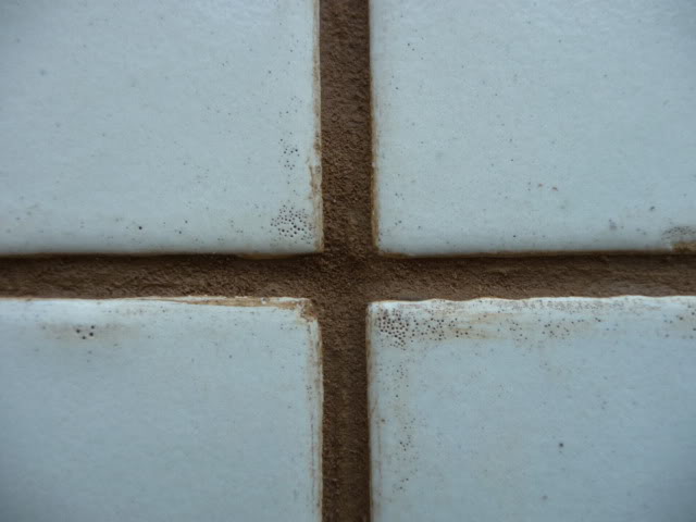

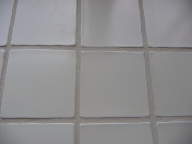

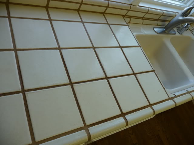

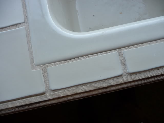

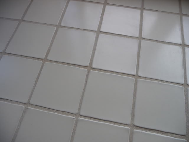

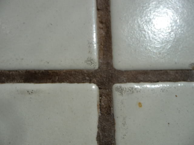

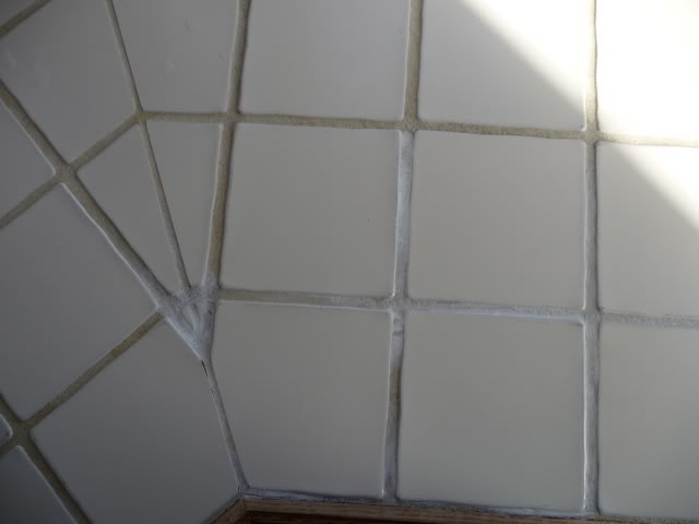

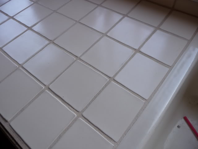

This lady though using some premix grout to cover her stained counter top.
Not only did she goop it up real bad but she used the wrong color.

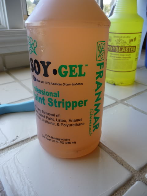

I used Franmar Soy Gel stripper. Nice safe stuff. No odour and not skin burns.
and a few tools..
Power washed it off, color sealed it with Grout Perfect and voila!

Have you ever used that Soy Gel stripper before? And is that a Magic Wand product I see in the background there? :shock:
