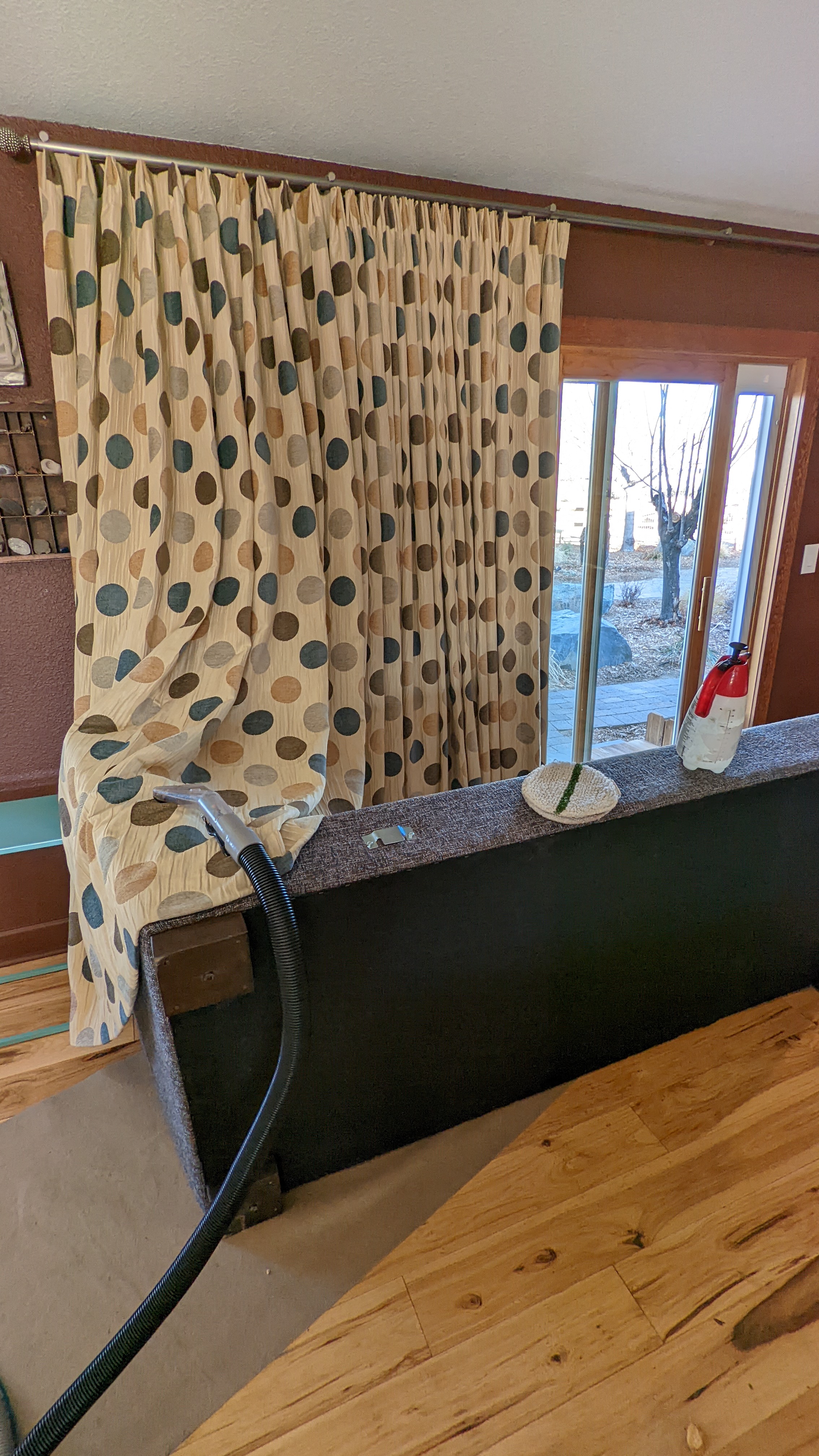

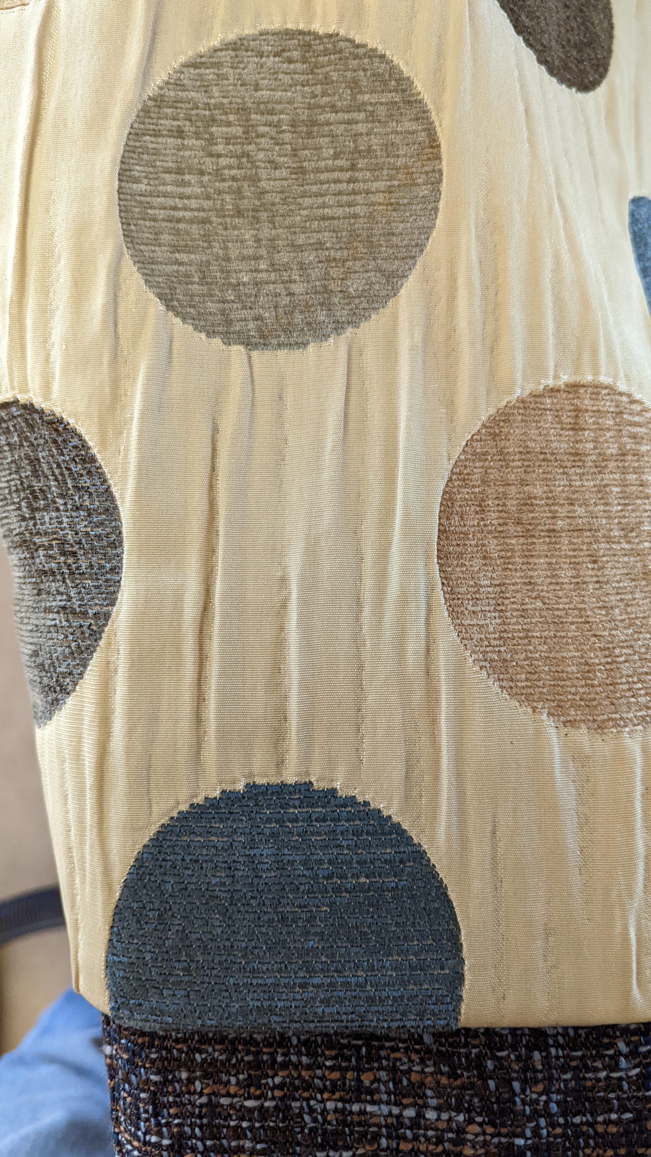

Look at this premium fine fabric mofo
116,318
Having COIT flashbacks today as I haven't touched a window fashion in 22 yrs
Full of all kinds of dogs smears and a few pee pee marks and it all came out fantastic with pro-chem fine fabric and AFR
Reactions: Jim Pemberton
Have you cleaned those before?
We rarely wet cleaned draperies. Several reasons but mostly liability. They hang in the sun all day and rot.
We used a stainless steel tool with a perforated head to vaccum them. Then sprayed with OMS and after a short dwell, wiped with white terry cloth.
My main concern would be how they dry. Will they wrinkle, pucker and draw up? I would think you'll need to press pleats back in with a Jiffy dry steamer and hand Mitt.???
116,318
We rarely wet cleaned draperies. Several reasons but mostly liability. They hang in the sun all day and rot. jacquard weave with a liner, line was fine
My main concern would be how they dry. Will they wrinkle, pucker and draw up? I would think you'll need to press pleats back in with a Jiffy dry steamer and hand Mitt.??? I tested...not my first drapery rodeo bro, and I only cleaned a foot or two from the bottom.
