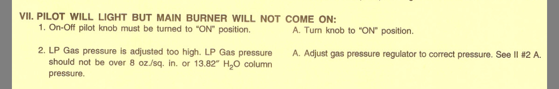

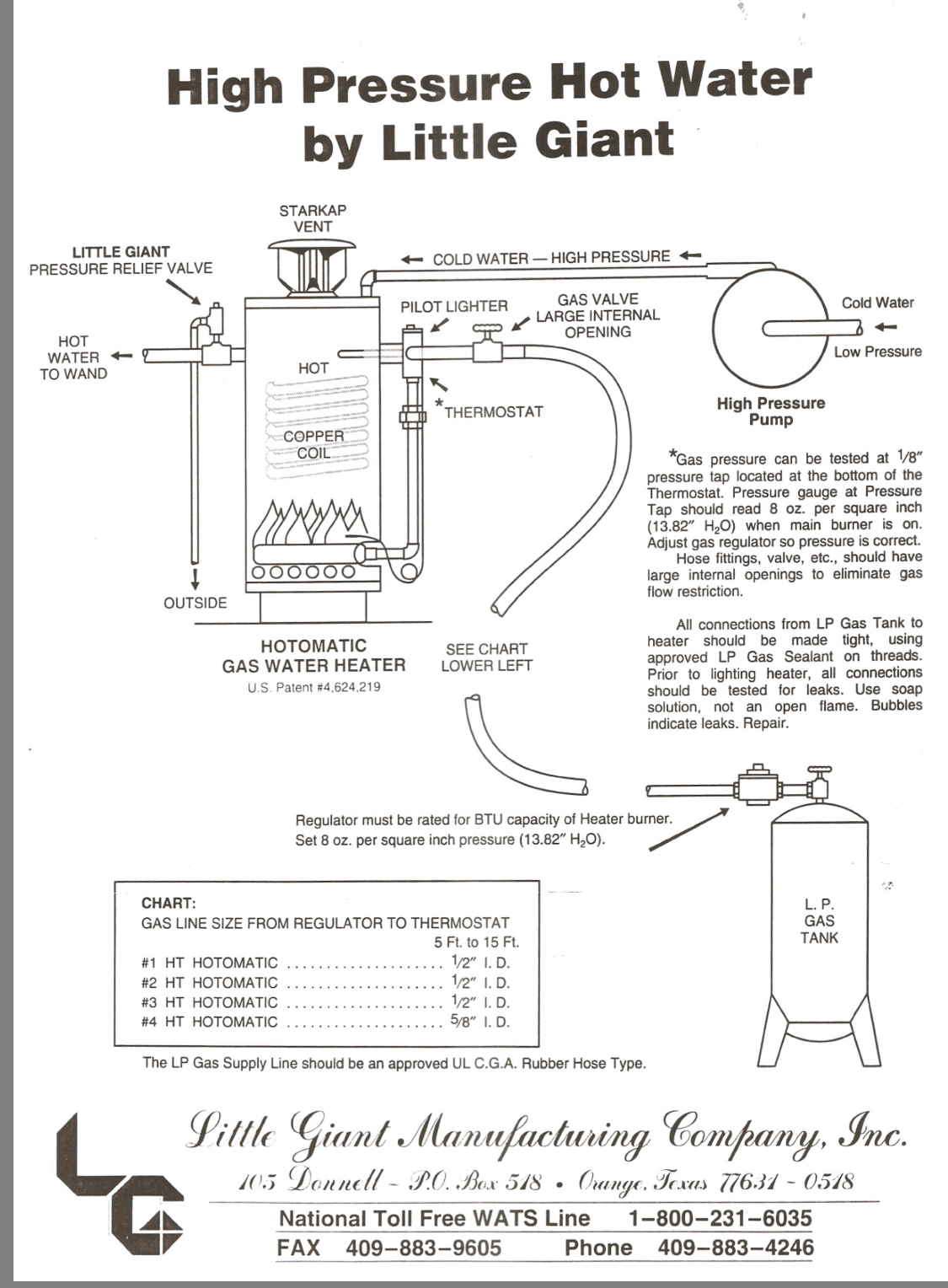

Little giant list the gas pressure being to high as one cause"
I have been suspecting the regulator but have not tested it yet. Could a bad regulator cause high pressure at the unit?
I would assume that it can. Here is the info on testing/adjusting
At 50 bucks I’d probably just replace it
