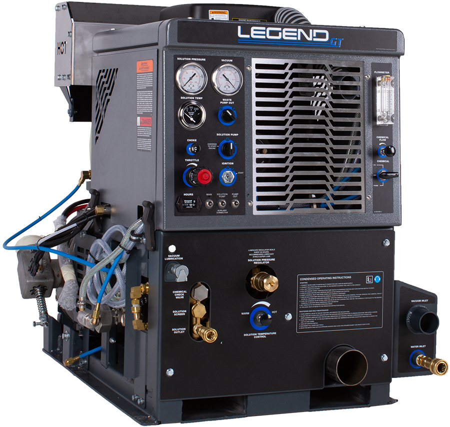

Built with Prochem DNA, the 2023 Legend GT truckmount is CARB compliant for all 50 states! Its Kawasaki V-Twin air-cooled engines is quieter and delivers truly consistent heat and high pressure. Simplified operation and easy maintenance, plus its rigid, no-rust aluminum frame and 2-year warranty make this a solid investment.
Accurate solution metering maximizes carpet and upholstery cleaning performance. It's hard surface ready, with up to 1200 psi solution pressure.
All exhaust components are treated with Cerakote ceramic coating to reduce truckmount operating temps.

"No rust" is that like "no wax" floors??? True sorta but misleading no wax floors do not require wax but they do require "finish " aluminum doesn't "rust" but the " corrosion" is sometimes worse especially when induced buy electrolysis, why is rust corrosion but corrosion is not rust???? If they truly didn't want to f%$@ around with the truth they'd build and advertise a corrosion free stainless machine. But like everything else we're just stupid ass gullible uninformed consumers but hay look at the bright side it's got a warranty that'll last for at least 40% of your advantage payment plan !!!
I get the love for SS...
but see no issue with Al as a frame material. Lighter, cheaper, and plenty strong if well-designed. I wouldn't think that anyone who bought one would stupid or gullible. :headscratch: Plenty of Al frames (and tanks) out there doing fine after many years

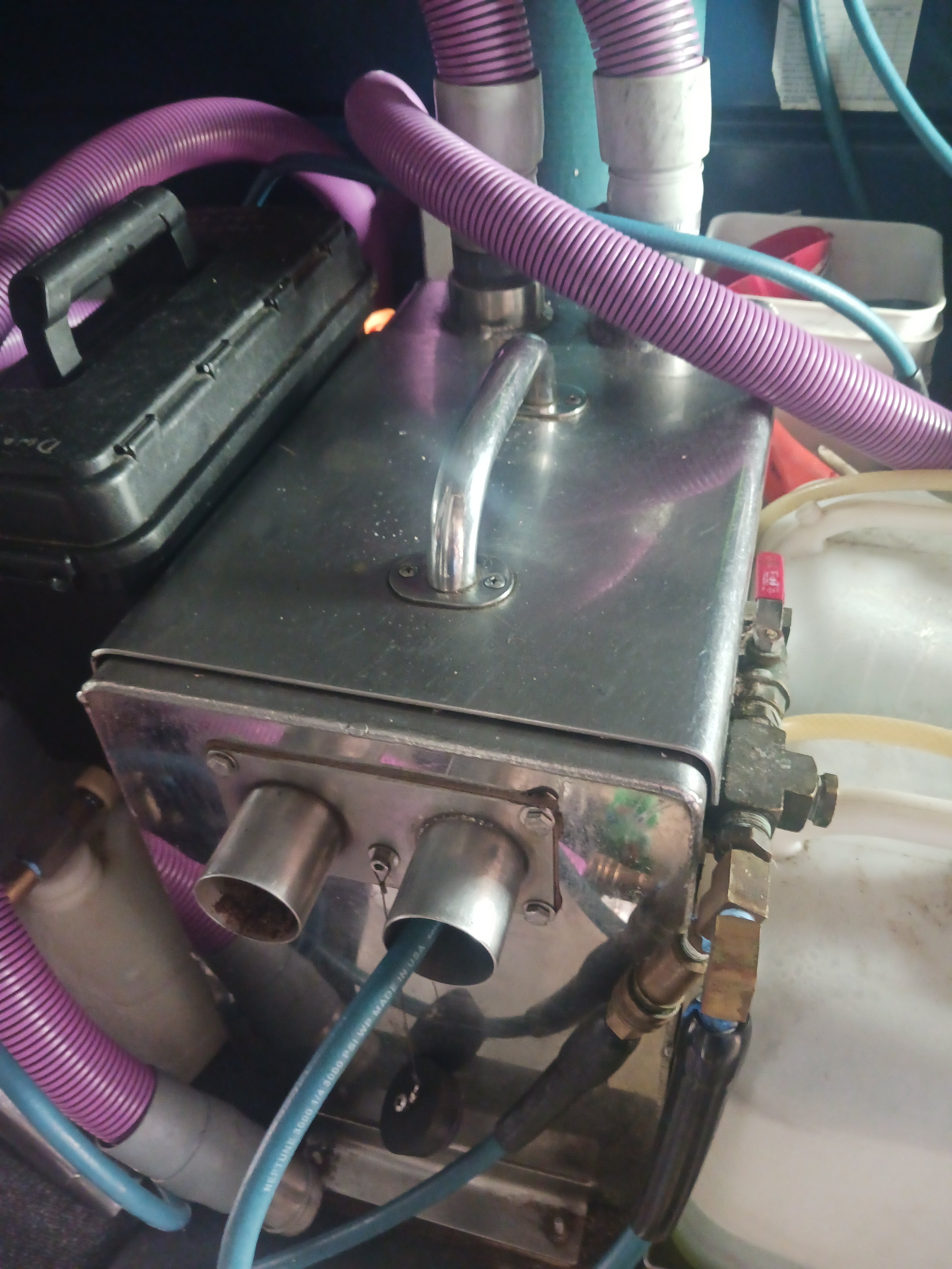

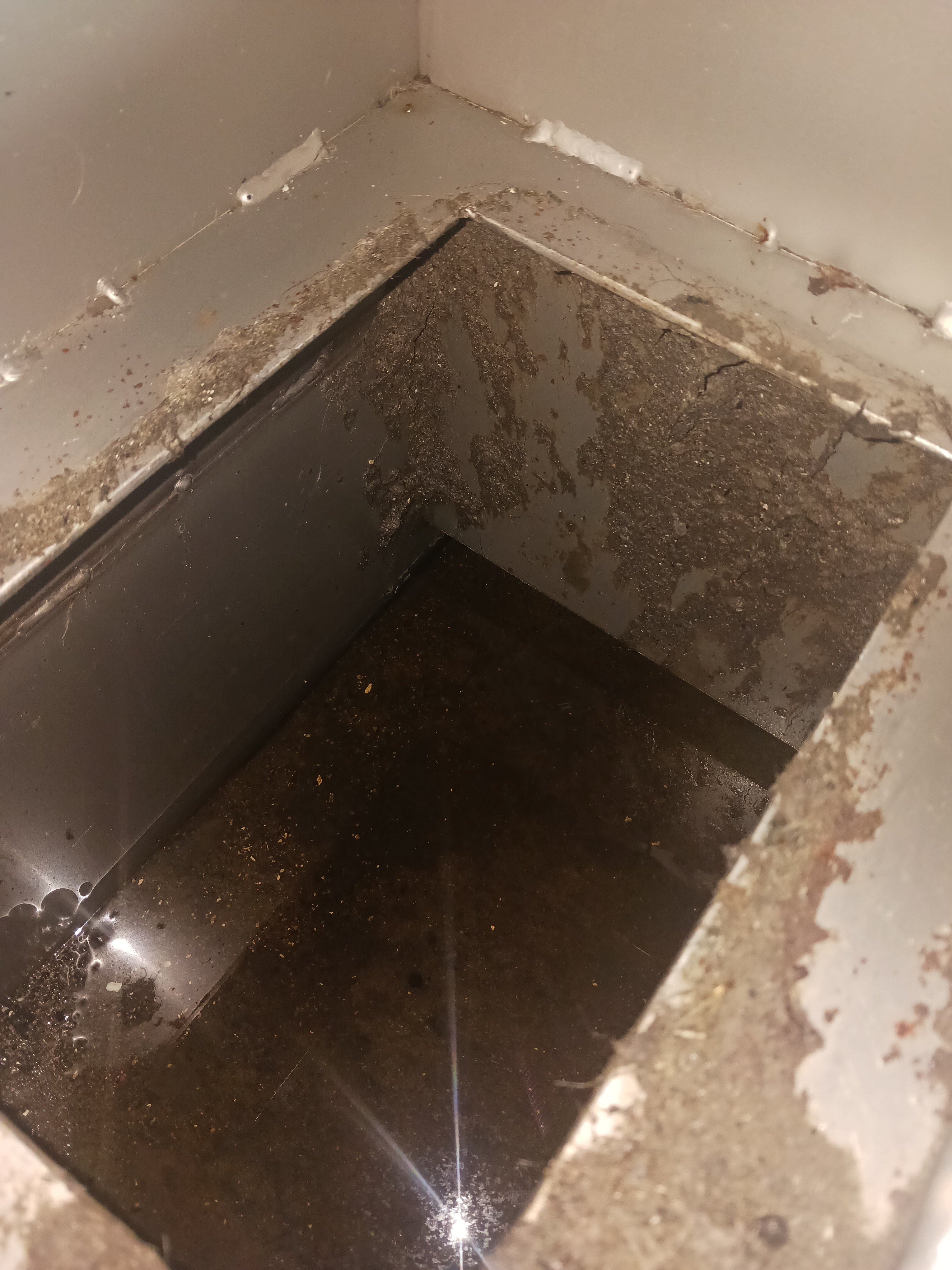

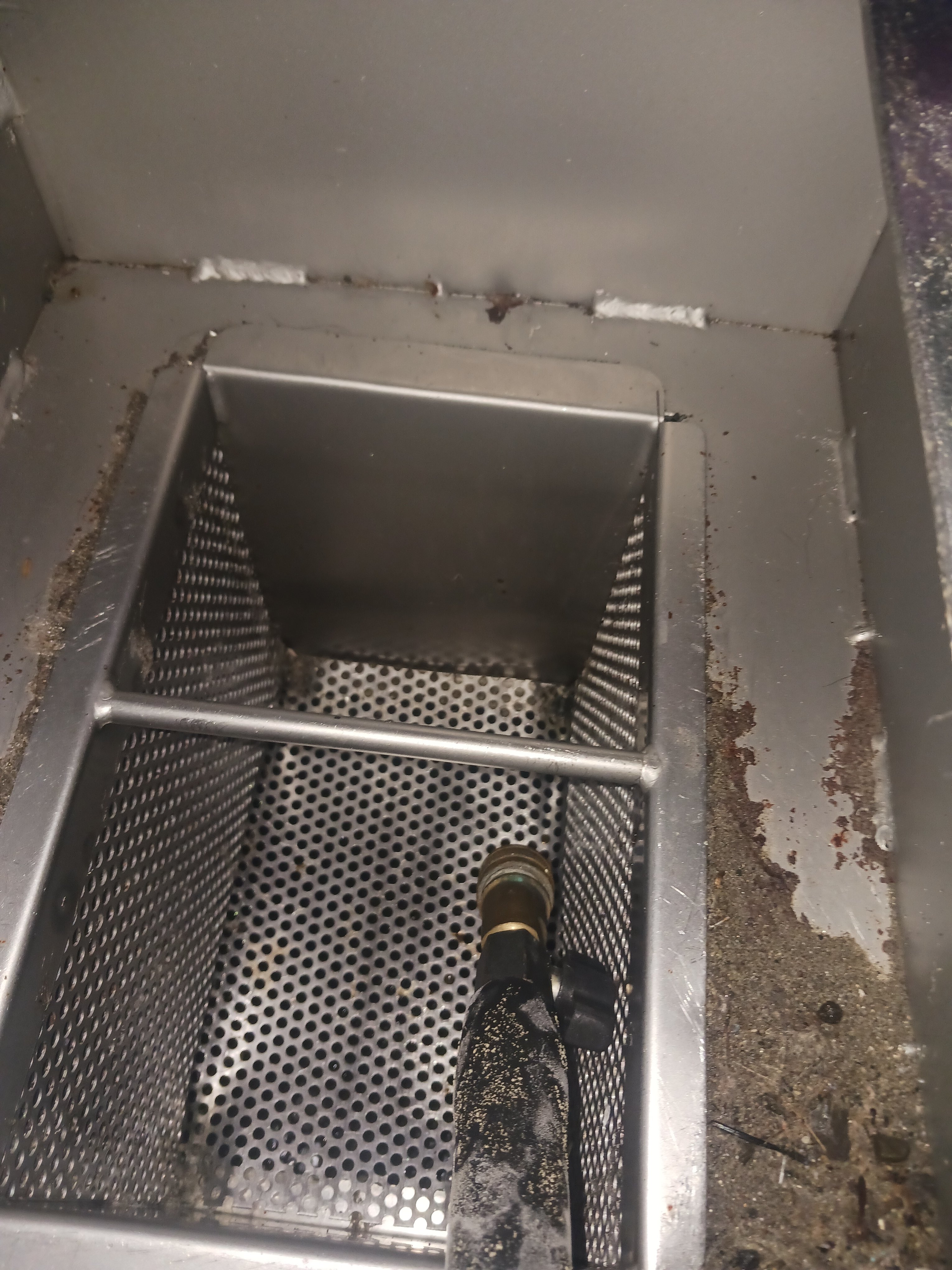

Around 2000 i bought 2 prochem aluminum filter boxes, at the time t was using a little clear plastic wastetank pre-filter i was shocked by the condition of the aluminum boxes after just 3 years! So I commissioned a local boat builder to take their design and build 3 out of stainless this is what they look like today after 20 years of service, i thought i still had a aluminum one to show you but after going through my used but good parts it wasn't there probably threw it away junk after only 3 years!ya aluminum is light but for me its stainless and a heavier duty van and im 100s of thousands of dollars ahead over my career but on the flip side the aluminum machines do get lighter with each day's use😂🤣😅

Looks nice. Don't know anything about the Kawasaki engine though.
