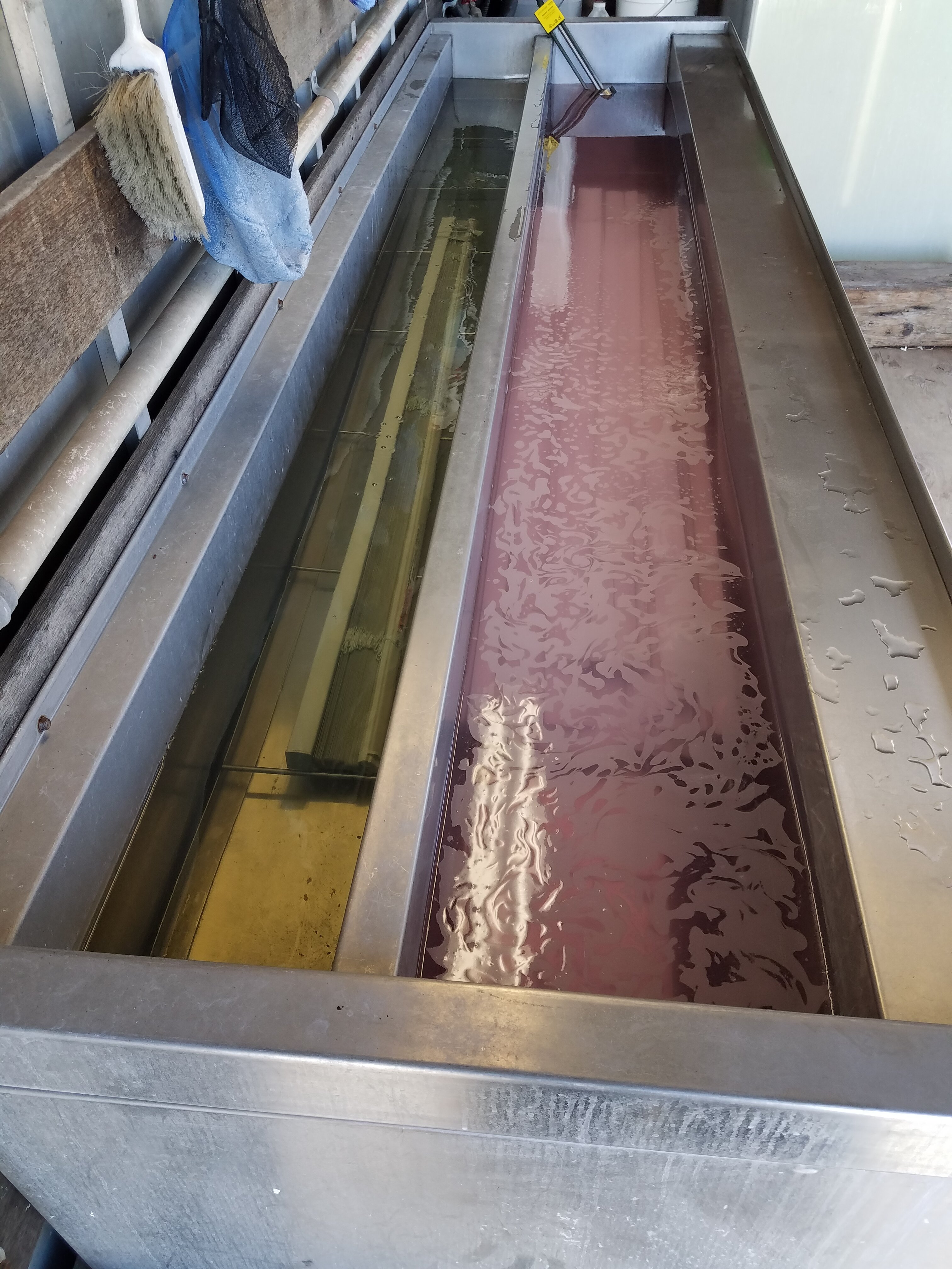

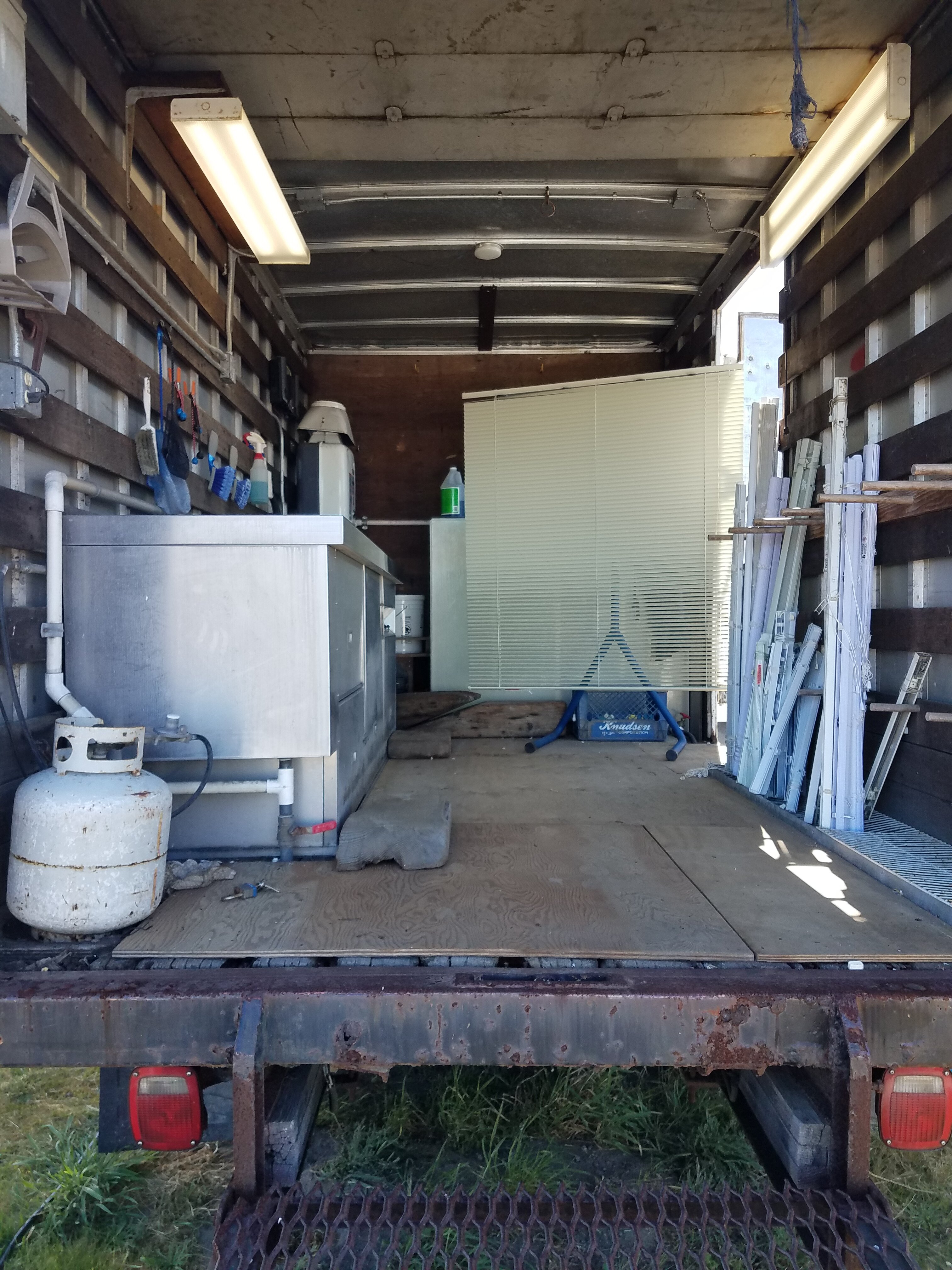

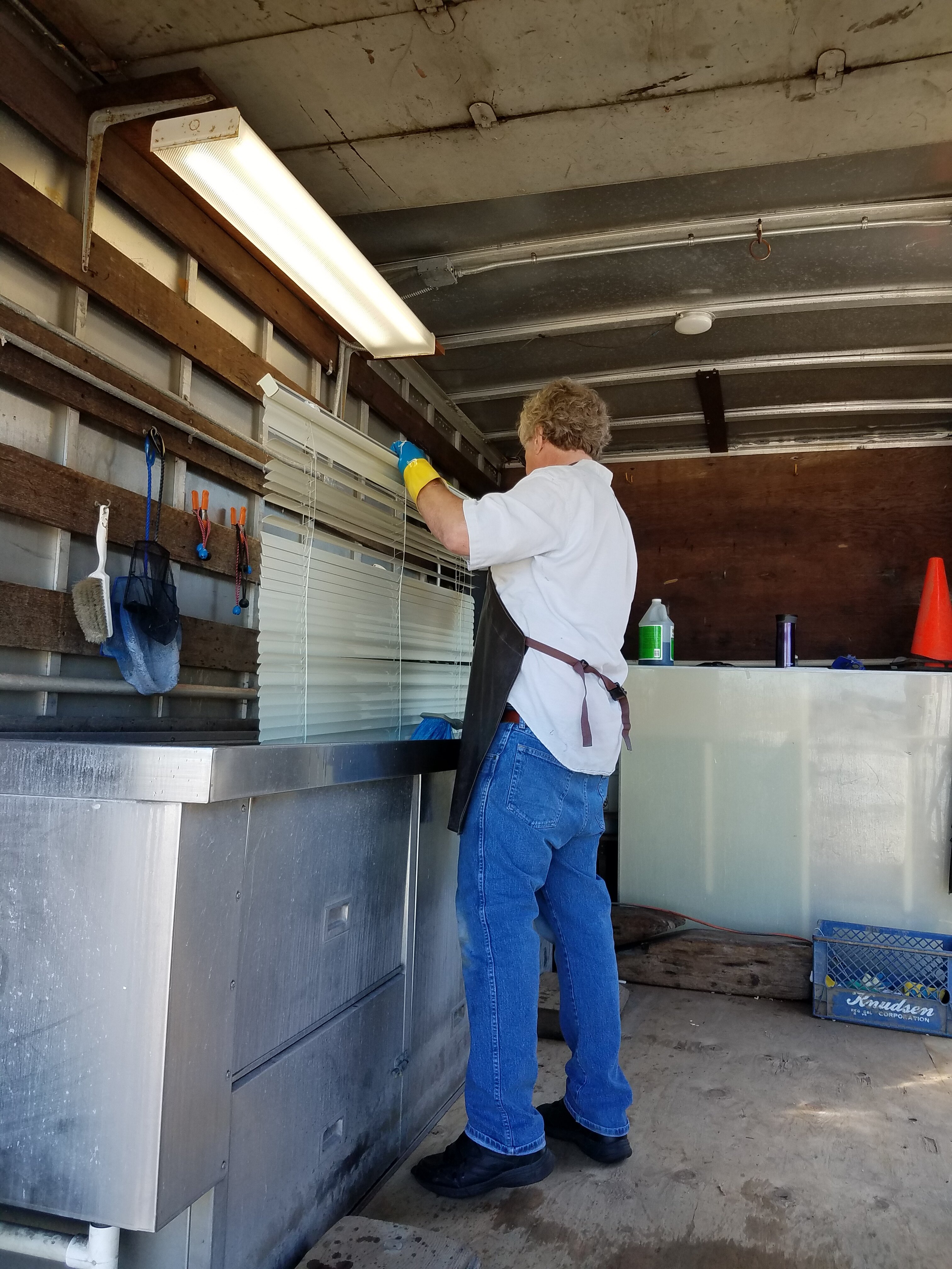

I used to do them on site but it got too expensive to maintain, insure, and license the 14' box truck to be mobile. For the past 10 or so years i do them at my shop. I try to have 15-25 of them to do before i setup the machine. I go around in the morning and pull um and bring um back to my shop where there cleaned, hung to dry then i re hang them in the evening
20180512_102055.jpg 20180512_101409.jpg 20180512_100518.jpg 20260311_102817.jpg
View attachment 134336 View attachment 134337 View attachment 134338 View attachment 134353
This is really interesting. I know nothing about this kind of cleaning so I have no idea whats in those vats. Cool to see though./ thanks

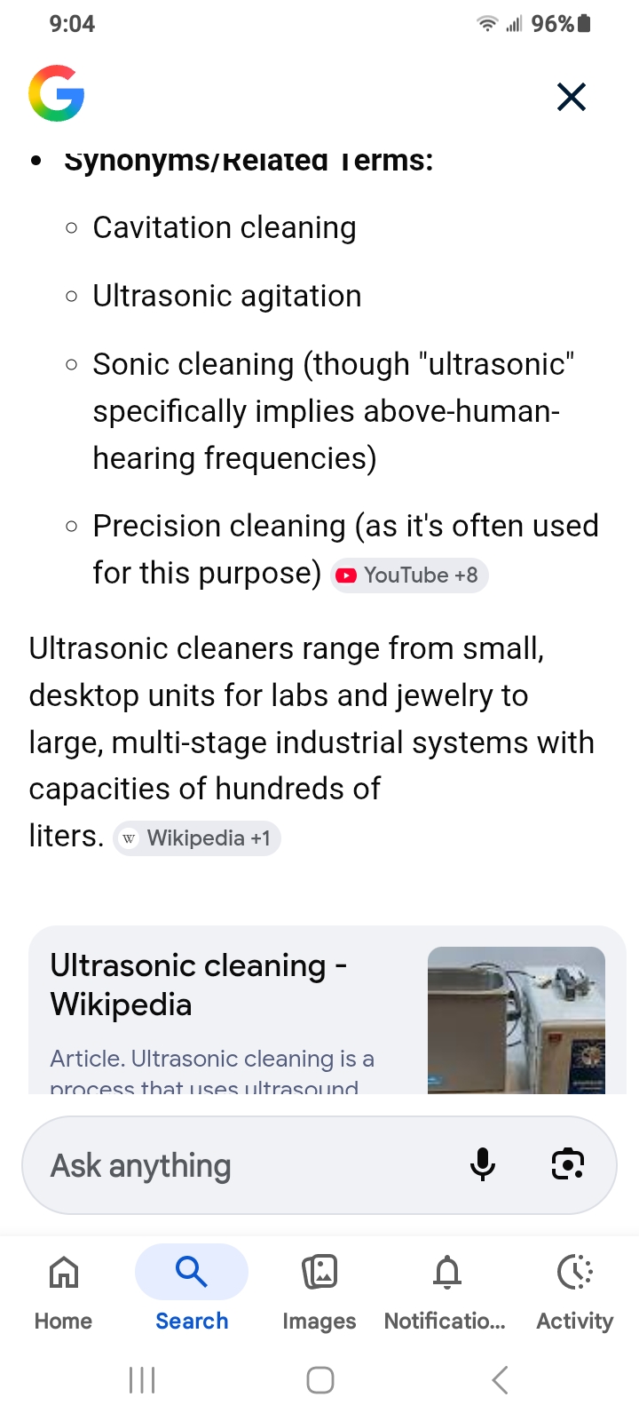

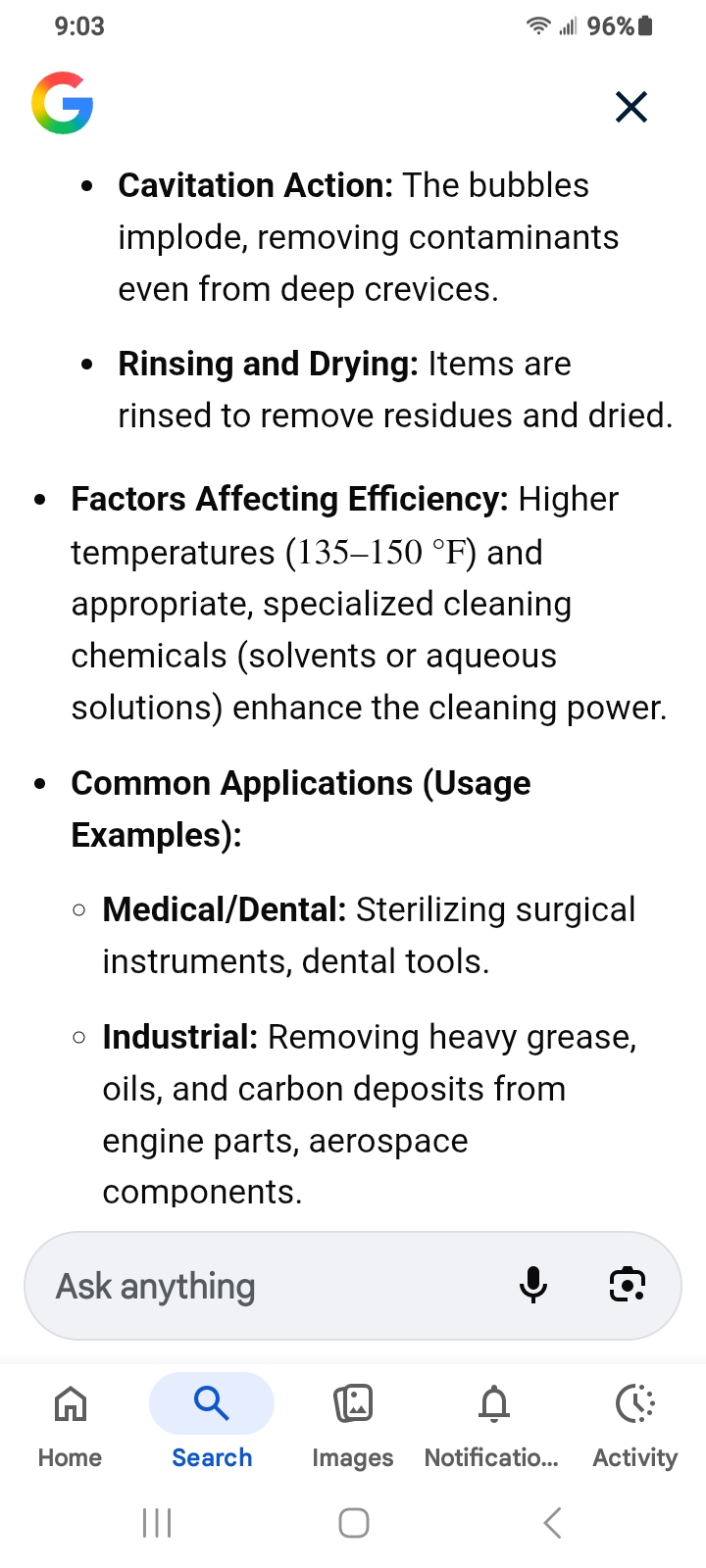

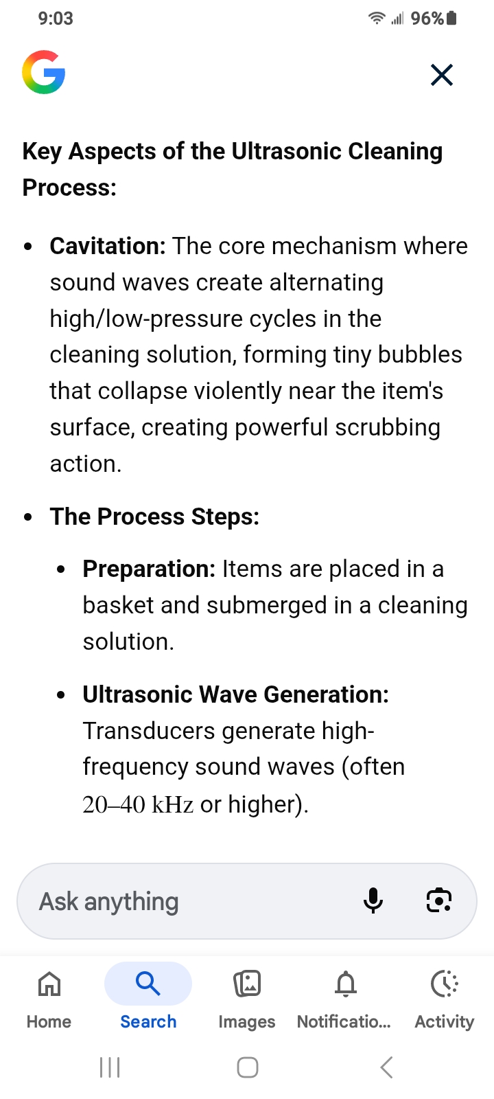

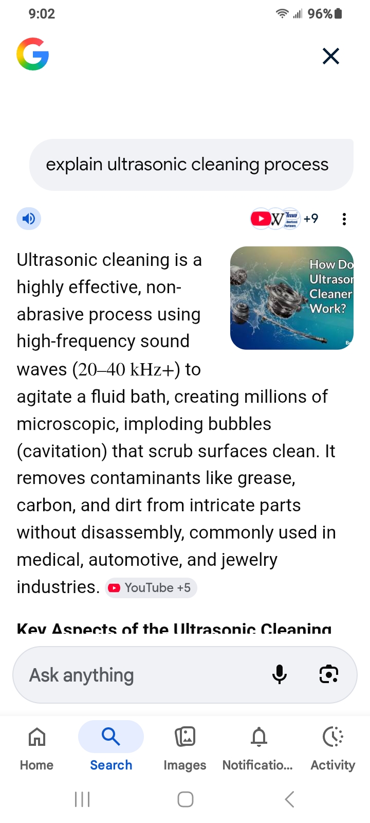

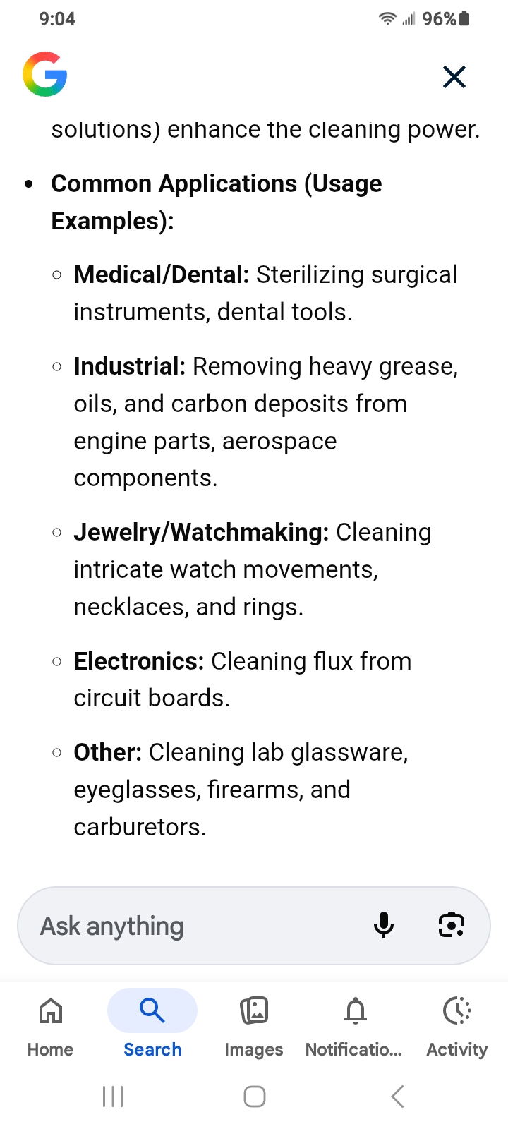

If you know what an ultrasonic jewelry cleaner is, what i have is an 8' 30 gallon ultrasonic jewelry cleaner. The front tank has the ultrasonic generator transducers the pink stuff is a mild detergent. The back tank is a rinse.
Screenshot_20260312_090253_Google.jpg Screenshot_20260312_090320_Google.jpg Screenshot_20260312_090335_Google.jpg Screenshot_20260312_090410_Google.jpg Screenshot_20260312_090420_Google.jpg
