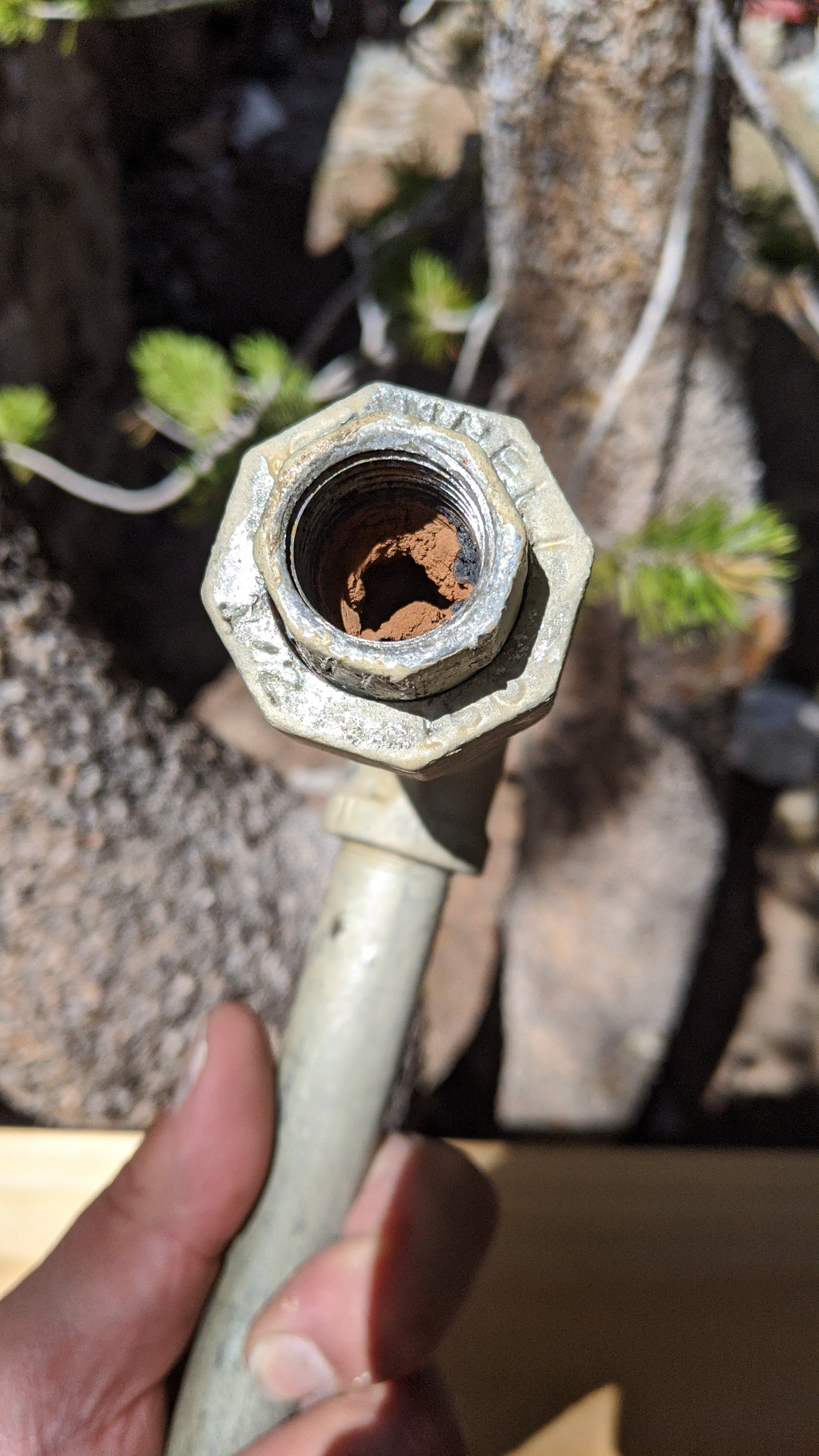

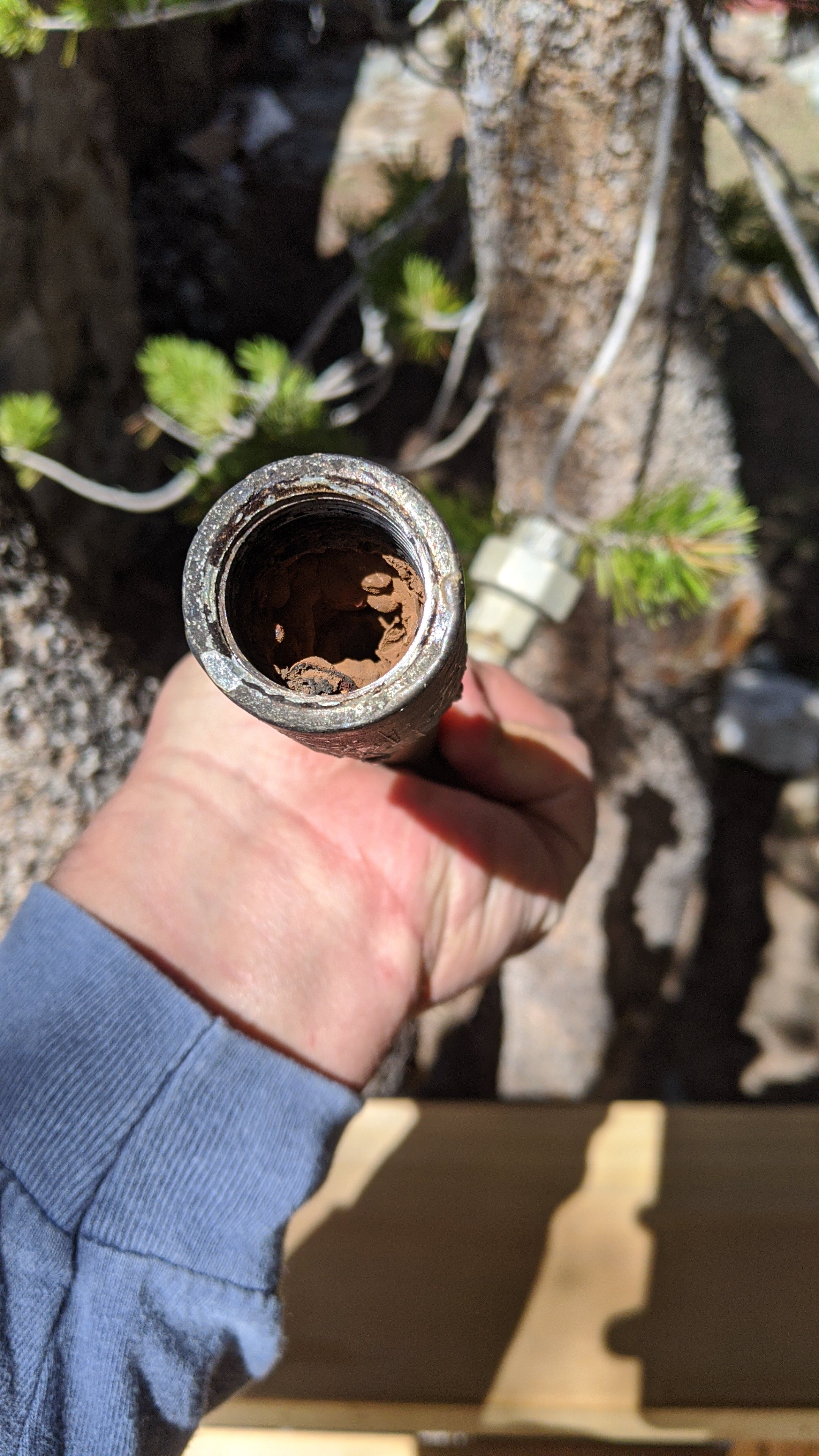

Cost and time will dictate the fix...
Plastic or stainless....
Scd 40, or for permanent fix, stainless...
galv pipes don't look all that different after 100 years of city water either
replace with PEX (poly)
like they use for well pump plumbing to house
"plastic is fantastic" ...and fo-evah

Galvanizing in water pipes has a rated lifetime of 50 years. Replace with same and you won't have to worry about again.
