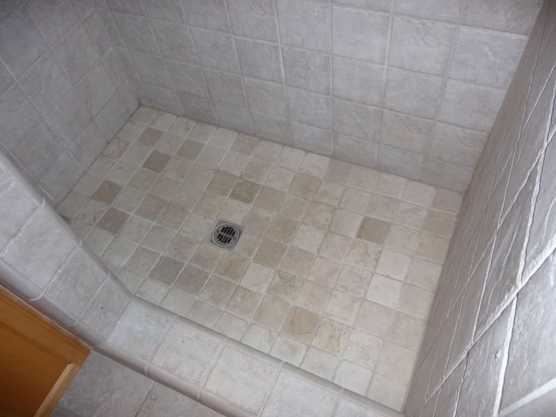

I did that shower and another tub (more pics tomorrow) in 2.5 hours for $715, including some grout repair and re caulking the tub.

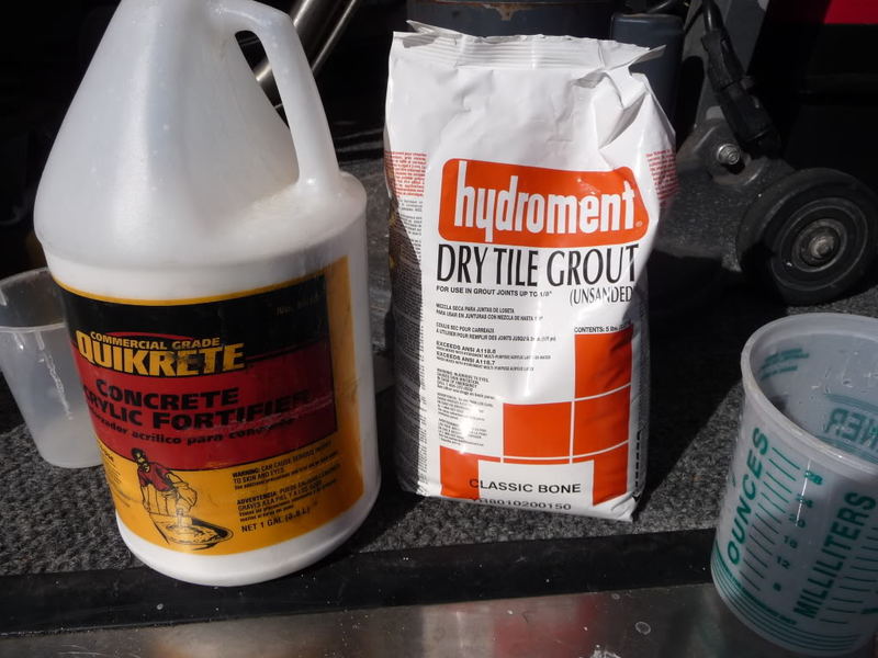

Al's non acid soap scum remover, Stonetech Restore(acid) five razor blades, a grout saw, a small grout brush, a pressure washer(your V and a HF gun), some cotton towels, the Acrylic fortifier and matching non sanded grout for repairing the cracked edges and a well formulated sealer.

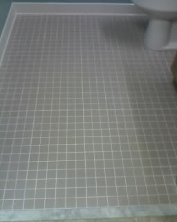

4 restrooms in a doctors office like this one 4 hours spinner tools grout restorer and sealer $850 ticket; nice!!

Mikey, I know that concrete doesn't stick to concrete. Does grout stick to grout. I worked for masons and had to apply latex adhesive to get concrete to stick to its self. Is there something in grout that makes it stick to itself.
Sep 7, 2008
3,797
How did you price it to come up with the 715 dollar ticket. Just curious. Are you pricing it out hourly or for each service?
116,133
Scuff up or dig out some old grout and use the Acrylic additive instead of water and it will stick
