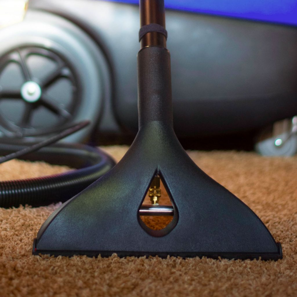

What do you make of this wand? It's on the US Products page.
116,140
They have three versions of it.
The 12" Triton, which has been discontinued

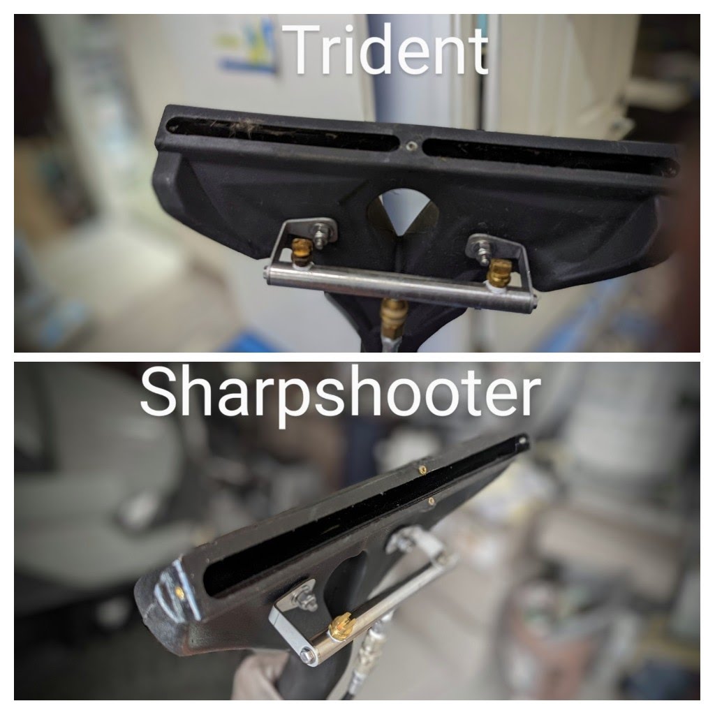

The 12" & 16" Sharpshooter, which Ill have Glides for very soon, ( that can be slightly modified to work with the Triton)
and a new dovetail ( think Evolution) mounting system that is being marketed as a Truckmount wand, that has yet to be named, but will come with GreenGides as OEM.

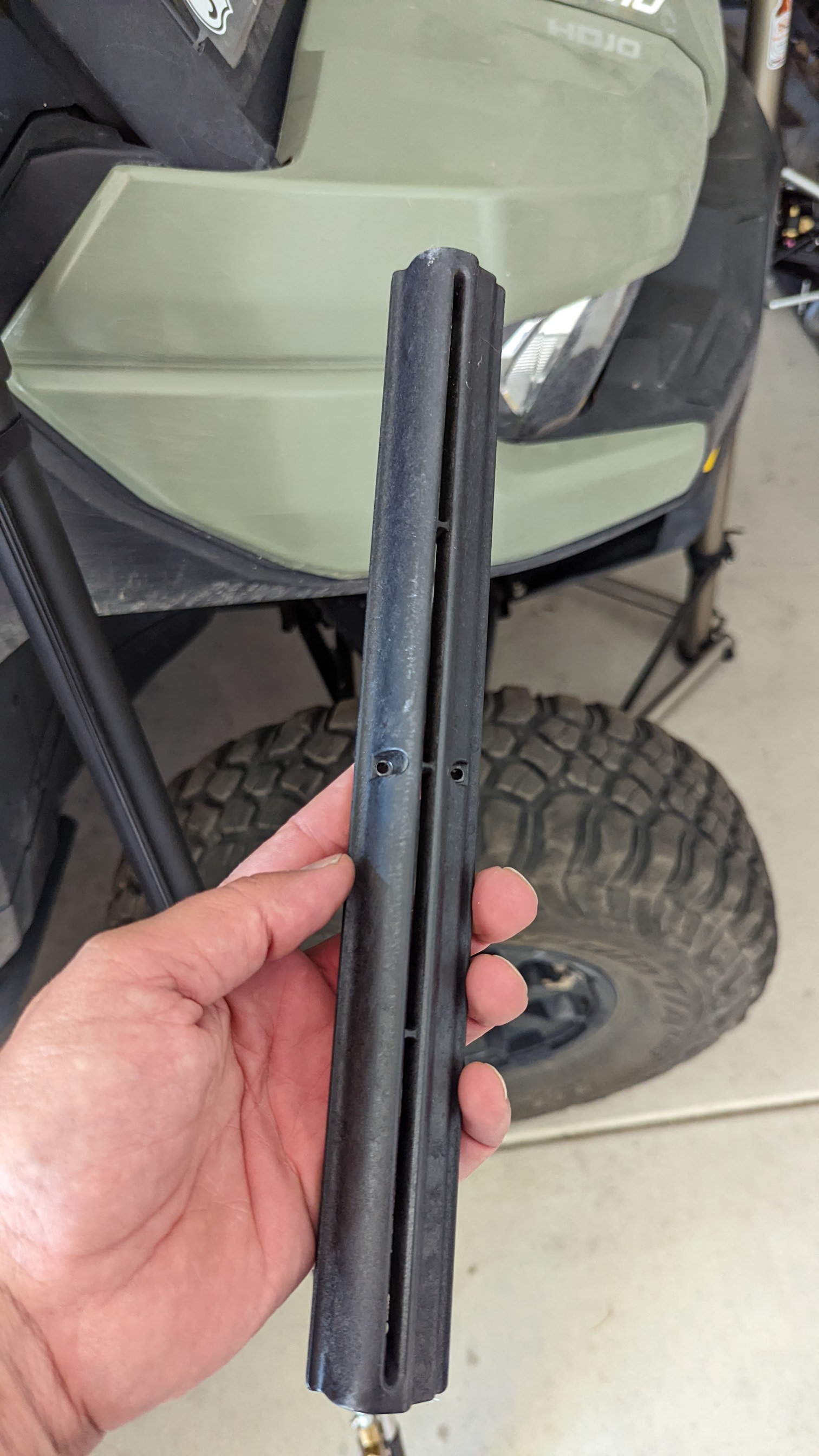

Ive used the 12" Sharpet shooter and it worked as well as any wand Ive ever used. After a few hundred feet I really started to enjoy the reach that a straight bend tube offers.
The stock black delran glides cause massive lockdown and chatter, which is not quite as bad as an Evo's due to the stiffening effect of that tear drop hole.

I'm speaking of the triangulated vacuum chamber.
IF the tube joins in a linear fashion, there is no better design.

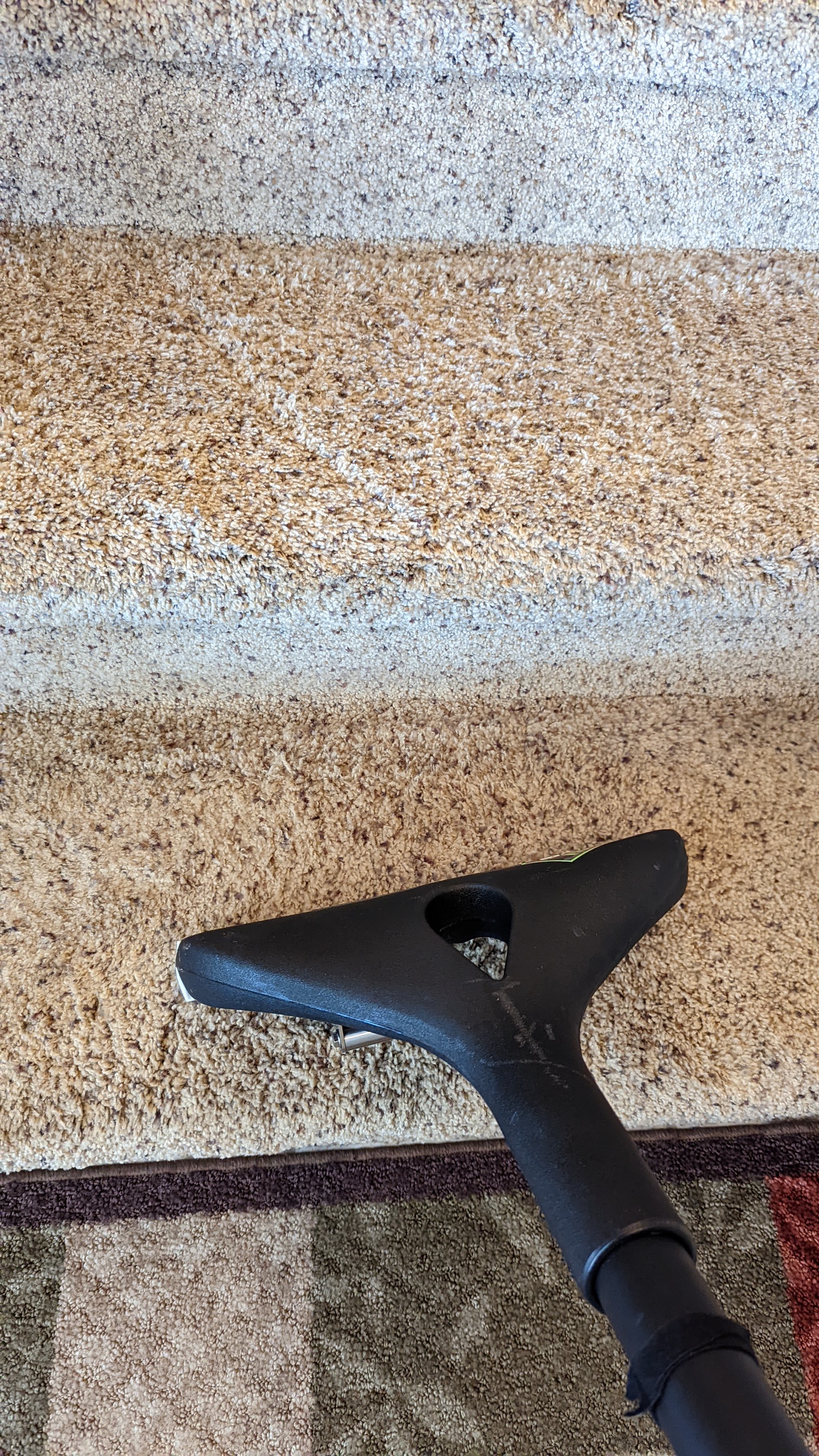

When I first tested the SharpShooter to see how my Glide functioned, I fully expected to use it for half a room and go back to my S bends.
Nope, instead I marveld at my 5 ft reach with no leaning required, vacuum was excellent and because there wasn't really any furniture to get under I ended up completeing the whole house with it.
The tear drop may or may not increase the speed of airflow but it certainly reduces the chatter of the Evo's, and unline the Evo's this wand cleans right to the edge with out modification.

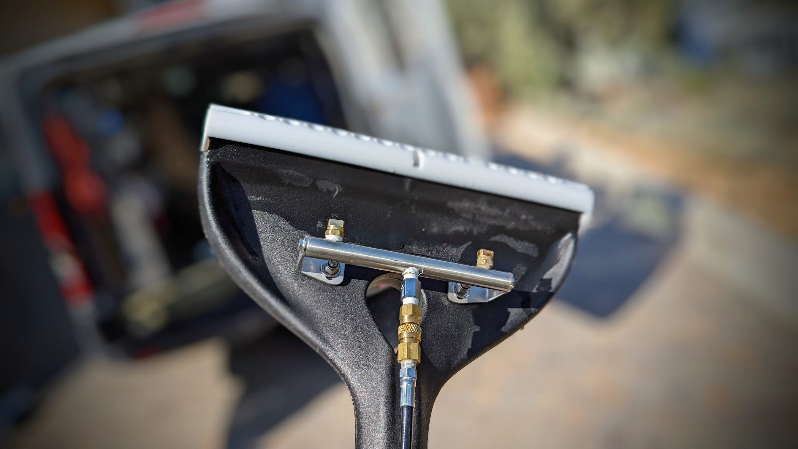

Evo Glides sell incredibly well, I have to pack up a Hard Surface Glide for a owner in a few minutes actually. New and old cleaners alike love these straight tubed wands for what ever reasons.
USP is workining on a new model that wont have the scews to mount the Glide (which will be OEM) but rather a familiur mountin system that will alow for very quick change outs to other style Glides.
