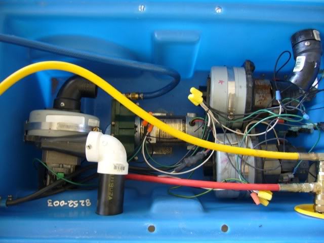

My burned up golden oldy Ninja - awesome vac and a great pump.This was the second one in the shell and the base had to be reinforced with a thicker gauge sheet of metal. 140 pounds, I'm glad I'm stronger than the average bear.
With another set of 2 two stage vacs ported on the opposite side of the lid. Both sets were in series, but the way the lid was ported, it ran the 2 sets as a parallel system.
General one one cord with low amp 2 stage and a higher performance 2 stage on the other cord. Same vac set up in the booster box, but that ran on one cord.

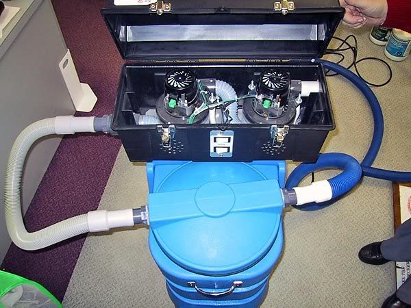

Borrowed this pic from Ted at Kleenkwip where I swapped an old PB Ultimate for the vac booster.

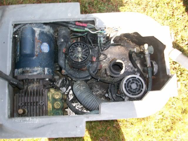

My toasted booster. I lost over 18 k on that fire. Van loaded to the brim with equipment. I got $3000 from insurance.
Upside- Plenty of flow and massive vacuum at my normal 35 feet and it could have easily run 100 with enough power. Performance second to none. The pump lasted through 6 sets of vac motors.
Downside. - Heavy, had to replace the rear wheels and axles a lot, had to be refilled once to do a 1 bedroom. 3 cords, but I had that figured out.
