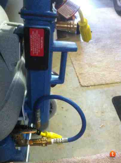

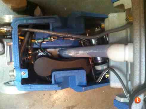

I liked the Edic for this whole set up.
Edic has two cords. If you dont use heat only 1 cord.
This one does not have Auto Fill/PO
