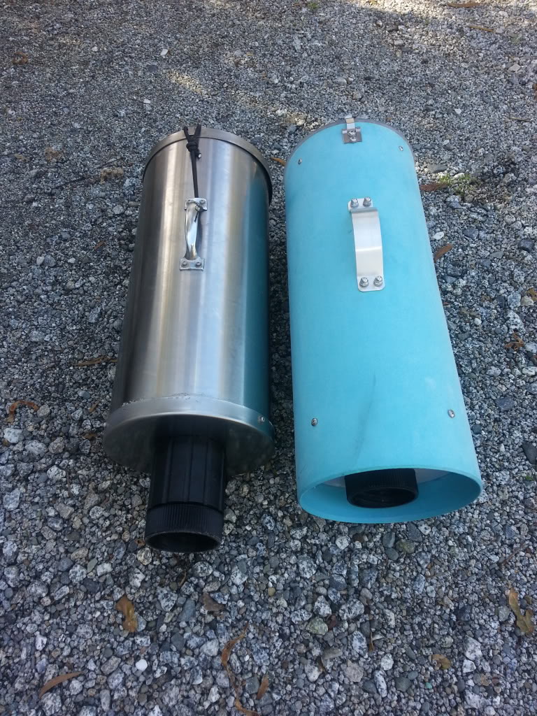

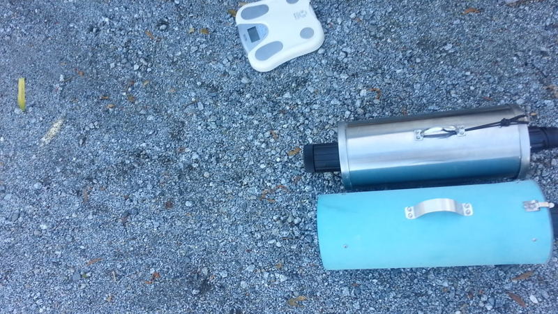

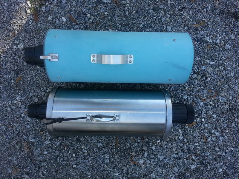

DV is shorter.
RC99 weighs in at 10.6 pounds
DV is 8.0

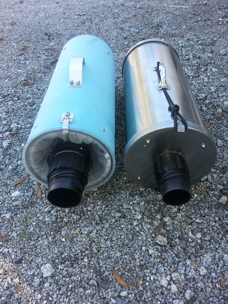

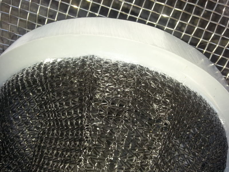

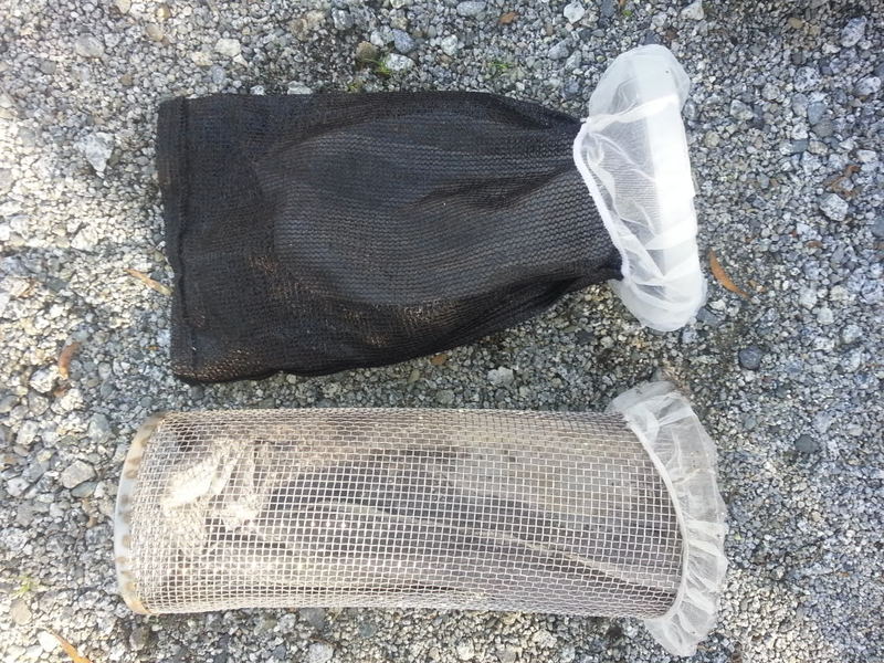

Screen Filter from the RC 99 fits into the DV better than it does into the RC, not that it matters, just interesting.

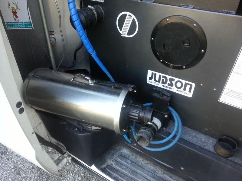

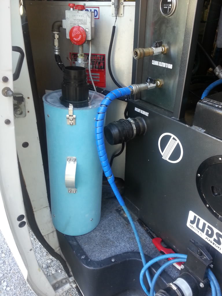

DV fits into tighter spaces better.

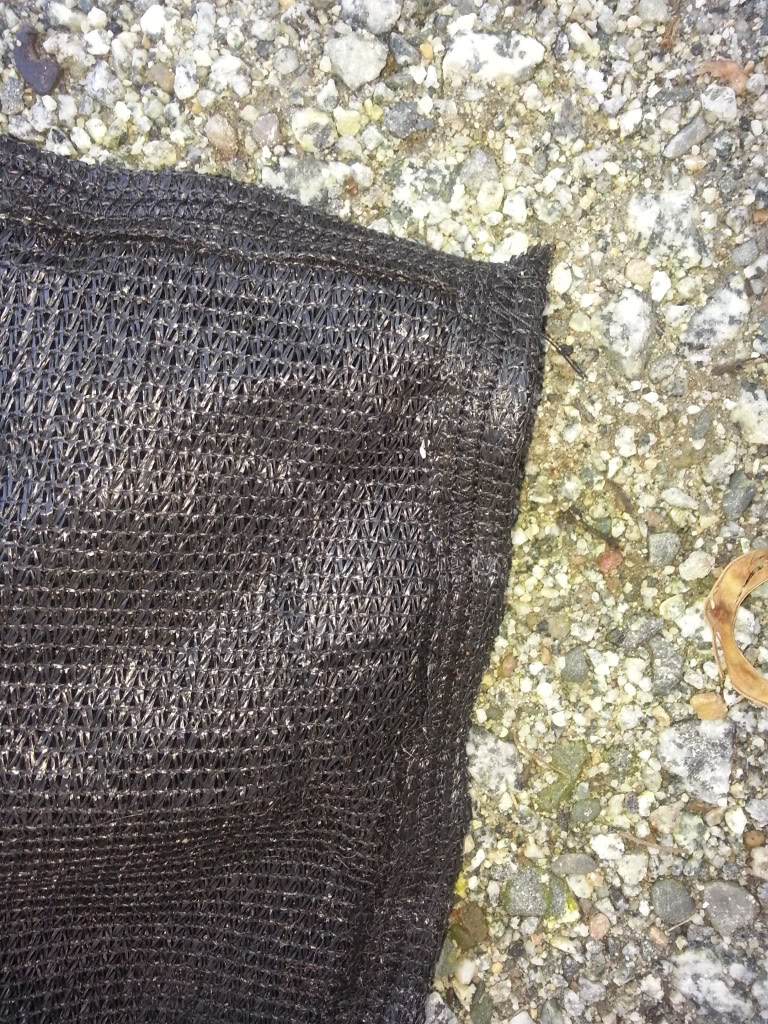

I'll speculate and say that the black bag may last longer then the screen as it is very well made. Do not base your decision on this observation.
I personally like the DV better because:
PVC will take a drop better
PVC does not need to be Sheila Shined every day to prevent fuglyness.
It does not leak the second the vacuum is turned off.
It's shorter and stands on end
The black bag, which I did not go into this knowing about, appears to be superior to the screen tube.
No goop
I don't have to suck c*ck to buy one.

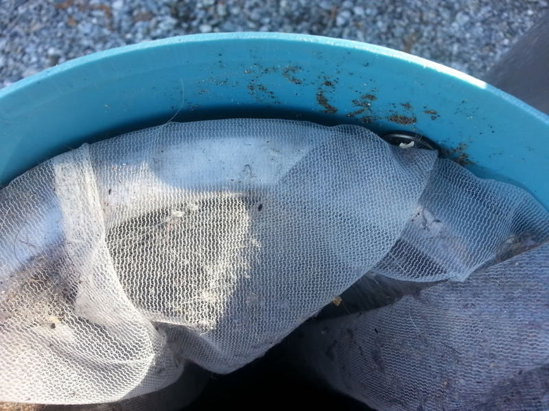

I have one of Joes, and a DV... Since Feb, so some things MAY have changed....these are just what I see on mine....
i am going to add 2 bits to this....been wanting to do pics and a video, just 2 damn busy...
Joes has a swivel for your connection on the back (female) The DV Does not
besides fitting better, the DV has a nice smooth edge that wont rip the (as I call it) the goodie bag....Joes does....from what I hear Joe has fixed this issue with a rubber ring around it...but i havent asked for it, nor seen it....

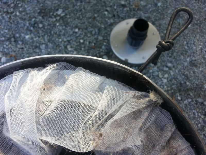

The Dev collects hairs from pets that go through the goodie bag, and fine silt which can reduce air flow and needs to be cleaned out with a JET on the end of a fitting, not just a simple rinse.....the metal basket also collects "stuff" and doesnt rinse out as well....BUT i think you can burn it off when dry....though never tried to yet....and it does NOT restrict flow.....
the DV stands on end better, as shown in the pictures, which is easier to change bags...but not a huge issue....
and they both leak...PERIOD....once you release VAC, even with the "tip at the end" method.....they both still loose that TIGHT vac seal and leak a little...
in the end they are both about the same....small little differences, some that make you nuts, and others you can live with.....
but neither is the PERFECT filter....but a lot better then any others out there
All filters collect hair. That's what they are supposed to do. Neither of my Dev filters have a metal basket. They both have cloth bags. The bags collect and trap debris to the point that I don't have to clean out my waste tank but about every month, and it never stinks like it used to.
