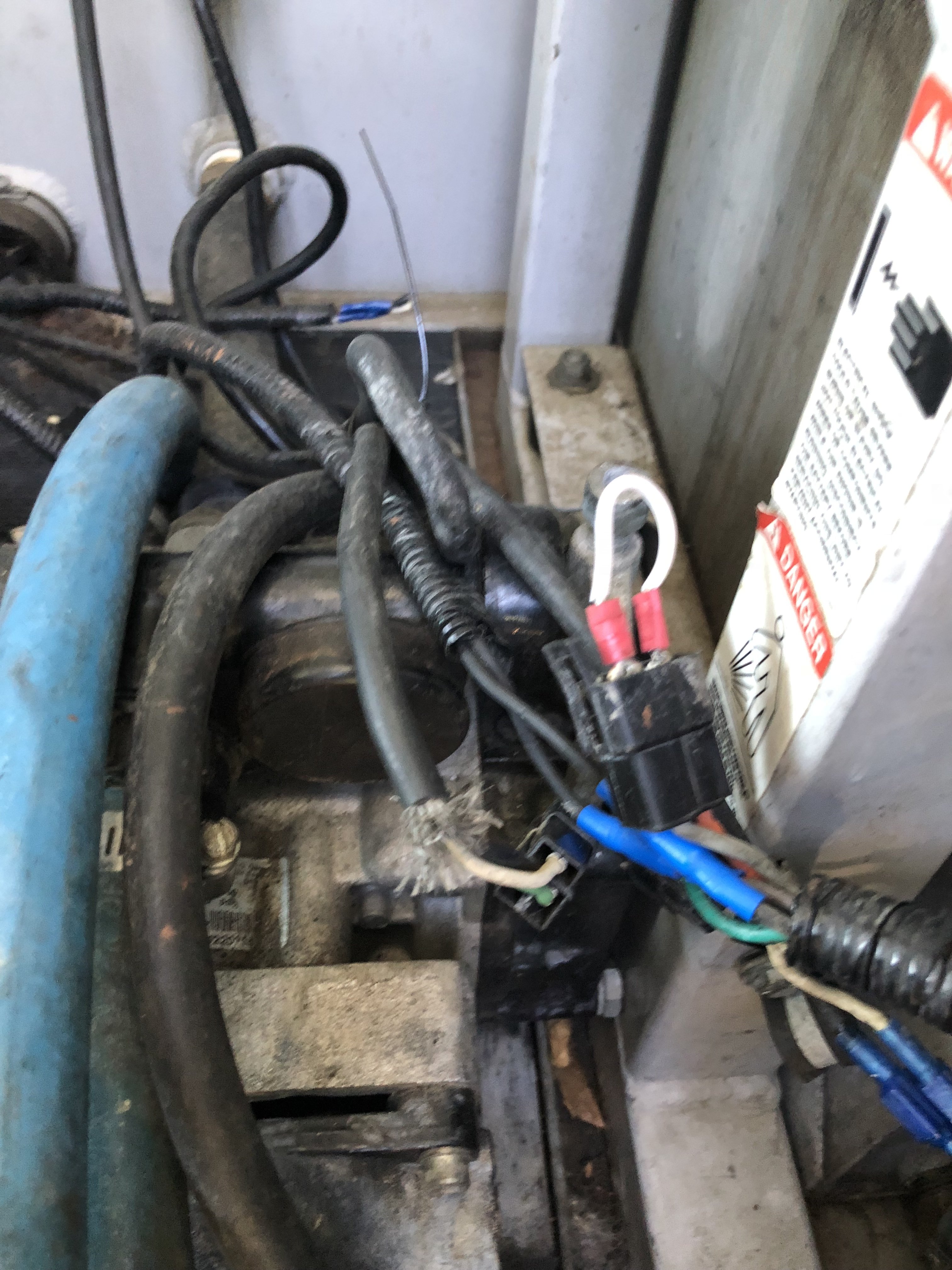

I ended up swapping trucks with Phil and trouble shooting his truck at home!
Changed fuel filter jump started it ran for 2 minutes and shut down!
I finally bypassed the shut off float switch and got it started!
Let it run 20 minutes and went and did my last job!

So happy that the loop wire helped me diagnose the bad float switch!
11,297
There’s no indicator light to tell you why it shut down?
No it’s a crap shoot!
But it’s usually a small list!
Waste Tank full the truck is low on gas
The radiator needs topping off
Then you start to use the jumper wire to test the waste switch!
The 570 did away with the low pressure sensor so it’s a little easier to diagnose then the 405 was.

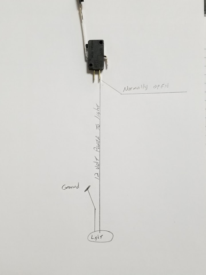

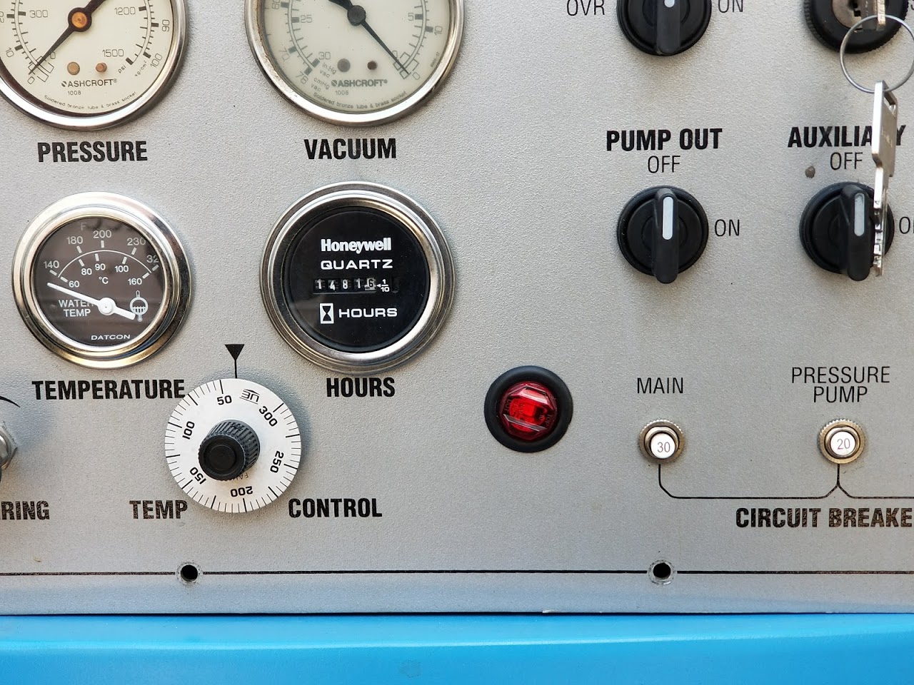

I added a light to mine...so if the tank gets full it will come on....with Jr out there using it ...it has saved me a few times....
here is how to wire one up....
Reactions: SamIam and Nomad74

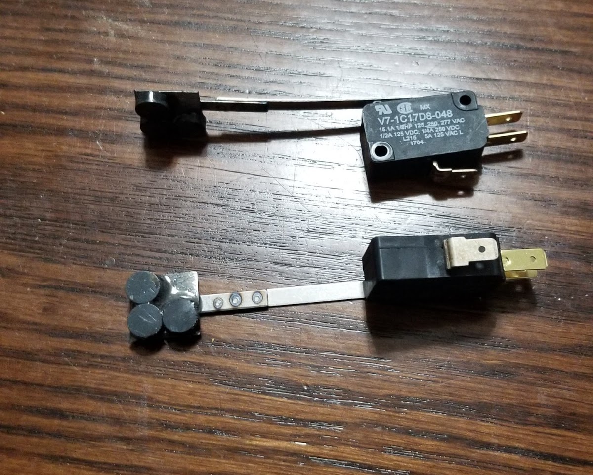

My Harwig float on my APO went out AGAIN!!!! The relay works fine when I pinch it but when i move the float up and down nothing happens. Its like the magnets just decided to stop working.
Jim Martin
10,878
Arizona
Jim Martin
if you can push the microswitch by hand and it is working....then I would check and see if either you have something stuck in the pivot of the float and it is not coming up as high as it needs to....or..the float itself is filling with water...2 good places to look before replacing the switch.....
Reactions: Nomad74
24,044
Ill do that today.

Glad you got it diagnosed! It is never a good idea to leave a waste tank float bypassed. It does get the machine working in a crunch, but you also have to be VERY careful not to suck water through your blower.
Well, no dice :( that dang float just gave up. Guess I'm ordering a new one.
