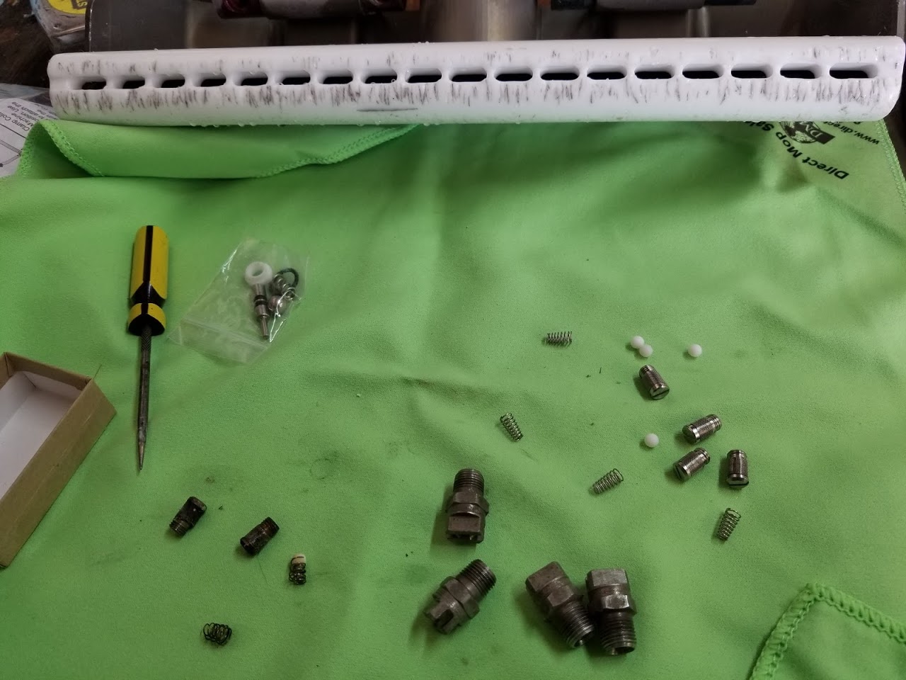

I’m tired of those stupid jet filters failing
14,097
i took out the wand jet filters, upped the flows from 1.5 to 2flow jets (making my wand 10flow), and installed an in-line filter after my soft touch valve, as well as before like always

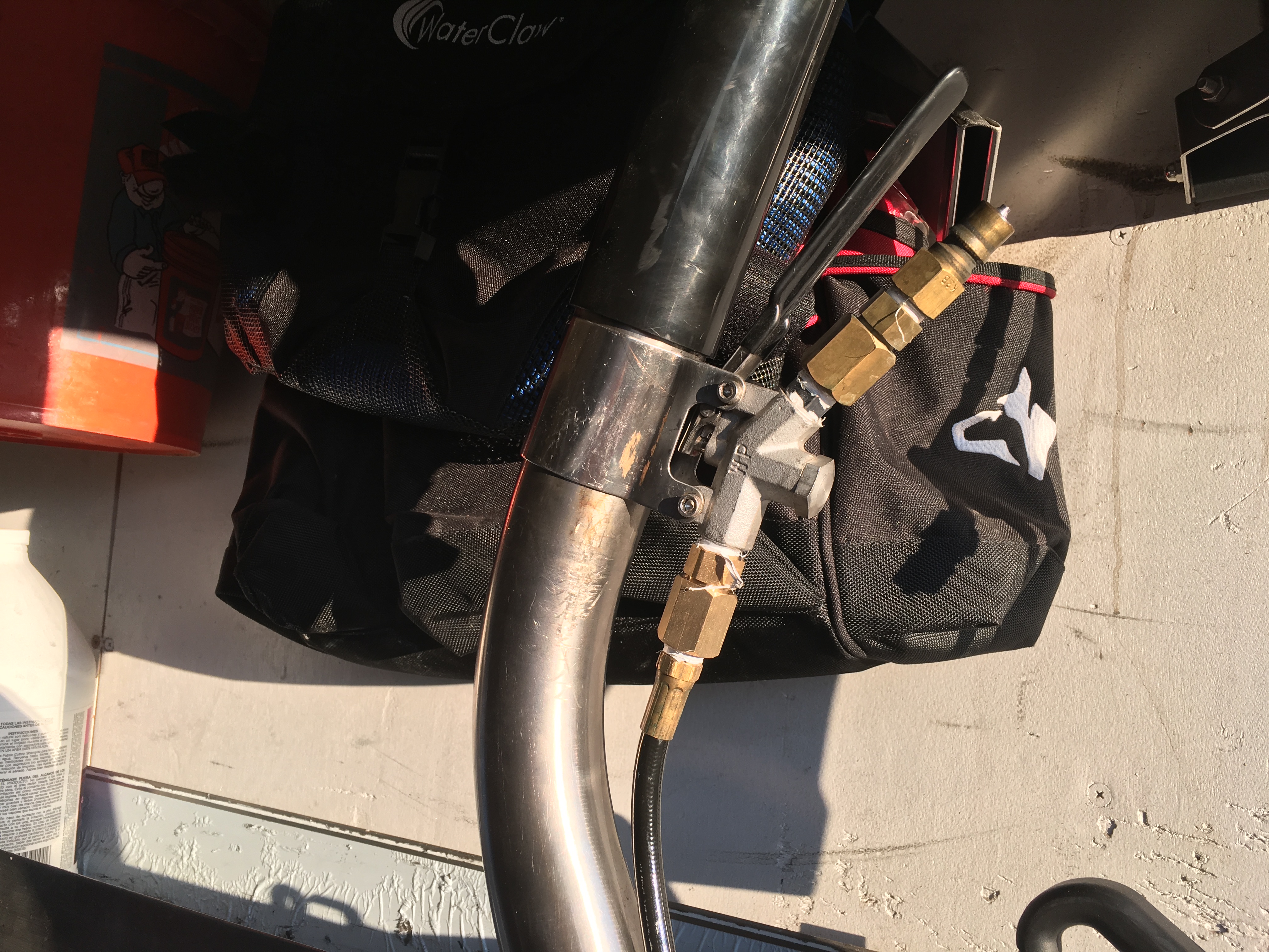

I use a 100 mesh filter before the valve on all my tools. Prevents debris getting into the Jets and easy to clean. Who the hell wants to clean 4 filters on a 4 jet wand when you could clean just one?
Do you have a picture? Sounds like a great idea!

I know, I know. The wand is looking rough.
But I was assuming that since the jet filters aren't doing their job at catching all the debris, then maybe another inline filter will catch the junk. That's another reason why I bumped up the flow on my jets also, so the hole will be bigger.
And from the ridiculous price that those stupid little filters cost, they're a ripoff.

I always had the filter that is attached to the male QC. That's why Im thinking that it might be coming from the orings in the wand valve.
How old is the valve and does it leak? I would replace it if you feel the oring is bad.
