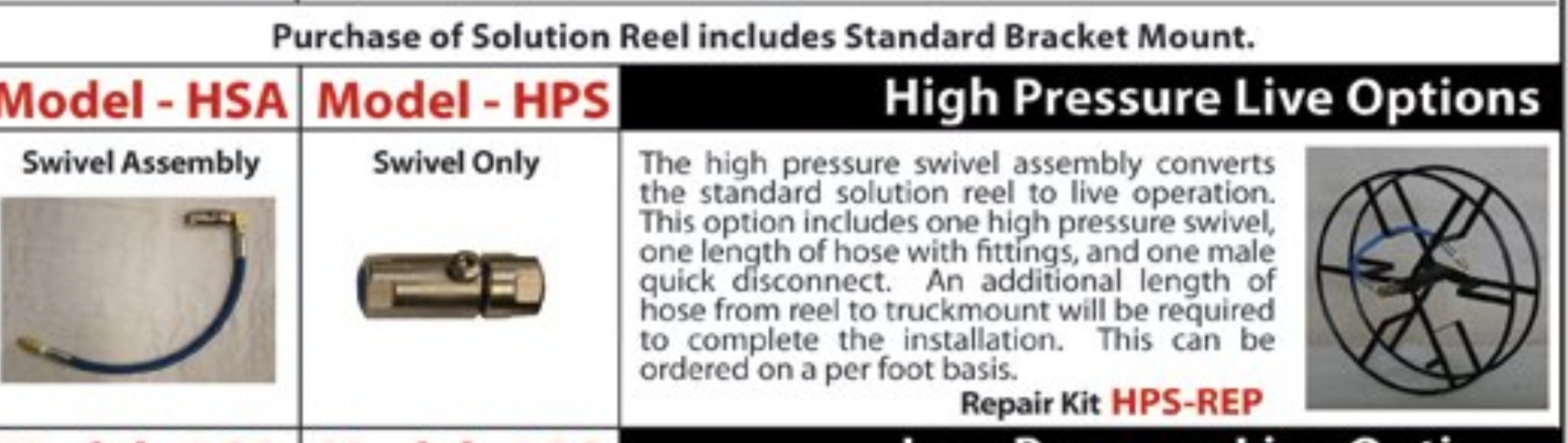

I'm considering converting over to live solution hose on my reel
14,091
My main concern is how often do you replace that 250-350ft of hose? Because I replace 1 section of my hose 75ft once a year. If I have to replace all that hose every year... no way
And where can I get the hardware to convert it without getting ripped off $$$

300ft in multiple 75-50ft sections that I have to disconnect from the reel and connect to the machine. I'm wanting to do away with all the crimps and QR's and just run one long 300ft. hose on the reel and have the hardware to make it a live hose always hooked up the machine.

Matt, this is how I do it and it's not a problem. I Have two lengths of hose on my live reel. the first section is 150' then the second section (Lead line) is 100'. Normally 10 wraps around my arm is enough to do 95% of my jobs.
That reminds me, I need to rebuild my Super Swivel. It started leaking yesterday.
27,863
That's why I coil and hang my hose instead of putting it on a reel. My lead hose, I order 125 ft. Gives me room to cut off ends periodically when they get weak. It is so simple to pick up a coil of hose and my inline sprayer and walk into a house. I have a couple of 50 ft lengths to add to it if necessary. The longer your hose, the more heat you lose. I don't have any houses where a 120 feet doesn't get me out the door without having a hot qd on their floor.
Just don't leave it on the spool to build heat and cook your hose. It will last fine if you unspool most of it each time. So just don't stick it all on the spool, hang the extra that doesn't get used that often. Make sure that section also has a ball valve so when you need to use it, just pop it on the front end.
Rokan had a conversion kit at one time.
