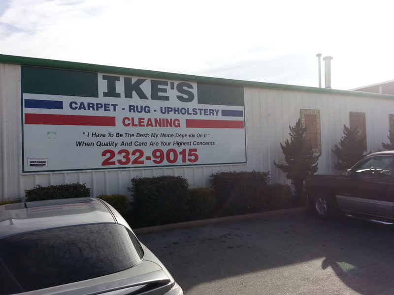

Stopped by Ike's in Greenville to say hi..
He has a huge shop with room to park 4 vans inside and pump out a lot of rugs..

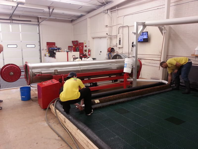

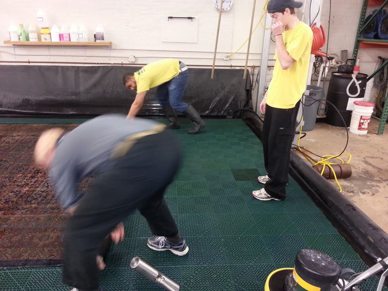

After dusting, 175 scrubbing, both sides and a spraybar/wand rinse rugs are spun and rinsed until the water runs clear..

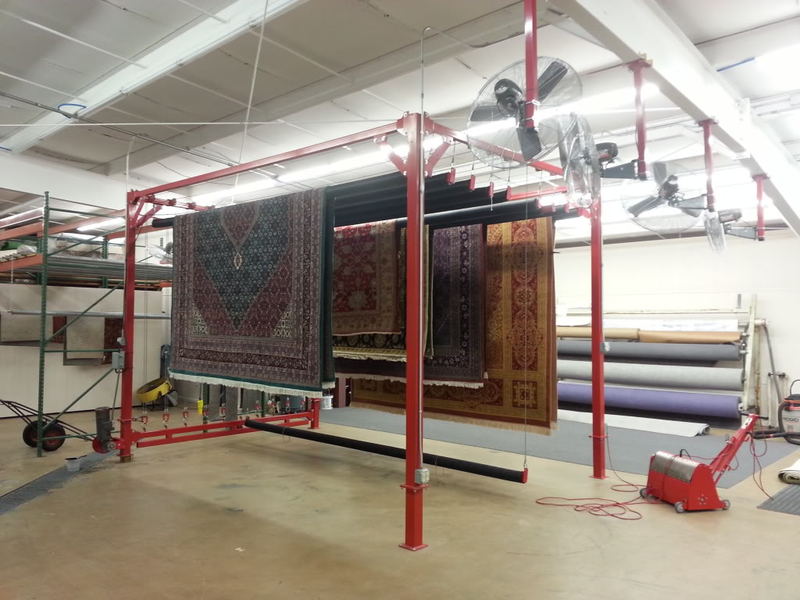

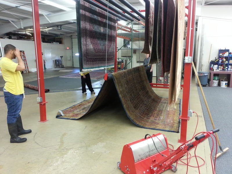

Then hung out to dry

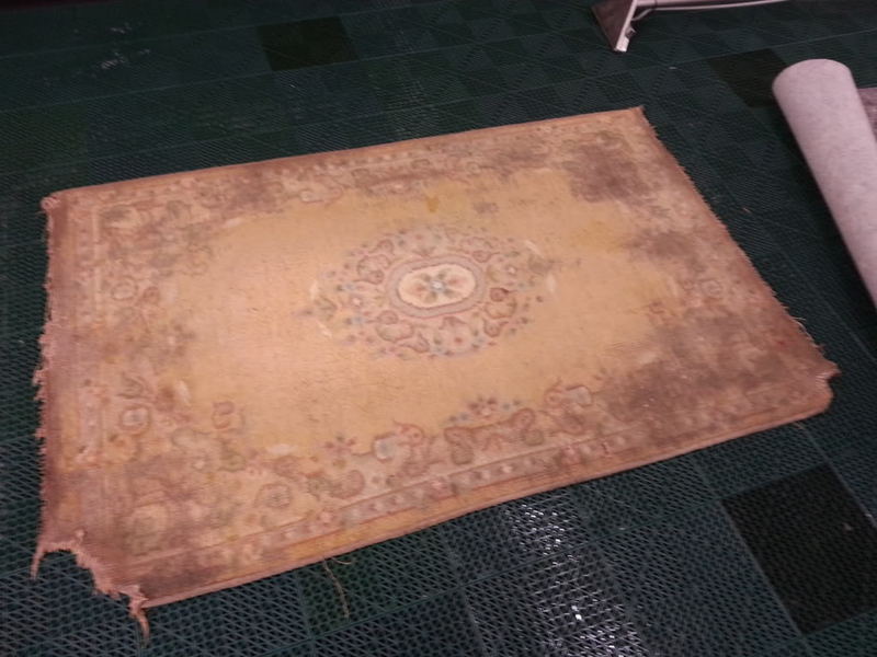

This beauty came in that day...

Thanks for the pics. I like using the turtle tile. My liner and tile is white though. It''s nice to see the dirt as it flushes out. The stainless centrifuge is great. It will never rust. I expect mine to outlive me and maybe my son as well.
It's not easy to make those cylinders. Clark bends and welds stainless plates into cylinders. He has an enormous lathe that he puts that inner cylinder on and uses it to machine it so it is round. Then it has to be put on a machine to balance it just like a huge tire balancer. Drilling holes in stainless that thick is not easy either. There is a lot of cool engineering that goes into being able to use stainless.
