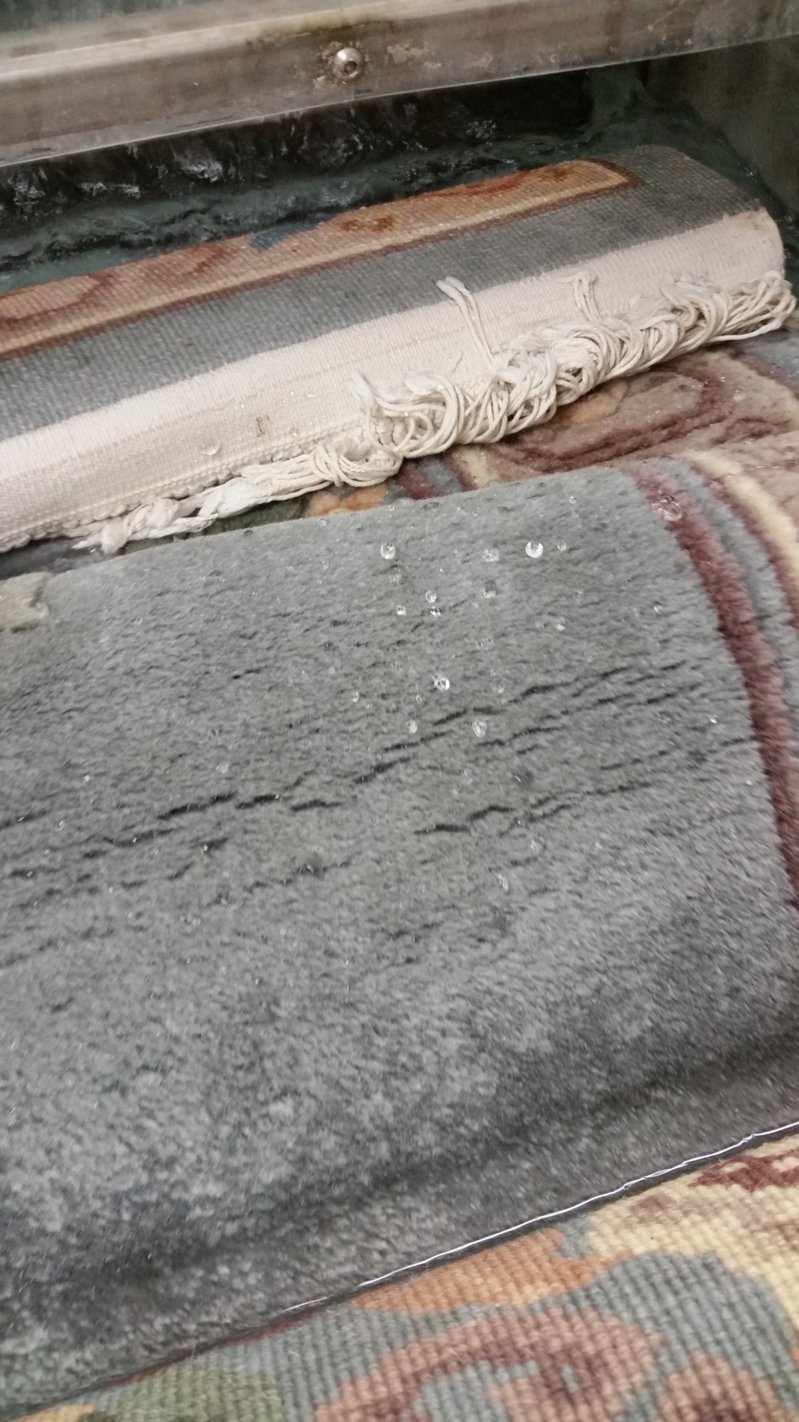

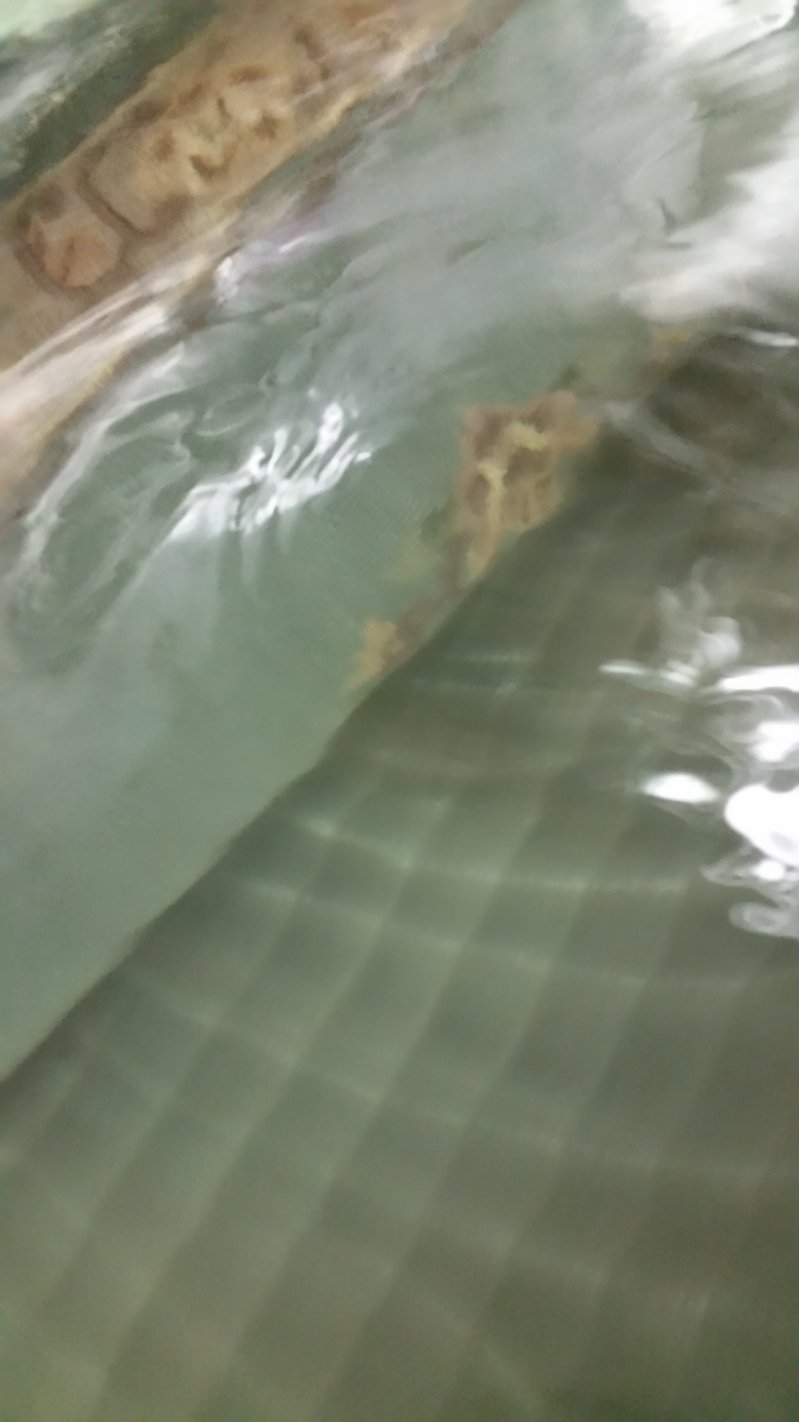

I was even amazed with Fiber Protector

That's because we've seen it all, done it all, and had it all done to us...I'm the same, and keep testing every protector I can get my hands on.
This is the way I have tested protectors the past year, and its something everyone should do:
1. Apply it to a fabric or rug that's new
2. Put something difficult, but not impossible, to remove on the treated fabric, like vegetable oil (not many people spill vegetable oil on fabric...but its a good "push it to the limit test")
3. Rub it with a clean white cloth gently, since most customers won't blot.
4. Wait a few days....like the time frame of a cleaner being called to follow up.
5. Attempt to remove the spot. You'll usually have to use a series of products, but the oil will come out.
6. Retest the area you spotted after its dried, and draw your conclusions.
Another test:
1. Precondition a dirty fabric with whatever you need to use to get it clean.
2. Rinse and extract like you usually would.
3. Apply your protector.
4. After a couple of days of curing, compare its ability to repel water and oil to the new fabric you tested above, and draw your conclusions.
