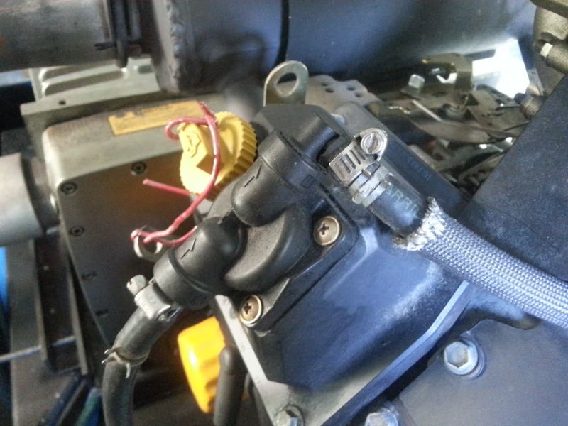

Back to the subject at hand. After discussing this with Bucket Head, I realized that I probably was having the same problem with my Kohler 27, so yesterday while watching my son work, I decided to go out to the van and see if I could see some oil puffing out from under MY rig. What I found, when I got to my van, was my oil cap GONE and my van spewing out oil all over the inside. After searching, I found the cap under my hot water heater, and determined I had enough oil in the motor to finish the job. It took us about an hour to get all the oil spray off of all the interior surfaces of the van.
I was ticked at my son, because I blamed him for the problem. The reason is I had instructed him to alway check the oil before cranking the van the first time every morning. So, I figured he has removed the oil cap by mistake, thinking it was the oil stick cap, and then just forgot to put it back on when he realized his mistake.
Well, I was wrong! Because, we were cleaning this morning and I went outside to get the upholstery tool out of the van and I smelled buring oil before I even got to the van. The oil cap was off again! And, this time it had been off long enough to REALLY screw up the inside of my van worse than yesterday! When I put the cap back on, I noticed that it wouldn't come to a stop when it reached the seated position. It will now just keep turning.

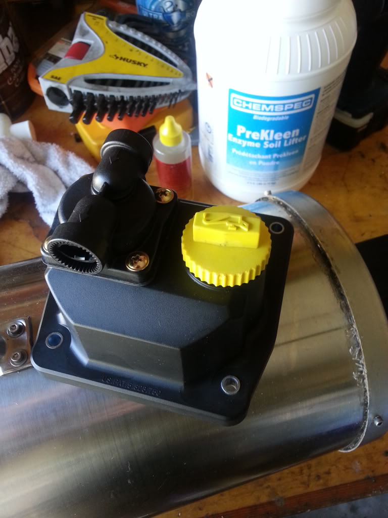

Marty go on Kohler's website, you should find the part there. If not, just call them and order it. They will sell it to you.
Mike, the heater is not causing your problem, the o-ring on the cap is wrong and kohler knows this. I had the same problem both you and Marty had. I just put a thicker o-ring on the cap, took off the valve cover, cleaned the seal and reinstalled.
The o-ring is the problem, nothing else.
Also, the worst thing for these kohler engines or small engines period is the ethanol in the gas. If you notice when first starting your engine, moisture will blow out the exhaust. This will ruin the engine soon or later. To prevent this, add stabil to your van gas when you fill up. Cheap insurance and will prevent premature engine failure.
Marty,
The manual shows the same part for your engine...assuming CH740 (marketing base)
Complete valve cover with fittings/cap:
kohler 24 559 10-S
Cap and o-ring kit:
kohler 24 227 02-S
O-ring:
kohler 24 153 32-S

I went to my small engine mechanic on Saturday and had him install a new o-ring on my cap. While I was there, I had him put a new washer in my hose end sprayer too.

Actually, I went to my small engine shop to see if my valve cover gasket was the same as yours. It is. So, I will order that cover tomorrow. Mysteriously (I think my son was involved), my oil cap now spins on my cover and won't seat down to seal. It just started it this week. I think after the first time the cap blew off this week, my son probably tried to tighten it down and broke off one of the tabs on the cover. So, I need more than just an o-ring.
