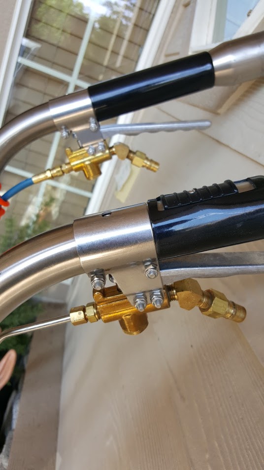

I sure like this valve

The hanging bracket DOES NOT MOVE unlike the cheapo Chinese hangers, the valve has a nice soft snap to it even at 1000 psi. No rubber grip to come loos and lose. Ergo lever feels real nice.
Just don't slam it around as I imagine the pop meter lever could snap.
Not too pricey..
Ive been using it for 5 plus years on our POMF Hard Surface wands with ZERO issues and for 8 months on my Mach 12 with no issues, and now on my SS12..
I'd like to see it on the Devastator...

That valve is bullet proof. I was all about Soft-touch and usually had to rebuild them every month or so. This thing just goes and goes with no problems whatsoever.
I would really, REALLY like to see it on Tom's wand.

I will call PMF today and ask them to bring some down to show for me, if they can, along with some extra jets.
As soon as this is perfected I will be ordering... Did you change the handle... thicker?

So you have to change the hanging bracket?
Will the bracket fit a 2" tube?
My soft touch valves have different mounting holes.:headscratch:
