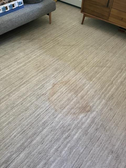

It's probably just some left over residue from the customer's attempt with their magical product under the sink. I would go back and do just an acid rinse over the spot with about 300psi pull back rinse only and leave a fan behind. I've cleaned several homes with the old jute carpet backing and was successful.
And I'm assuming the carpet you're cleaning is wool wall to wall also? If that's the case, then it's harder to rinse out the customer's dried cleaning solution since the fibers are absorbent, unlike synthetic carpet.

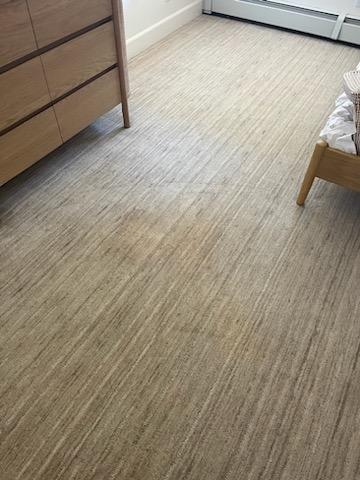

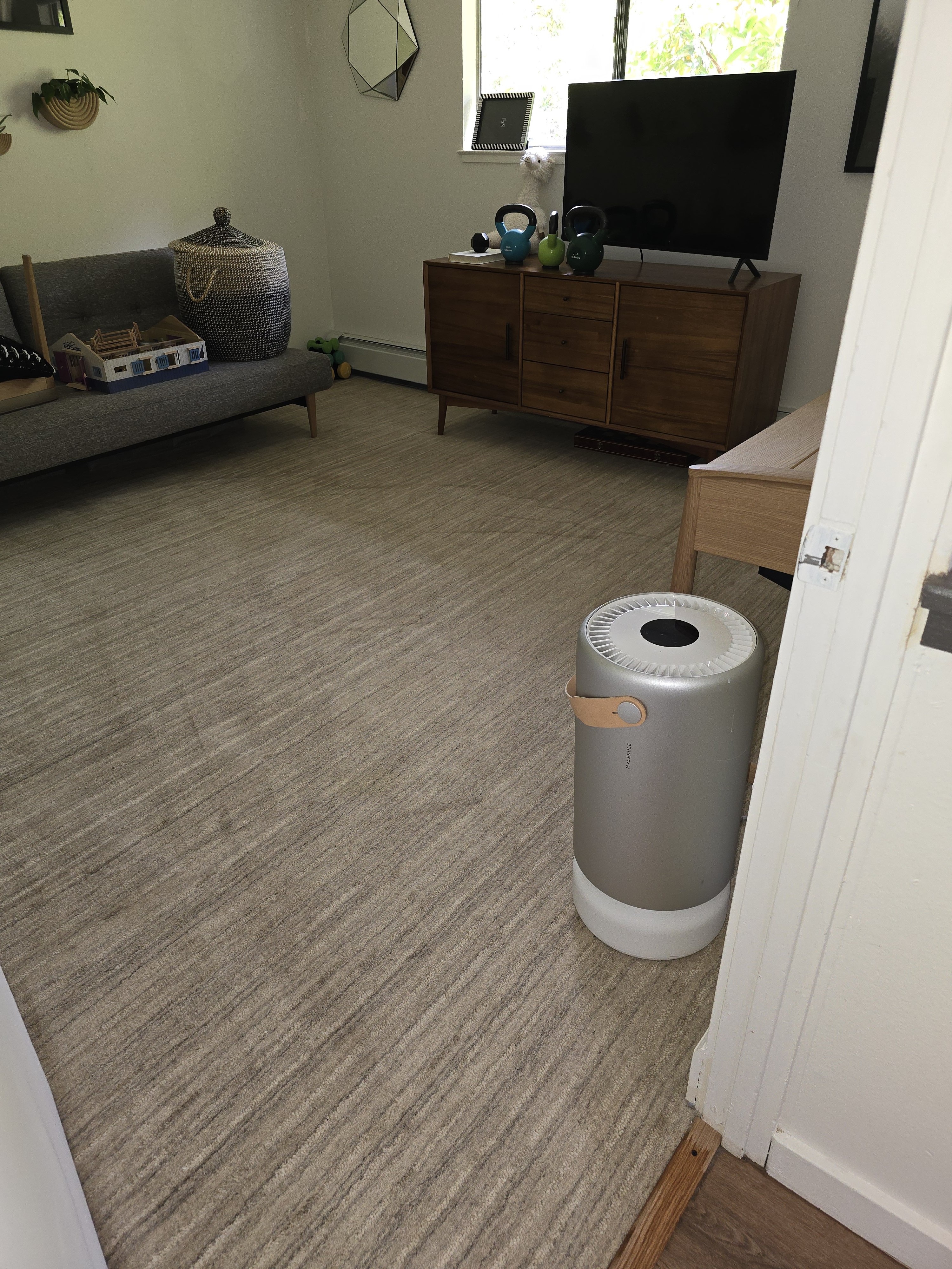

The 1st two photos are after it dried and pretty much same before the cleaning. The last is just after the cleaning. I'm just concerned about over wetting the jute.

Very nice to know this going in. Earthweave carpet is very prone to massive shrinkage if it gets too wet. I've seen it shrink more than two feet over a water-damaged 20 foot installation. (It's difficult, but it can be restretched that far. You would probably have to prove it to the installer as I did.) It also has an adhesive that can wick color that looks like your stain, may go away when rinsed, possibly can be removed with a strong solvent, but may still comes back as it dries.
You could point the customer back at the seller, but if they're like our local boys they don't know much about the product.
Earthwise recommends Host only, if that tells you something.

I would give It a few days to dry, then mist and vacuum.
