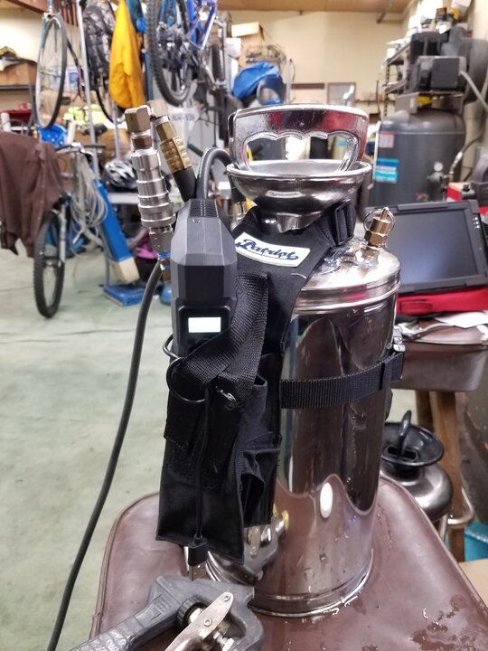

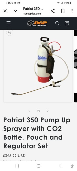

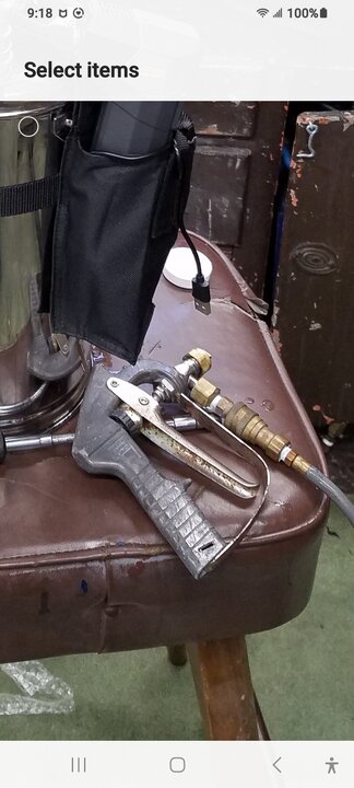

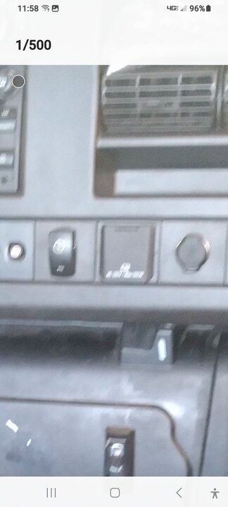

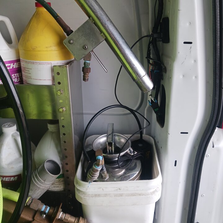

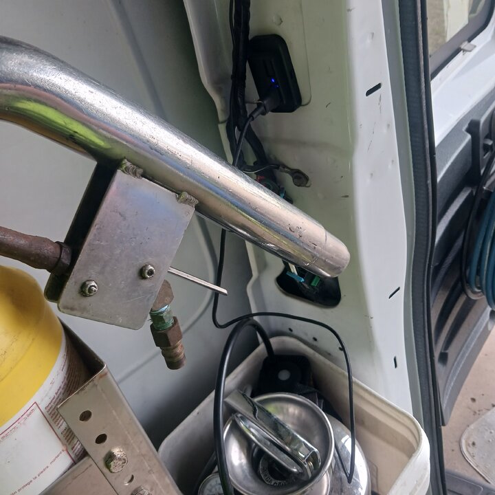

I've got a bunch of co2 tanks from my paintball years, and I can fill it myself also. That's a good ideaI built mine . Using a longgray 1.5 gal stainless pump up a kleanrite inline quick connect filter 10' hose and gunjet off my hydroforce sprayer and a rechargeable air compressor from Costco. The compressor in in a bag i bought from patriot sprayers. They sell a sprayer that uses a paintball gun co2 bottle to maintain pressure. been using it for yearsno problems even have a dedicated charging port built into my truck to keep it charged i like the patriot sprayers idea of constant pressure but there's no place close for me to recharge the co2 cylinders otherwise i would have bought 1 of them with a spare bottle and modified the hose. A friend of mine stains concrete and uses um and said that the patriot sprayers are expensive but last forever with little or no maintenance . I got about 200.00 in mine

Thanks hope it works for ya. I would like the constant pressure that co2 would allow. As it is now i set the pressure at 60psi and when it drops to around 40 i have to hit the button on the air compressor. Look up patriot sprayers you can just buythe pressure regulator and bag and hang on any sprayer that has a Schrader and relief valve like the longgray.I've got a bunch of co2 tanks from my paintball years, and I can fill it myself also. That's a good idea

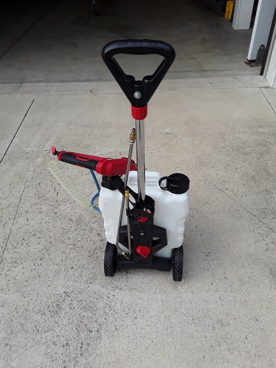

Does the corded multi-sprayer spray more powerfully than the battery powered multi-sprayer, or are they about the same with output?I like my corded multi-sprayer. Puts out the right volume for me

The Multisprayer with the new Milwaukee lithium is great. I believe the battery versions are 50psi and the electric is 70psi.

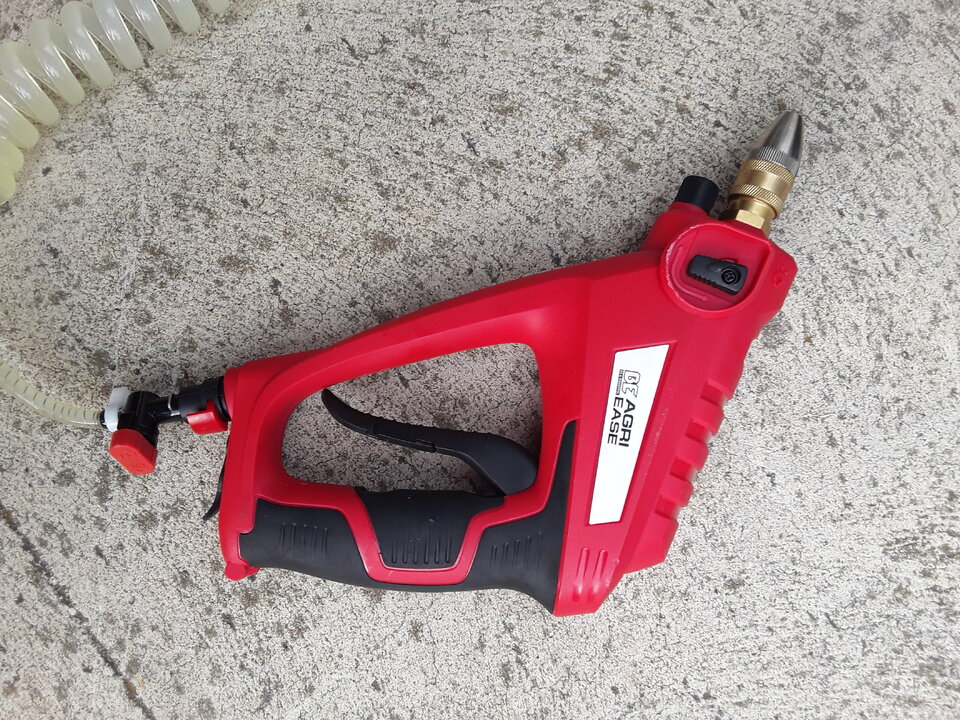

yeah, im not too impressed with the jet on it, s I'll see how I can switch it to a v jetCool, are you using the wand and jet that came with it or swapping it out for longer hose and tee or vee jet?

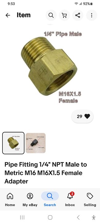

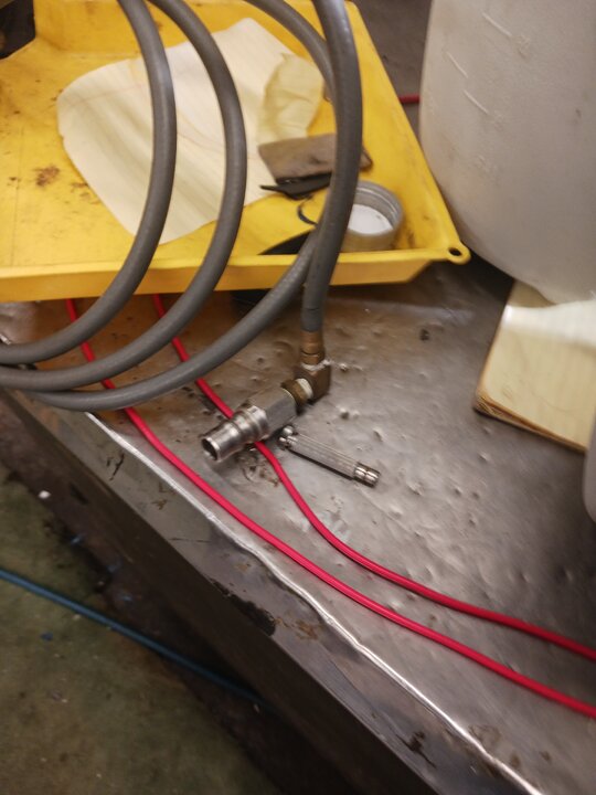

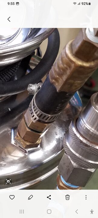

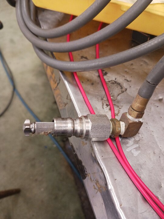

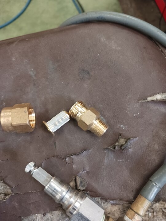

Im sure you can do it with the right adapters. Youll need a metric &sae thread pitch guage to find out what you're adapting from and to for me it was a couple of brass adapters and the hose and gunjet off my hydroforce sprayer and I was done( the ebay adapter pics were from 2 different things i adapted. But sent to.give ya the idea)(i used the hose barb one on my sprayer)yeah, im not too impressed with the jet on it, s I'll see how I can switch it to a v jet
