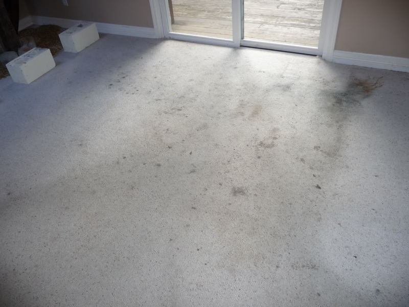

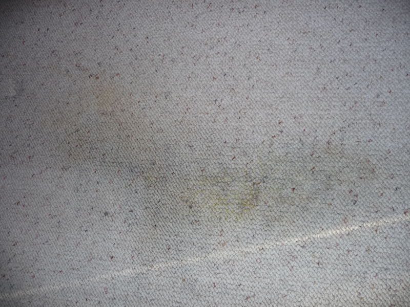

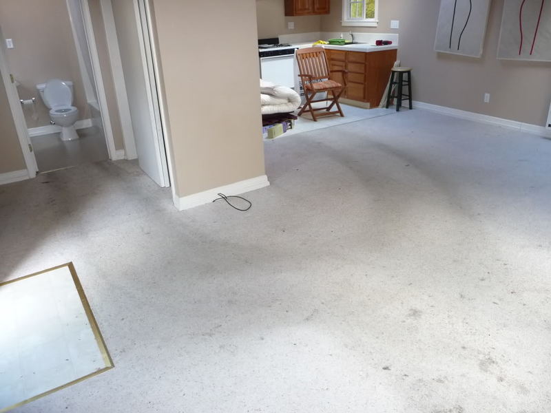

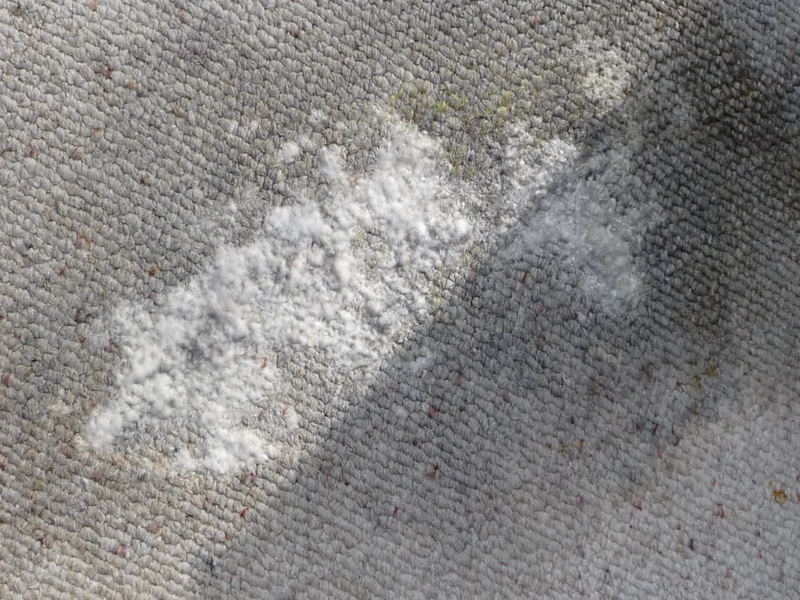

empty rental, nylon Berber.
Wheelchair bound occupant.

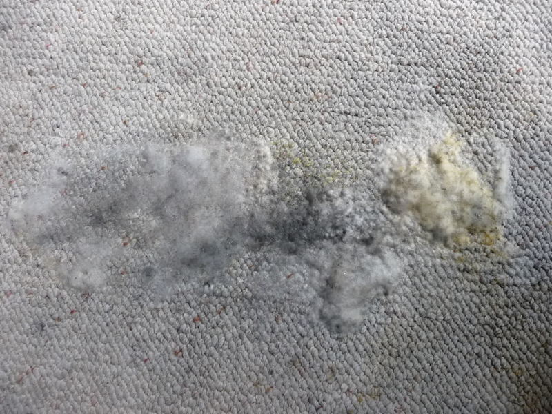

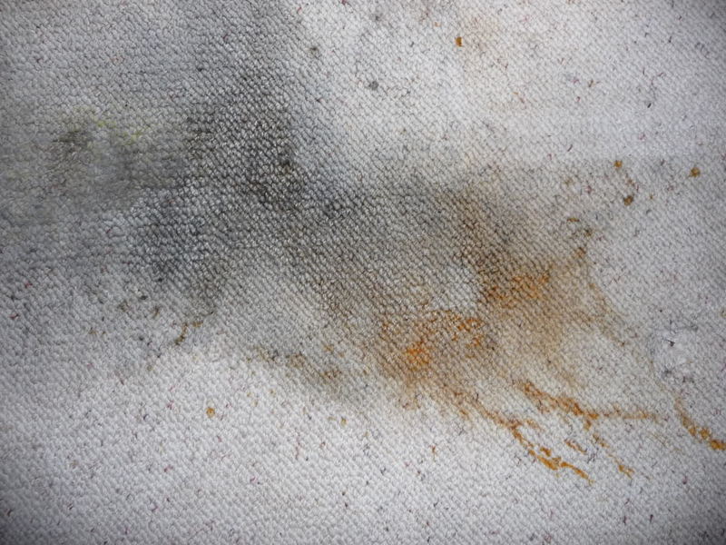

god only knows what caused this stain
laid the 40 vol down thick and the protein in the rug came alive
and ten died..
Used quadruple strength 02, hot sauce, Purple Engine Degreaser, 40 vol, ammonia and a tan pad and was quickly reminded that some carpet just needs to be replaced. Cant imagine what the backing looked like.
I left some 40 and ammonia behind to let it work but I think it's toast or needs a stripper.
blech.

Only ever got the racetrack marks out 95% One time, OP and engine degreaser, the rest was friction burn in the ole berber. I suspect the same here.

did you try rust remover ?

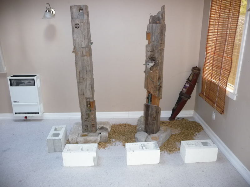

i dono about them their big sticks but the cinder blocks around it add a level of sophistication too bad I don’t live close I’d a stopped by with a good vintage of wine in a box

poor guy............when you gotta take a shit.....must have been poking out

We pulled some carpet back like that 2 months ago; replaced the molded pad and cleaned bottom; cleaned top 3 times and came out great. Hit bottom with 40 vol and o2 also; then clean top again after applying some rust remover.

WTF? :shock:
Stone Henge??
Freakin Aptos Vegan Hippies. :wink:

Either the worlds, largest flea circus of they have mouse/ very small pets that run around these towers.. See the small steps to get to the top and then around they go.

I was thinking Ferret or maybe a bird.
what is it Mikey?
