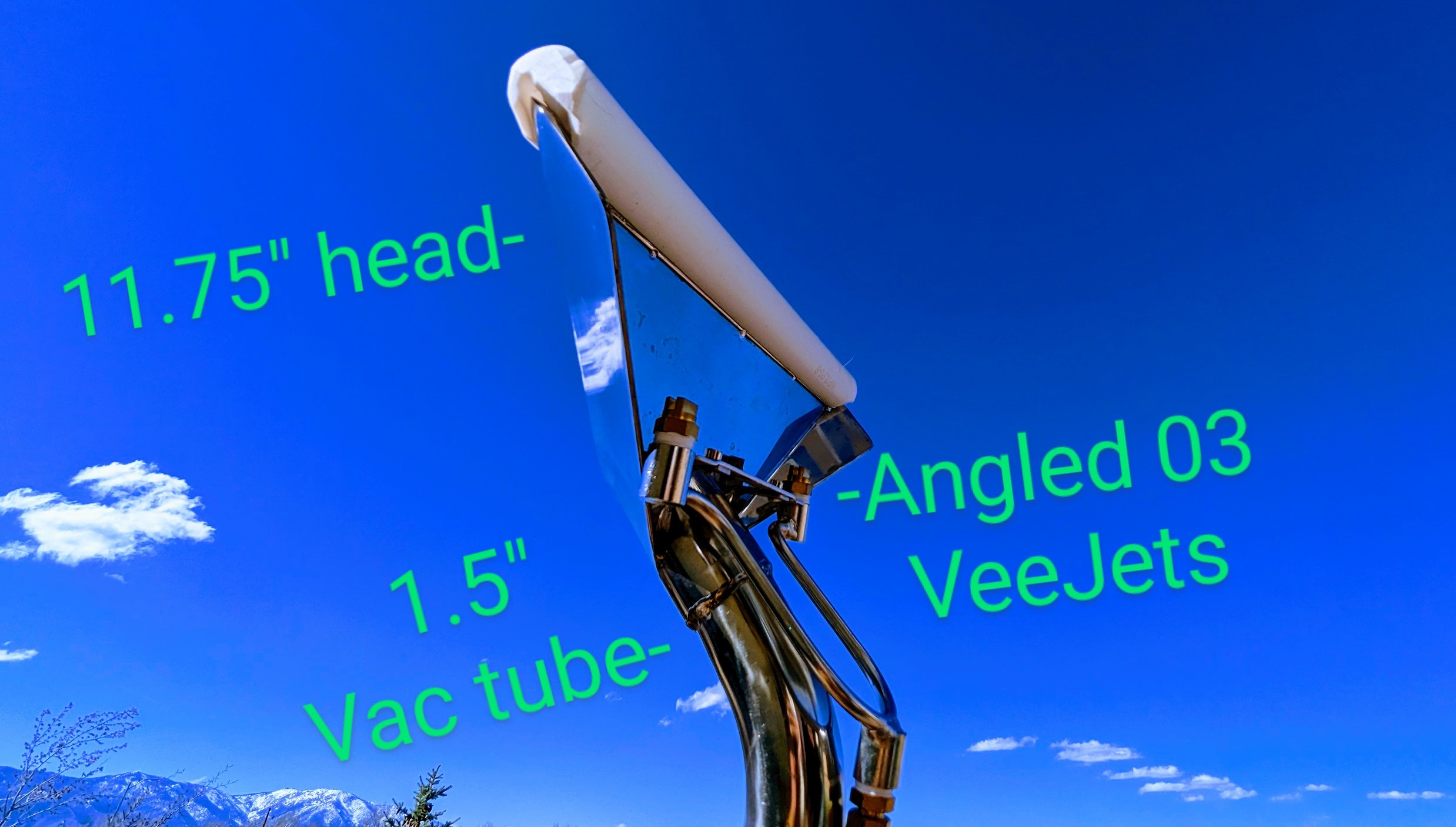

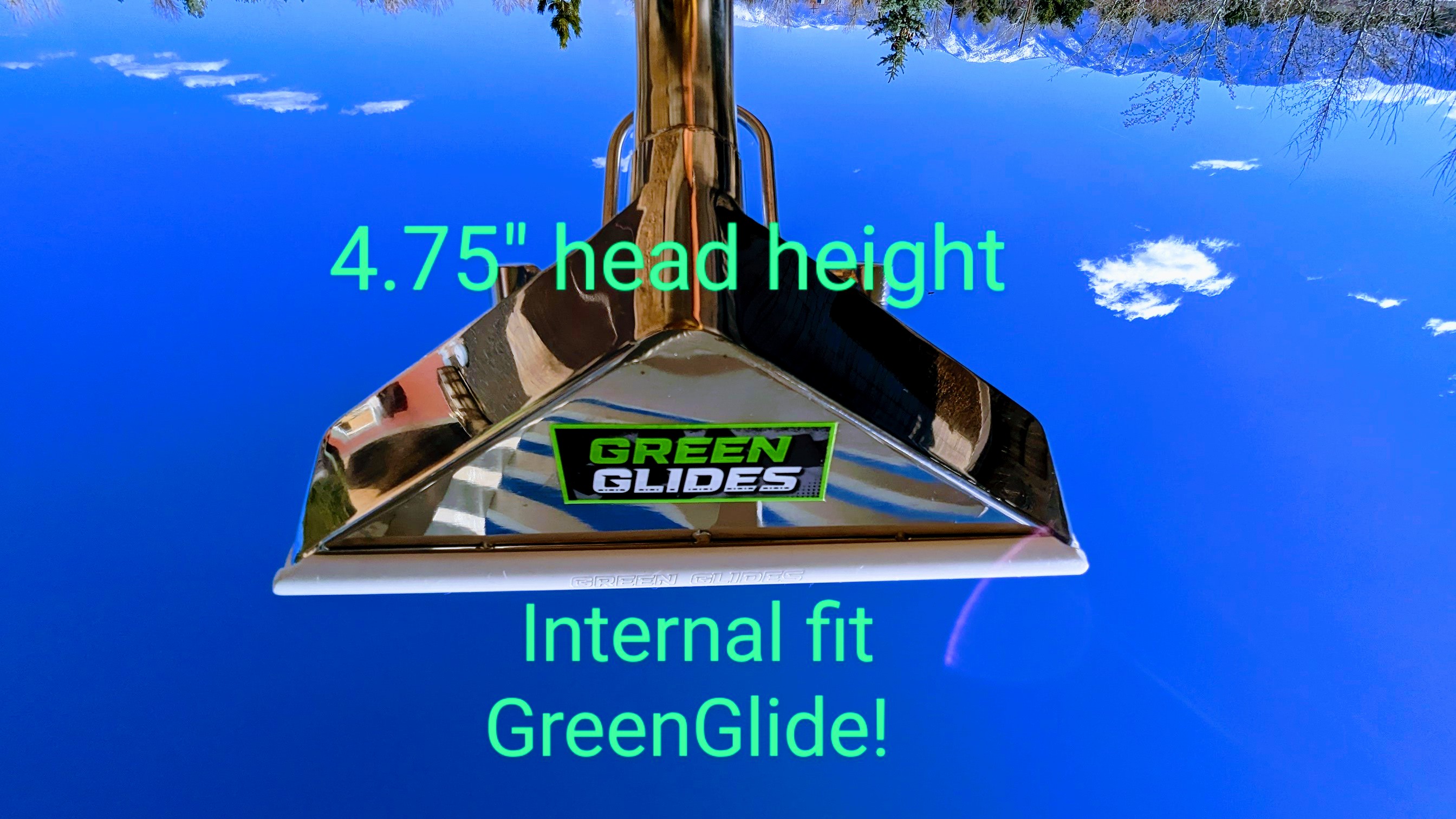

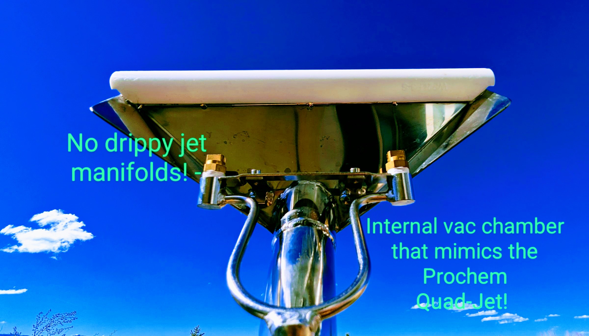

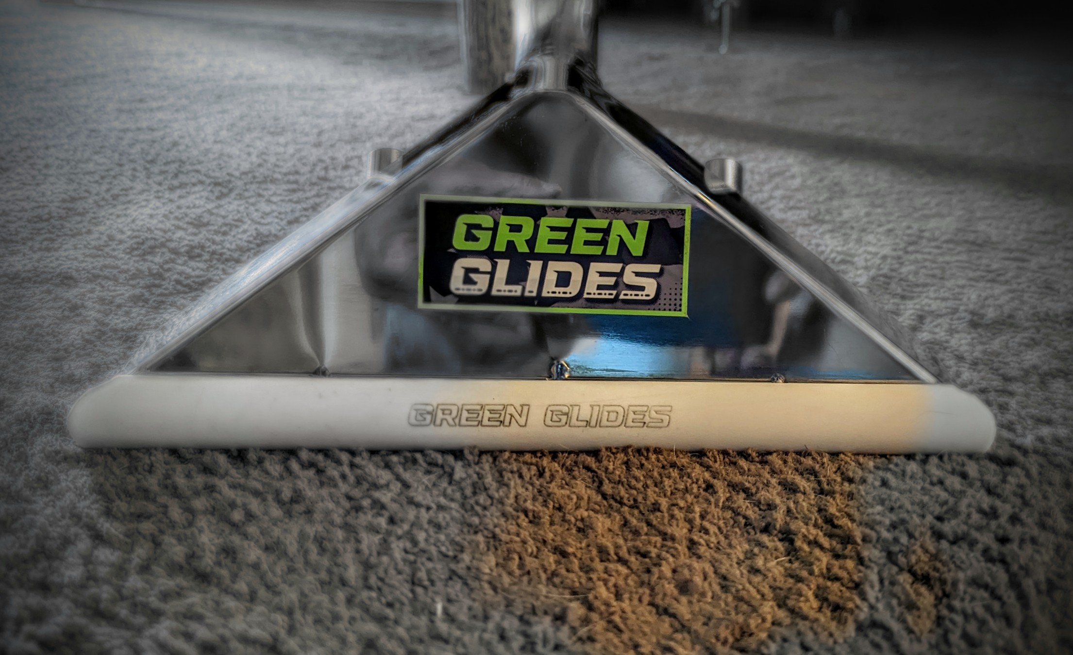

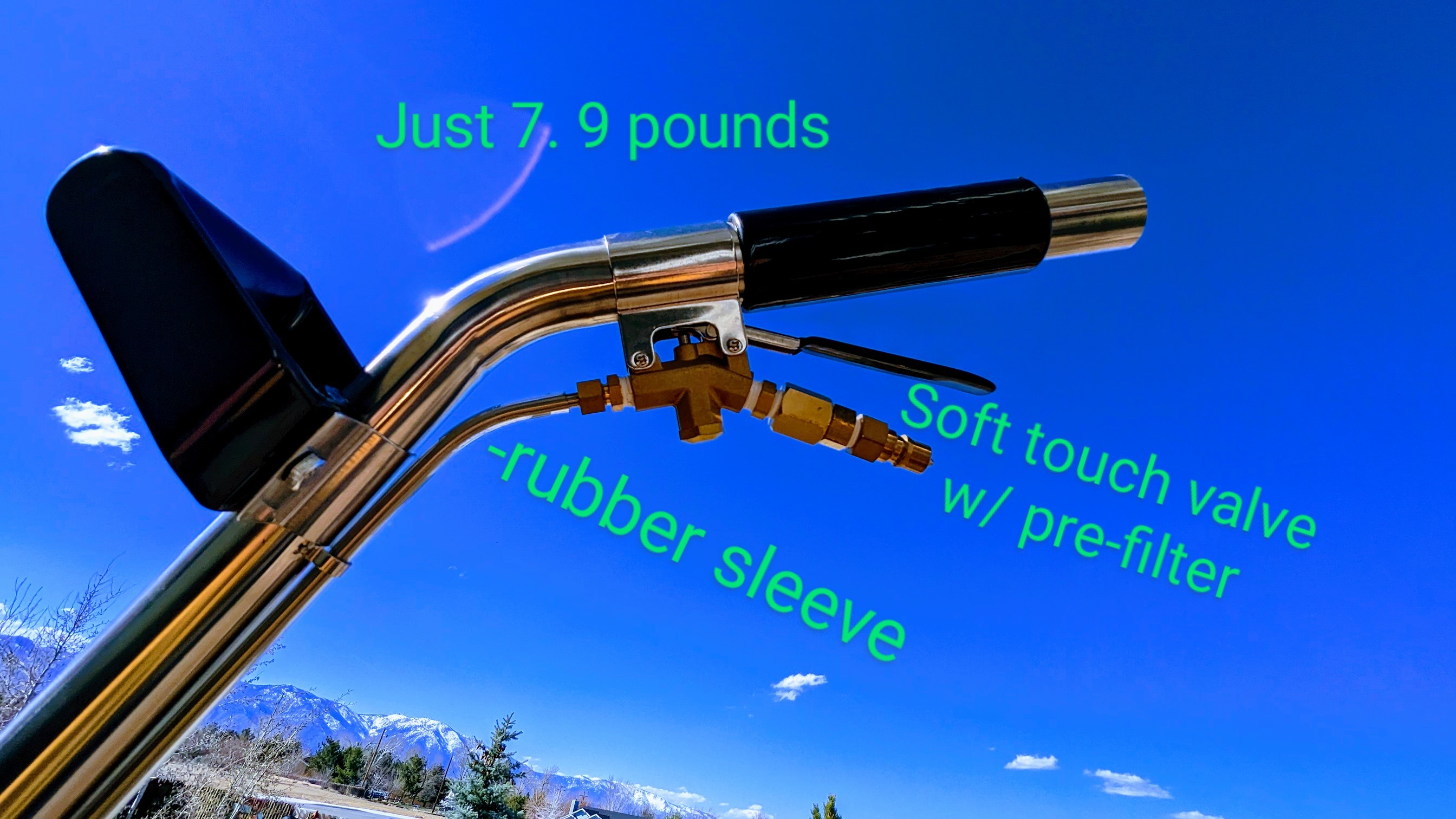

I can't wait to go clean carpet tomorrow with my new wand!
116,114
Westpak 530..
PXL_20230410_231451701~3.jpgPXL_20230410_231334384~2.jpgPXL_20230410_231351817~2.jpgPXL_20230410_231343536~3.jpgPXL_20230410_230757289~2.jpg

Why do you prefer 2 jets?
Seems like there’s be a sizable recovery difference between those wands.
Because he has a tiny tm that needs no more than 6flow. So two 3flow jets are better than 4 1.5 flow jets because 3flow jets won’t get clogged with debri

More impact with less water.
The internal VAC chamber design of this head is nearly identical to a SS12 and a PCQJ.
A triangular funnel.
But the chamber looks really thin. Seems like the higher performance wands have a more open chamber.
