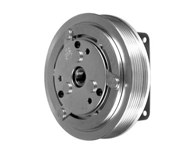

Well, my 1998 Lima Bean Special makes a screeching sound from the clutch pulley for the PTO that is mounted on the engine. To quiet it down I sprinkle a little Bar Keepers Friend on the pulley and that works for a day or two. I'm not going to keep sprinkling this stuff on there, I need to fix this. I'm not sure I got the correct part but I ordered a new electric clutch pulley from NAPA online Part #TEM 948435. It was $179. SteamBrite wanted double that. Anyway, I'm kinda guessing that this is the correct part. Can anyone help me out for sure? My van is a 1998 RamVan 2500 with a CDS 4.8 installed. @anon , @Pioneer Floorcare

My cleanco uses a Pitts clutch #14194 100 foot pounds
The trick with squeeking belts is when you change them is to use a small wire brush and brush the metal grooves in the pulleys to get out the rubber stuck in there.
In my case it isn’t the belt that is squeaking. Its the bearing in the pulley.

Yes they do, they hide the part number so you're forced to buy from them. But after some digging it looks to be a standard GM electric clutch that is used on their a/c systems. It looks like what is mounted on the engine of my Dodge.

You guys really aren't mechanical are you? Do you ever add graphite to a squeaky door? Are you familiar with how a bearing works?
This is how I "Fix" the squeak. I fold a small piece of paper in half. I then pour a couple of ounces of Bar Keepers into the fold. I then line the paper up with the crack of the pulley and flick it into the bearing. It stops the queek for about a day. I guess the previous owner did this all the time but for me it's not an option. I want it fixed. I'm replacing the pulley. The problem isn't the belt slipping, it's a bearing. Replacing belts (Which I already did) and cleaning pulleys isn't going to fix this.

Sorry If I seemed a bit snippy there. I've had my head under the hood for hours trying to isolate the noise and narrowed it down to the bearing. Already replaced the belt. Not the belt or Pulleys. Hopefully it's an easy fix. It looks pretty simple to remove the clutch pulley. I've got both vans booked out with jobs for the next three weeks solid so I need this fixed fast. IF I can't get it done, I guess I'll just keep giving it cocaine bumps ( Barkeepers friend)
