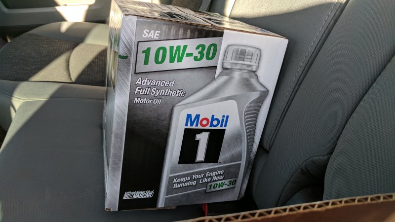

Royal Purple for the VATS
And this for the 370..
14,097
Where do you think I live?
It's the same weight as the 10w30. I've read that it stays on the cylinder walls better for the cold cranks, which is the time when the engine suffers wear the most. Does the manual say to use 10w30 on the west coast?
