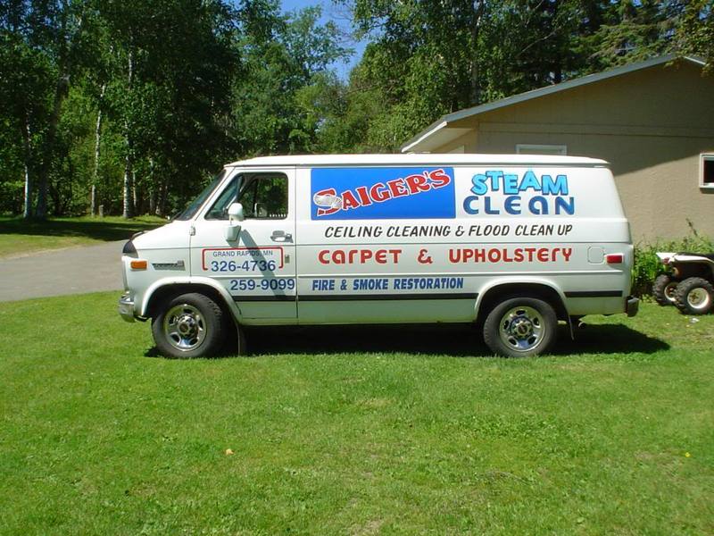

Here's a pic of the old girl when I purchased it from the family to just start cleaning part time again while I was still teaching. She has been such good unit for our family. Gonna be hard to see the day she is permanently retired :(
