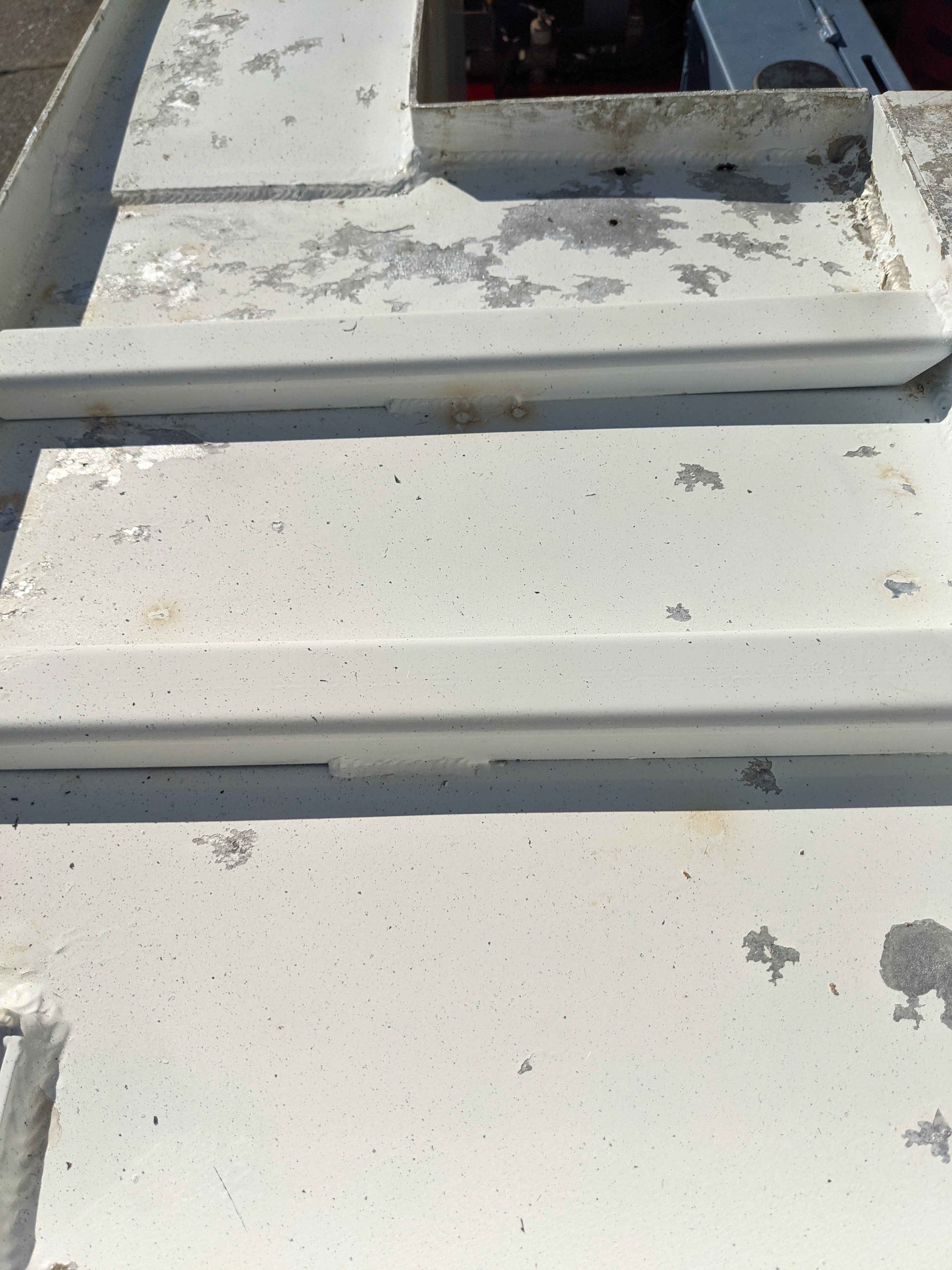

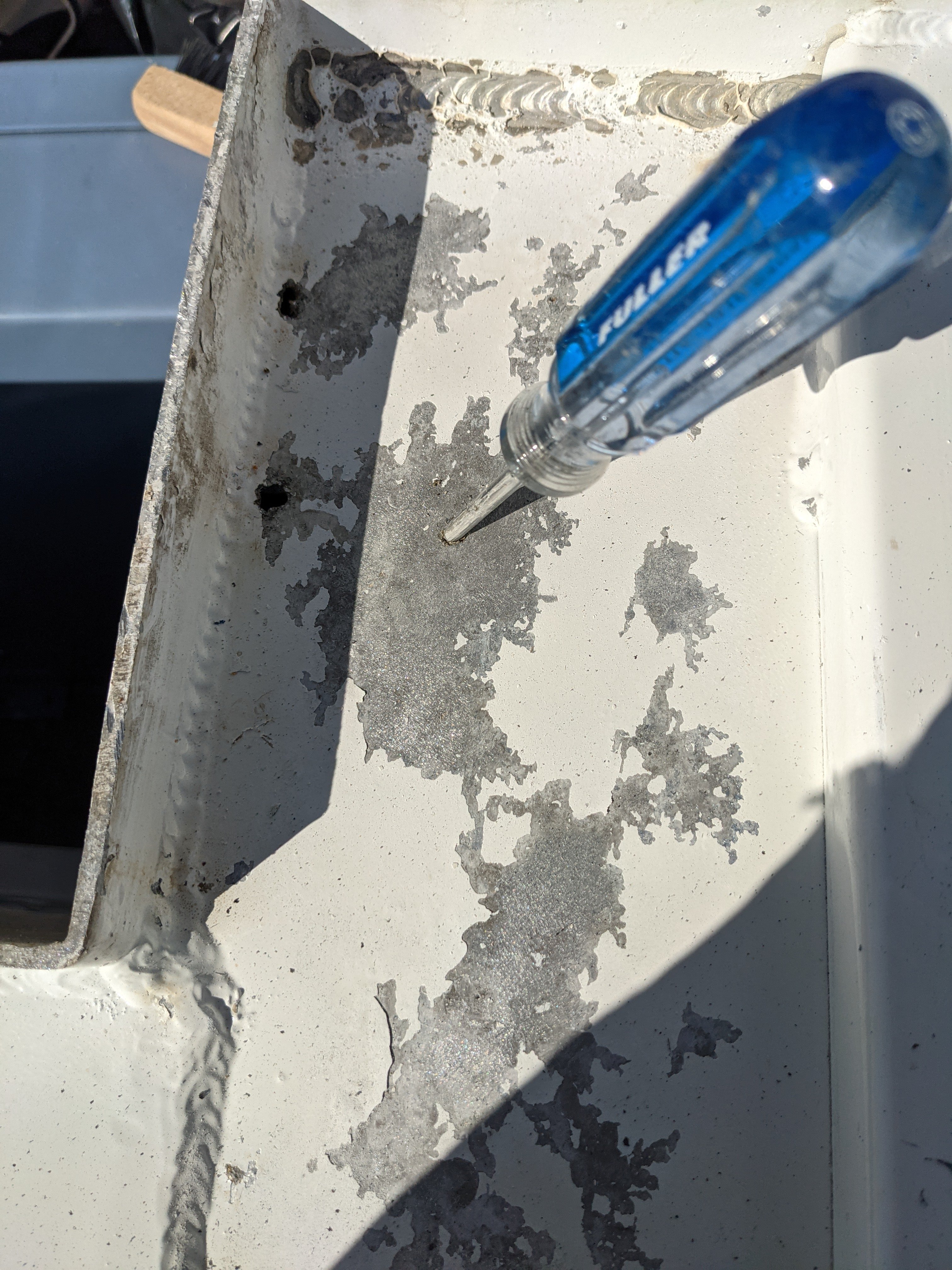

Finally pulled the waste tank from my Cleanco to inspect the leaks. Found major holes all along the bottom. Still undecided if it can be welded or if I can apply some sort of epoxy. Will have to be sand blasted first to see all the damage.

Considering an aluminum epoxy like Gluevit but the bottom is like Swiss cheese. Looking at a proper welded repair first. A couple of holes are larger than 1/4 inch.

This is going to take more than JB weld or small amounts of epoxy. The bottom and lower sides have multiple holes and many pits that will become holes. Have to sand blast first to see the extent of the damage. Probably going to weld new aluminum to the bottom and plug and epoxy the sides.

my alloy tank had similar issues as yours, they tried welding new alloy but kept blowing through corroded areas
I ended up getting new ss tank fabricated instead

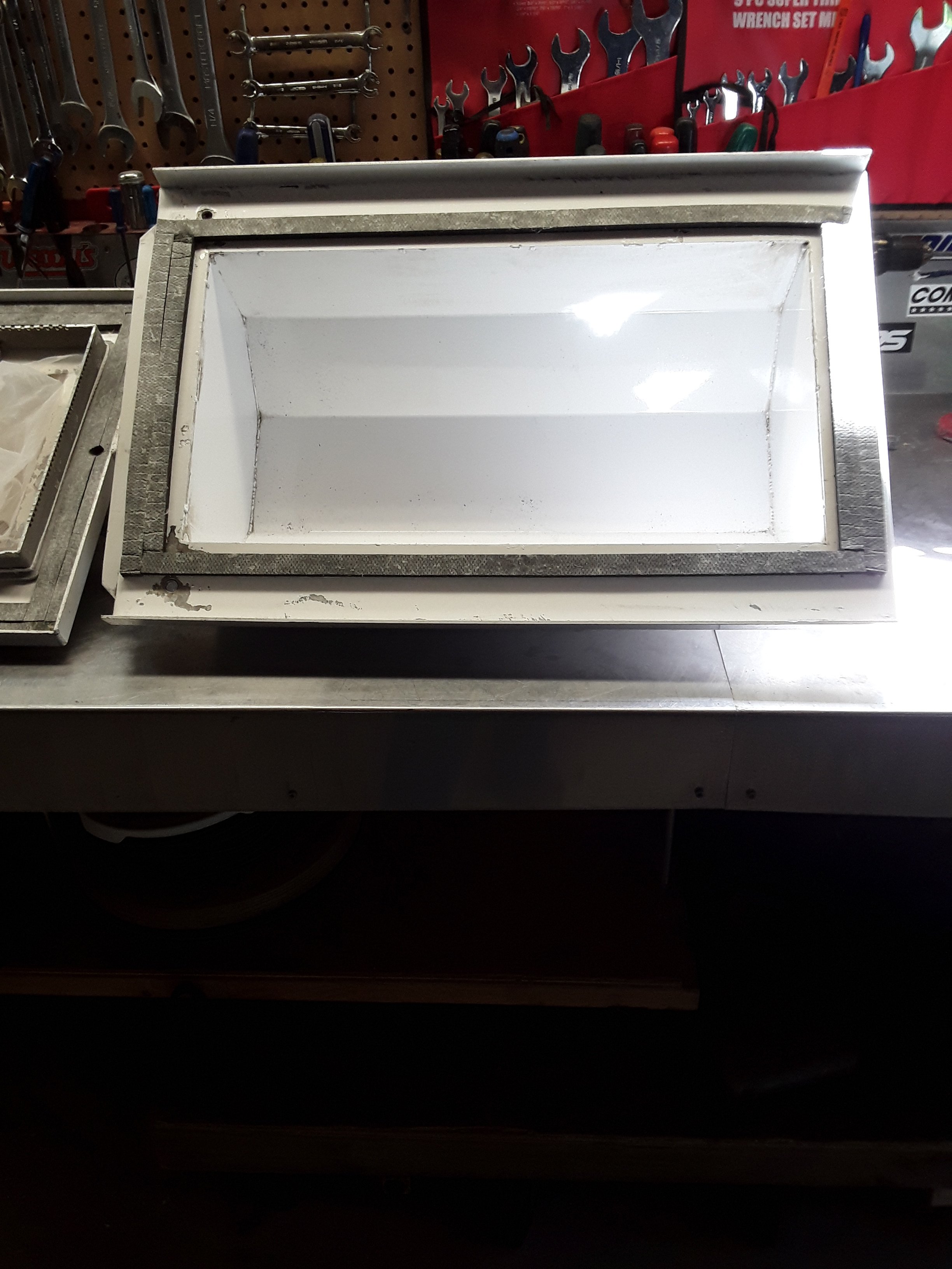

23 year old tank lid. Inside of vac tank still has white powder coating intact. I purchased a spare AquaTech unit out of BC, and after washing out the insides of the tank of greasy residue, was pleased to find an almost new condition vac tank.
The previous owner must have cleaned a lot of restaurants.

Once the metal is that far gone you need to replace. Sandblasting will probably leave gaping holes. I'd cut the bad metal away so it isn't left as lint catcher at the bottom of your newly repaired tank.
PS: Common fix is to weld a tank lid to the bottom of the tank.
