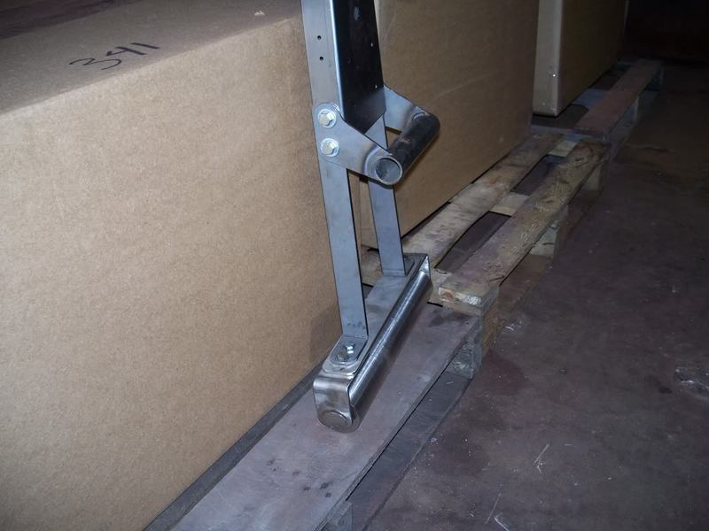

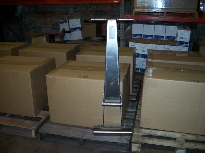

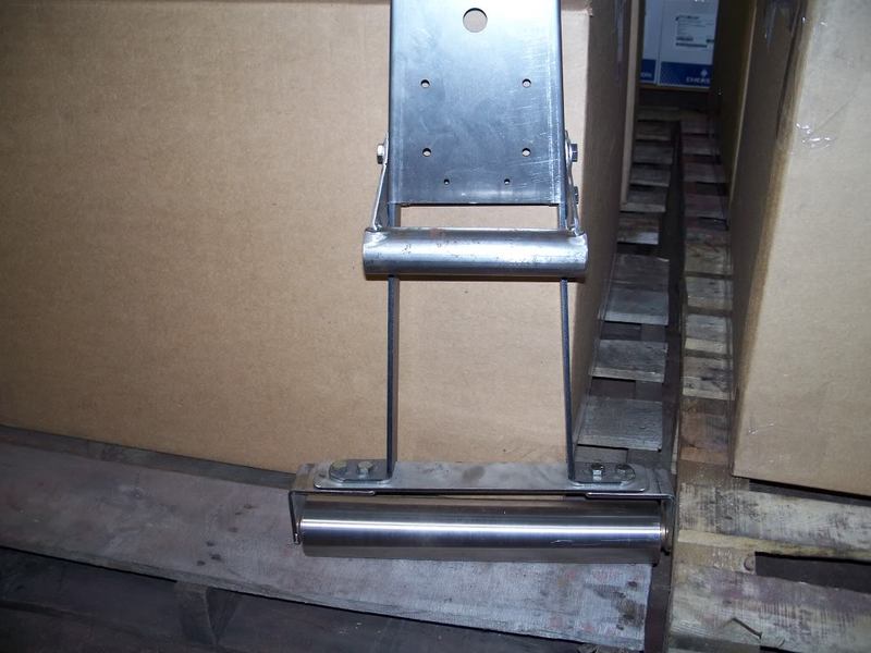

I'm not sure it's tall enought for you. I may need longer struts. Solid stainless steel roller, SS lower bracket, and the top will be powder coated red or forrest green. So what do you think Mr Mikey? Having all the handle parts makes it easy to produce fast. I will cover the switch hole with a plate.

I would think that it would be cumbersome to roll out pizza dough.
Thats my opinion but its honest.

Hello Larry, It is 35 pounds. The roller is solid 316 SS CR and lower bracket is 304 SS plate. The upper I would like to go with a telescoping tube for a long reach. It would help with storage as well. The handle I have on it works well. By the way this is a Rug Pit Roller Squeegee. It is in production now.

If that is a standard pallet the handle only looks to be one foot off the ground. :!:
If you are making it for Mikey does he not have any hair on his knuckles :?:

I really like the idea Clark..BUT If I was making it I’d ditch the stainless handle go with a broom handle fitting and make the roller 2ft wide. I know the idea is to give it weight but run that thing repeadly over 2-3 9x12 rugs and you’ll know what I mean.
I have the master blend roller it’s a nice tool yet ergonomically unfriendly and too narrow to be useful so it sits and collects dust.

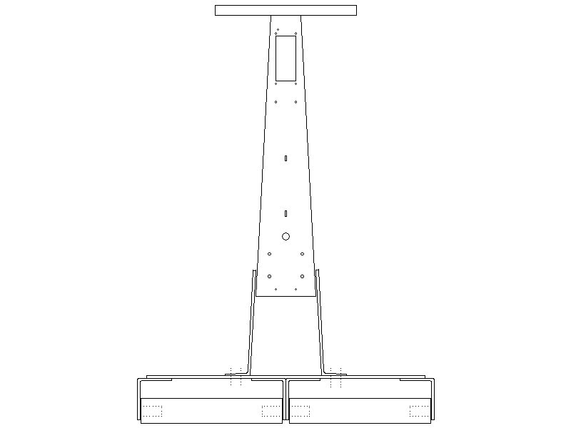

There are two models. One 14 inches wide (shown) and one 28 inches with 2 14 inch rollers. What about the handle would make it easy to use? And the MasterBlend unit has plastic rollers. The lower handle is to pick up the unit and carry it.
