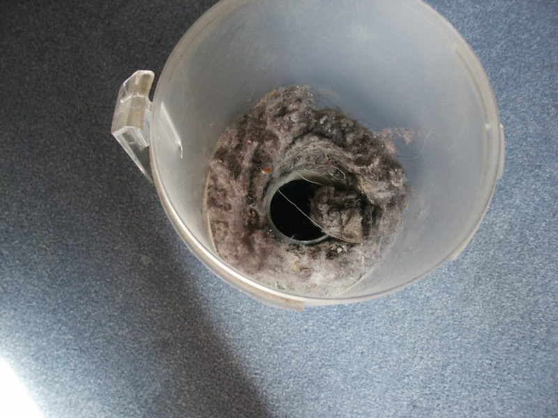

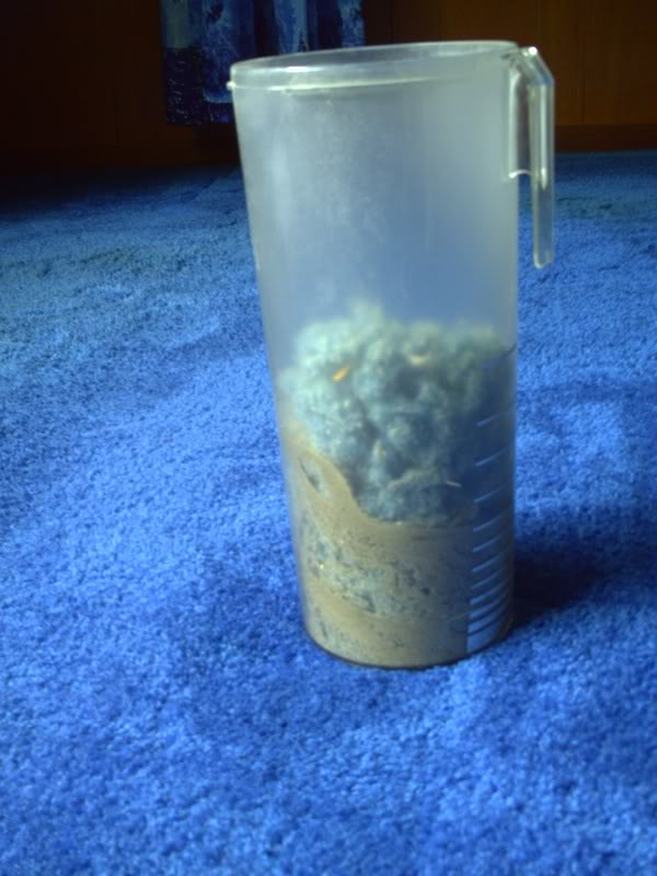

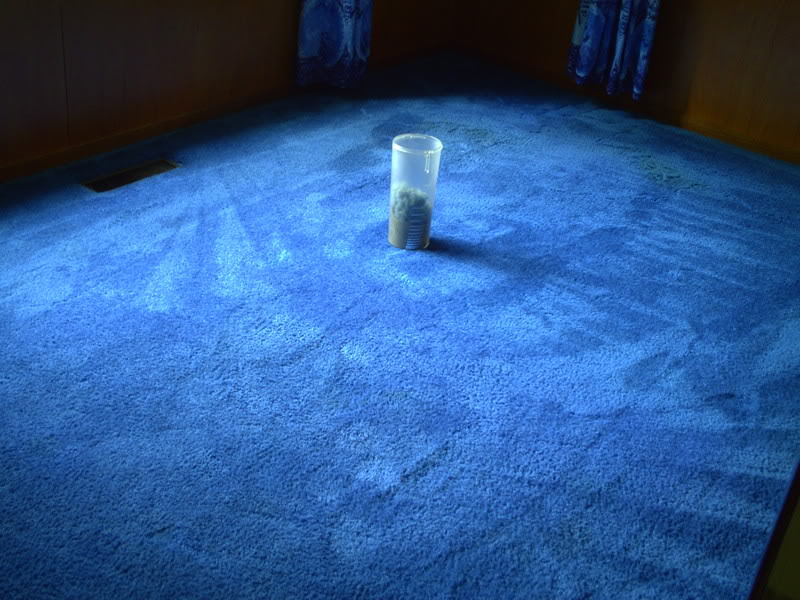

Cleaning this one room. Looked like it had already been vacuumed.
Look what came out!!
Had I been using a bag vacuum I would have left over half of it in the carpet.
What's your vacuum leaving behind??

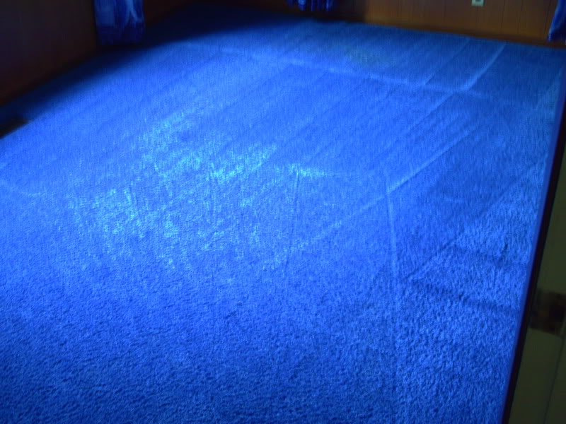

After cleaning

took maybe an extra 10 minutes in that room, NOT 2 hours. (Sheesh, show one extreme and they think I vacuum that long on "every" job. :roll:
I'd rather spend an extra 10 minutes than make mud. I don't care if you have a 1208 blower, once its wet, it takes a lot more effort to flush it out, if at all. If you don't know what came out of the carpet, you have NO idea what you left behind. You THINK you got it clean because it LOOKS clean. Sounds no better than the OP story.
Custy's either don't have a good enough vacuum, don't want to vacuum, don't have the time or just don't know how. I'm hired to
in effect get the soil they can't.

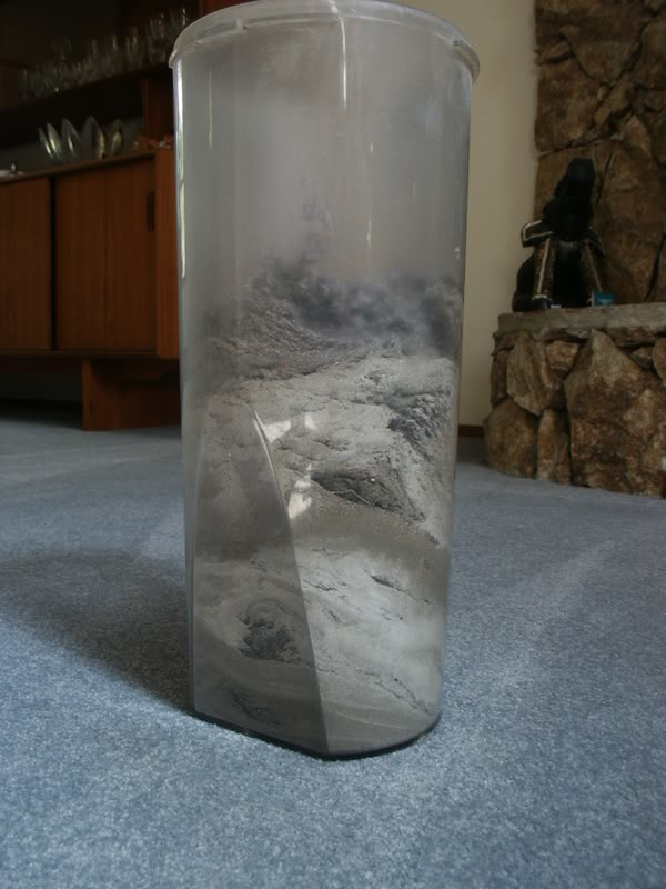

Couple more examples. Not just lint in this load. Its carpet deodourizing powder and sand. If you can't see it coming in the vacuum, you would miss this stuff entirely.
The carpet "looked" well vacuumed before I arrived. Still got this much out.
You definitely won't flush it, it ain't coming out wet!
SOme deod pwdr has chlorine in it. One local cleaner got stung because his prespray reacted with the pwdr and created bleach, stripped the dye off the carpet. NAsty!
