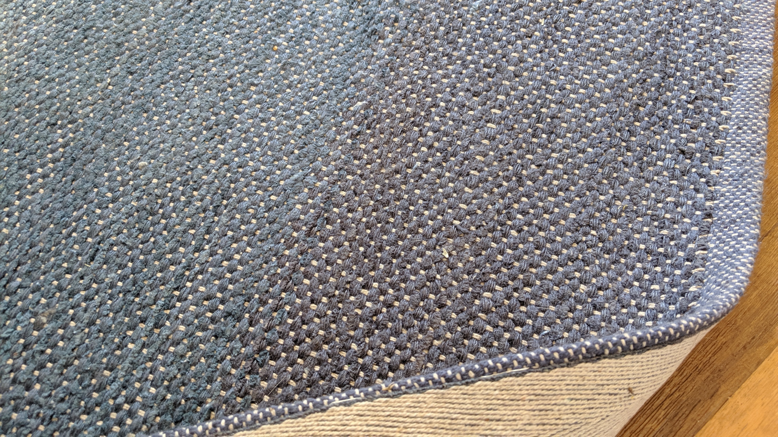

Today's hard surface floor converts are covering their floors with crappy rugs like this, not the beautiful "oriental" rugs of yesteryear.
At least that one didn't have viscose/rayon/tencel/banana silk/art silk/whatever else they call garbage fiber rugs.

If you just look at that edge tape wrong, it will delam....
I HATE rugs like those. People ask me to clean them when they are full of urine, I simply say, yes, I can clean them, but I’m expecting them to fall apart....
They look at me puzzled, I flip the corner up, grab a piece of the tape, and gently pull, and yup, it comes off as easy as scotch tape off the roll...
Junk.

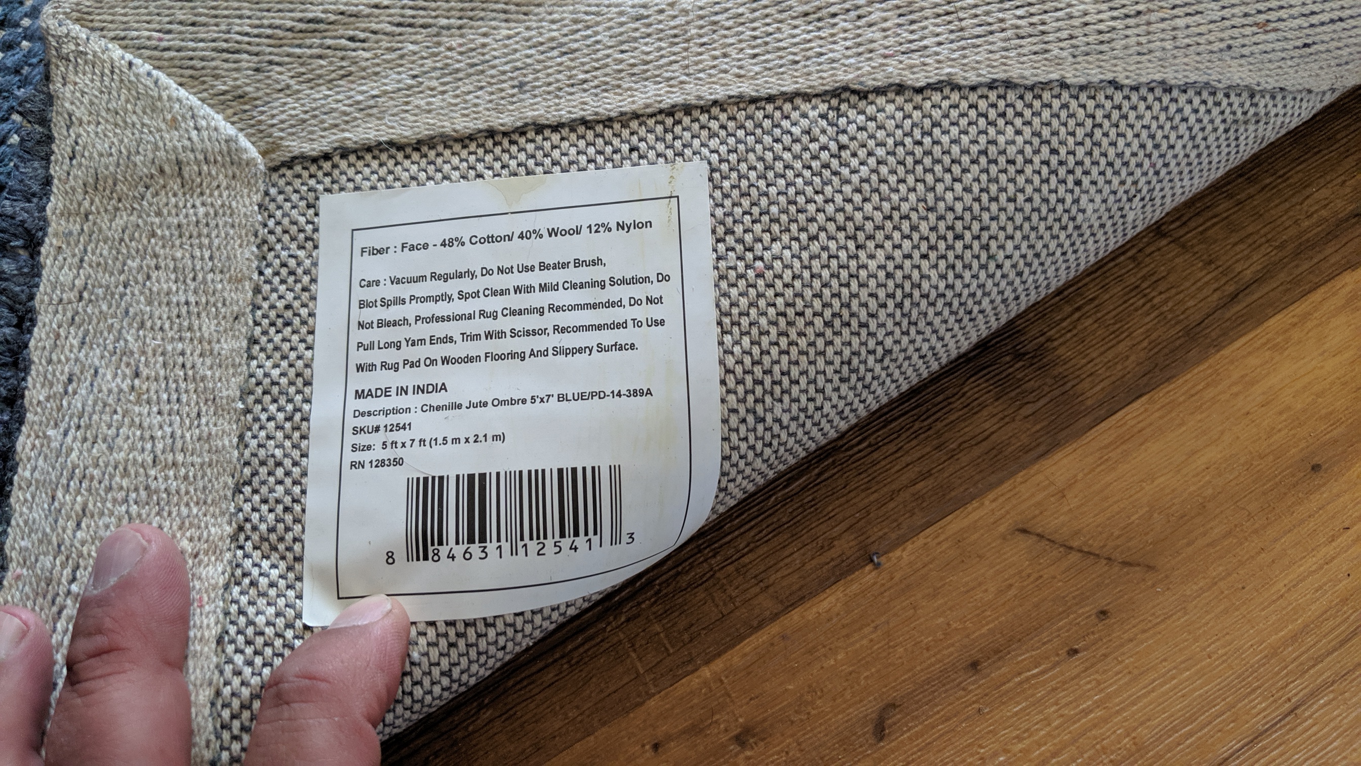

All Indian hand-tufted rug will have poor adhesive that turns to putty when wet. Thin rugs of this type, particularly ones with a high cotton or rayon face fiber, will wick the adhesive to the surface. The yellow discoloration takes an enormous amount of time to remove, so it's better to skip cleaning them.
