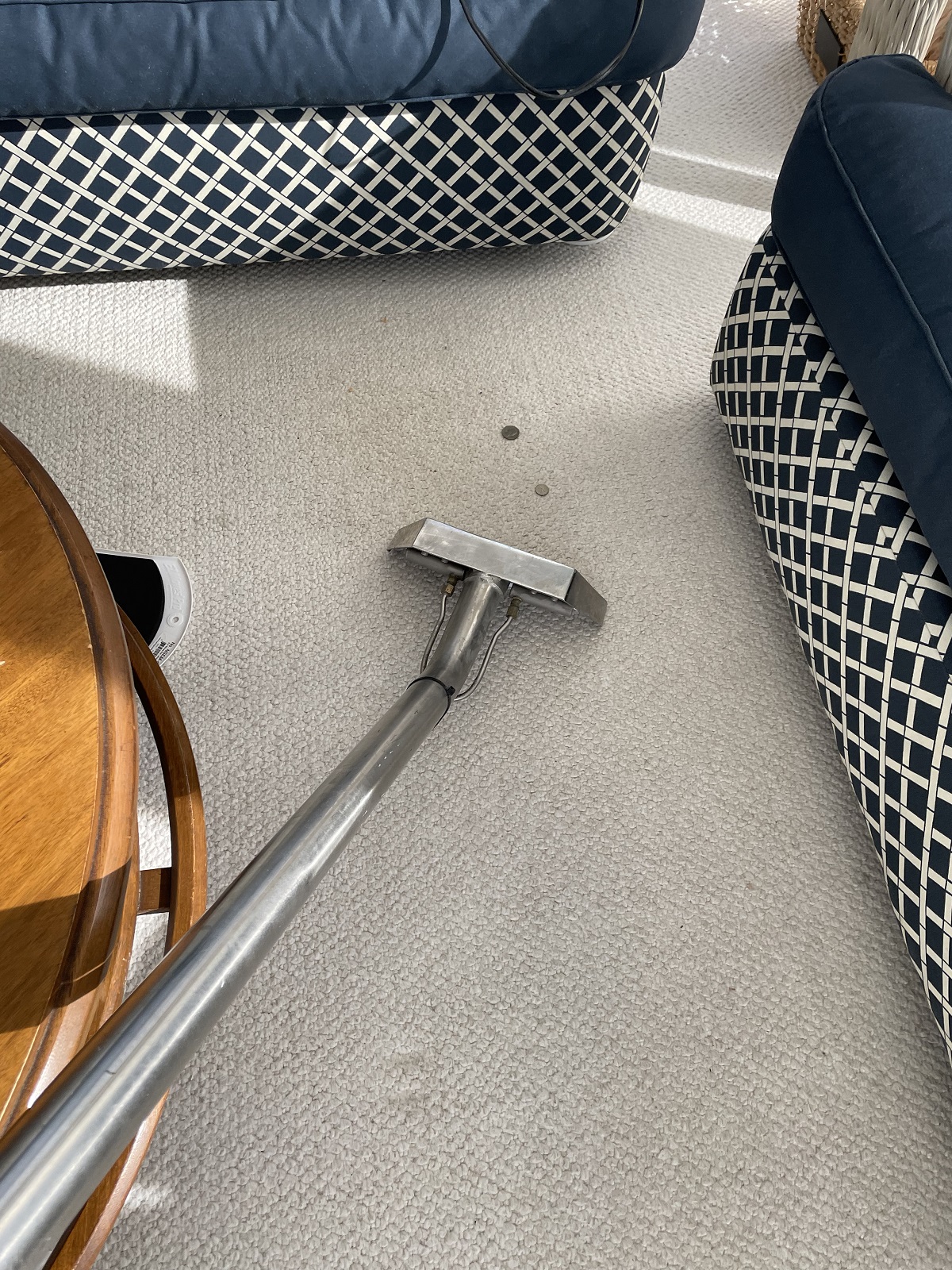

Cleaned over 800 sq ft of old cut pile carpet that usually fights back, return customer of many many years. New lip glide had me smiling the whole job. Some old berber that would have a horrible sound like finger nails scratching a chalk board was not an issue with the glide as well. (Dry carpet in sunroom, old). This exceeded my expectation. I love the fact that you saw my post, had a custom glide that fit my needs for a particular wand, and got it to me, and it worked for me all within a few days. This opens up some doors for me now. Sucked up a dime then a quarter, no problem. First dresser I moved had all kinds of debris and I was able to vacuum up as well. Game changer. Thanks.

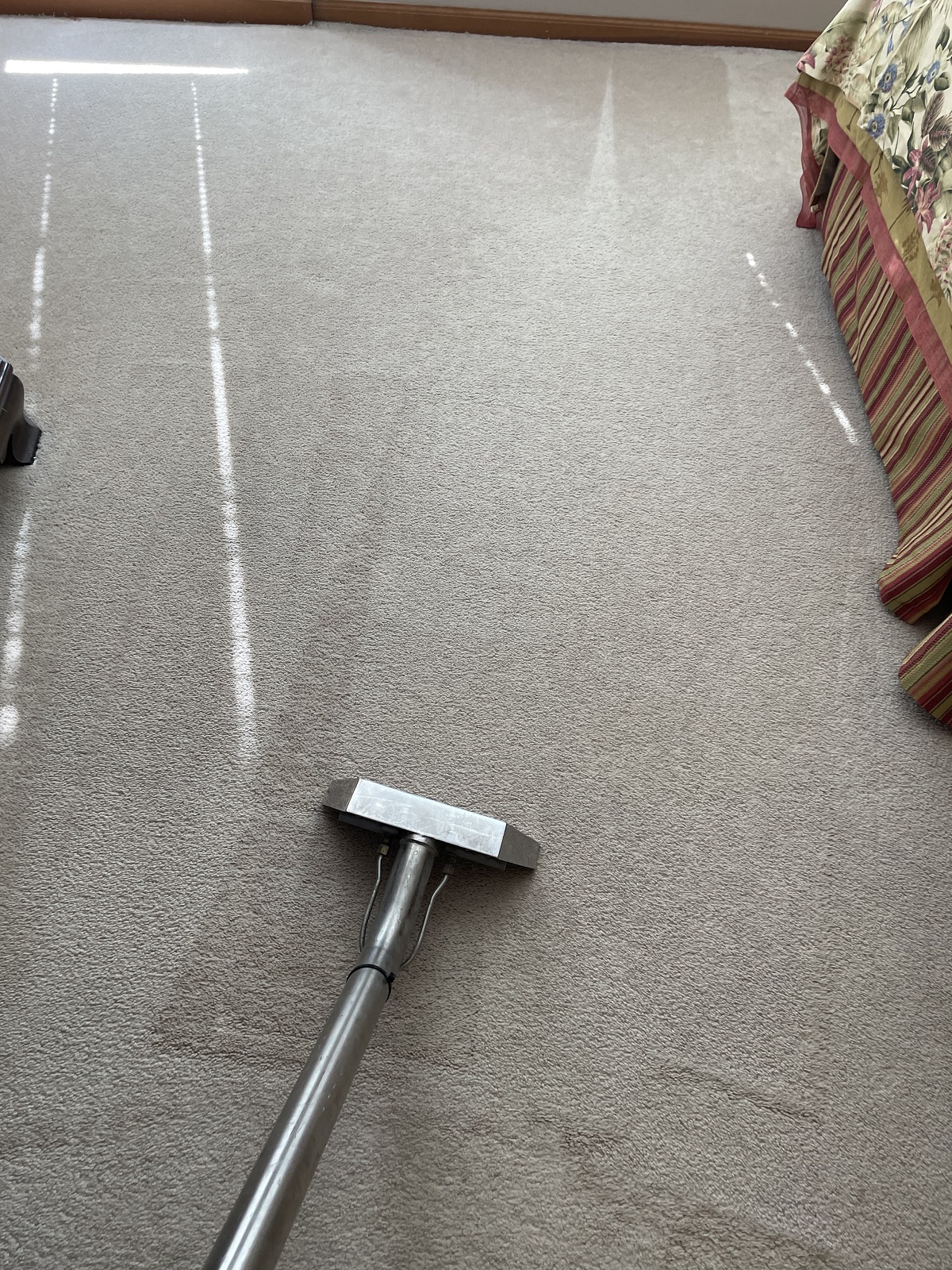

Another 2 jobs today I needed the glide. Timing couldn't have been better. This was about 450 sq ft of super resistant to the wand cut pile carpet, seriously would have destroyed my day. Came out real nice, almost didn't want to groom it. The effort was perfect. I like the way they are drying too. Ended up with a bonus job next door for a small rug. Used it there too. This is litteraly a game changer.

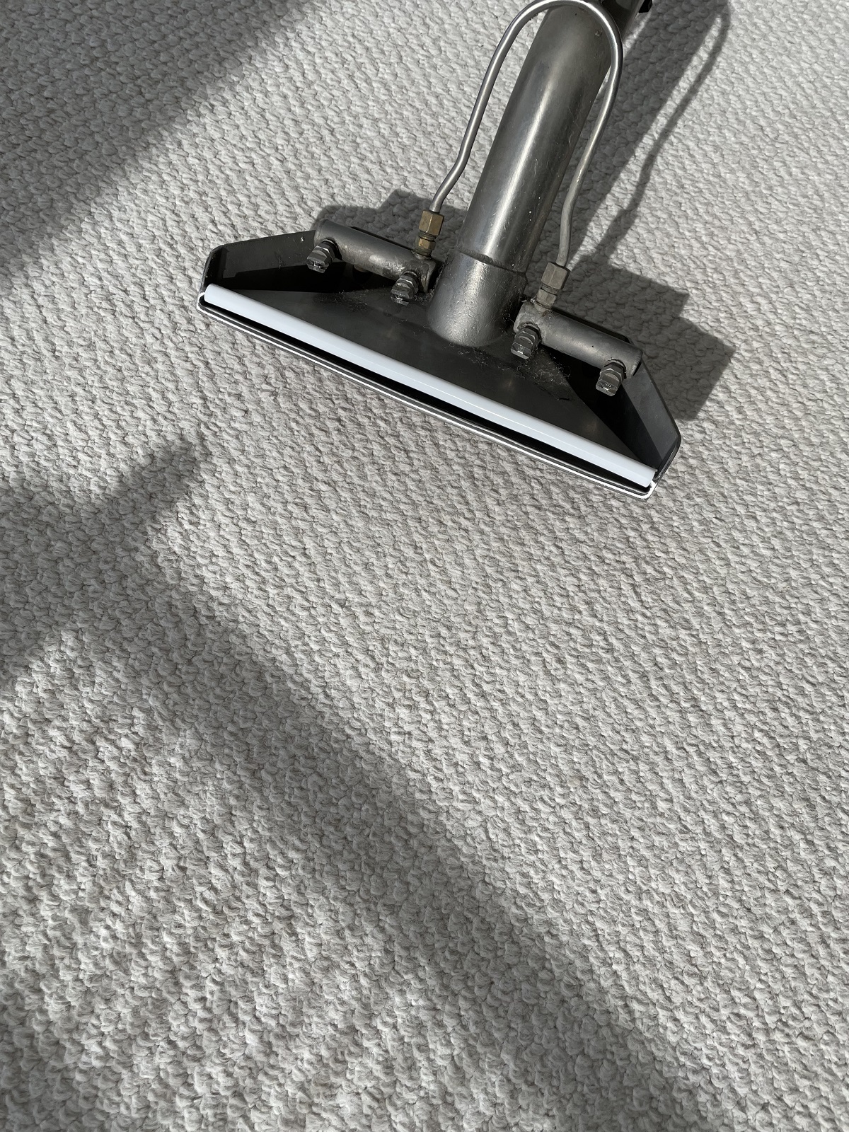

Such a game changer. Did miles of a historically back breaking carpet yesterday. This lip glide made it the perfect job. I would say I use it on at least 80 percent of jobs now. Better late than never
