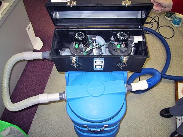

I just used the EDIC Galaxy 2000 (12 gallon) portable carpet extractor with the external heater to clean a really nasty rental house and it did an amazing job. One cord runs the extractor without the heater and one cord runs the heater. In the unlikely event of a heater failure, it is simple to remove and keep working. Lots of recovery power with the dual vacuums and plenty of cleaning power with the 500 psi adjustable pump. You can get this unit for under 3K!
If you need more capacity, the Galaxy Pro is 17 gallon with the same external heating system, vacs and pump.
These portable extractors are tough, top performers, well supported by the EDIC team and distributor network and have the a 5 year parts and labor warranty.
I have a video of some killer results with this unit if you would like to see it hit me up via email since I can't post a link here. nickrw@gmail.com
