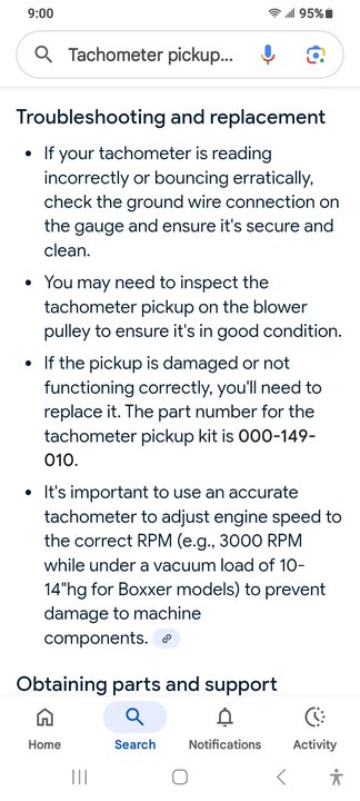

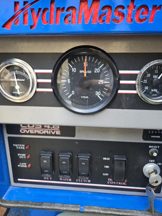

I found a broken ground wire early this morning and fixed it before we got on the road. The tm ran fine for our whole job this morning, whereas it has been getting worse all week. Hopefully that was the culprit! I am going to change the engine oil and clean the MAF sensor this evening, I just picked up some MAF sensor cleaner. I'll hold off on doing anything else until I see how it runs on Monday. I'd prefer to not throw any more time and parts at it right now. But I will if the problem persists.

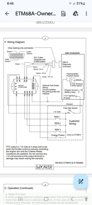

Interesting. Is your machine a pto style with a throttle controller? I'd of spent a lot of money this past month having things fixed if I didn't do it all myself. Parts alone were like $1500. I imagine the labor would have been much more. Learning as I go.
I discovered a broken ground wire to the throttle controller this morning and fixed it before we got on the road. The machine ran fine for a few hours this morning with zero interruptions, hopefully it is good for now. I'll see on Monday when we have our next jobs. If we get through each of them without a shut down then I'll consider it fixed 🙏. Maybe then I'll get at least a few weeks of solid use before the next trial 😄

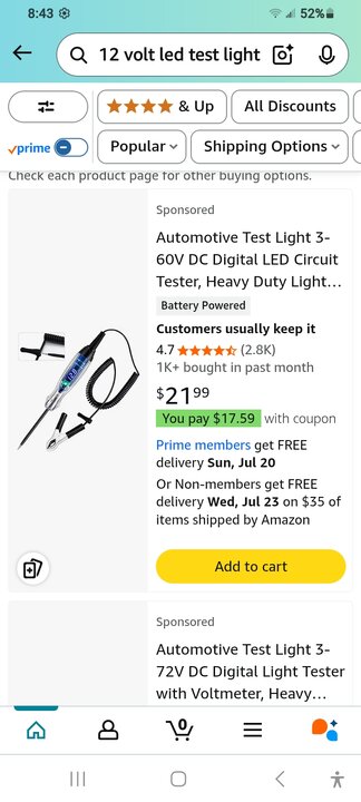

Do you have an engine analyzer? If so does it show live data? If not i recommend one of these blue drivers i have 3 (1 in each vehicle) their inexpensive because the expensive part of an analyzer is the computer and screen this uses the computing power and screen of your phone. you already own the expensive part. Anyway you need to see the live data for the o2 sensors on the lean bank you may not even have a vacuum leak. My 08 ranger had lean codes for bank 1 turned out to be catalytic converter
Thanks for the recommendation Dwain. I'll grab one of those. I'll be doing more and more of my own eepair work for now so it will certainly prove handy. I imagine the money and time it saves me in not throwing too many random parts at it will be more than worthwhile. Thanks man!
