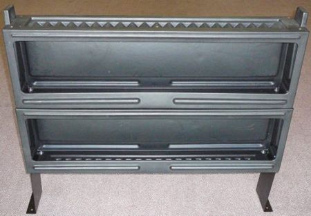

Thought I would post some pictures of the new tank riser. You'll notice it still has plenty of flat spots for mounting plumbing. It's also removable. This is now going to be coming standard with every tank.
nrpepper
Feb 7, 2007
73
Poway, CA
Nathan Pepper
Sorry,
I had to resize the picture to get it to fit, and now it's a little grainy. I'll try to get a cleaner one up tomorrow.
Thanks.
Scott Rogers
1,033
ok, looks good but is it too tall to fit over the wheel well in a ford or Chevy van?
In post above the said it will/does have that option to mount over the wheel well

John LaBarbera
Hi Scott,
The wheel well relief part of the mold is being built. It will be reversable, left or right hand.
John
Scott Rogers
1,033
Greenie said:
All tanks with wheel well reliefs affect capacity....silly rabbit.
Not if he compensates for it by going slightly longer,wider and/or taller :roll:

Greenie
6,820
The mold is already done. Notice the riser, it's an addon second mold piece. Adding the Releif for wheel well is already costing a bunch of money, i don't see John changing the size and dimensions of teh mold much at this point. In my opinion, it holds enough to offer a viable option to the market, I still think it's best served as a vacuum tank than a water tank, in fact you don't need or want the riser piece for water.
